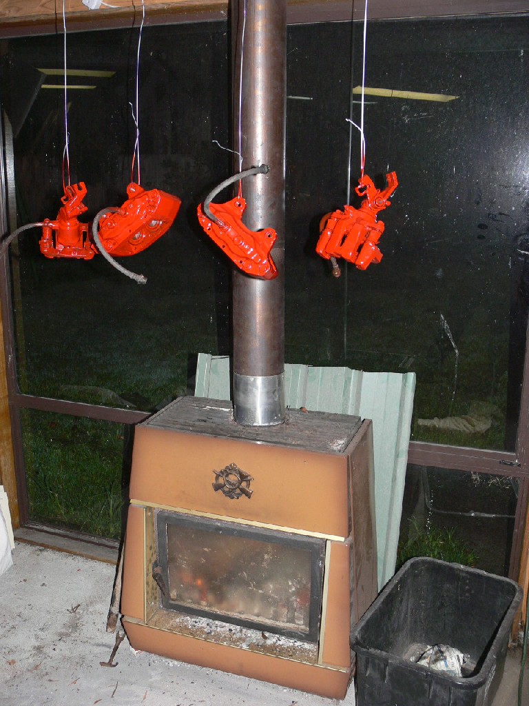

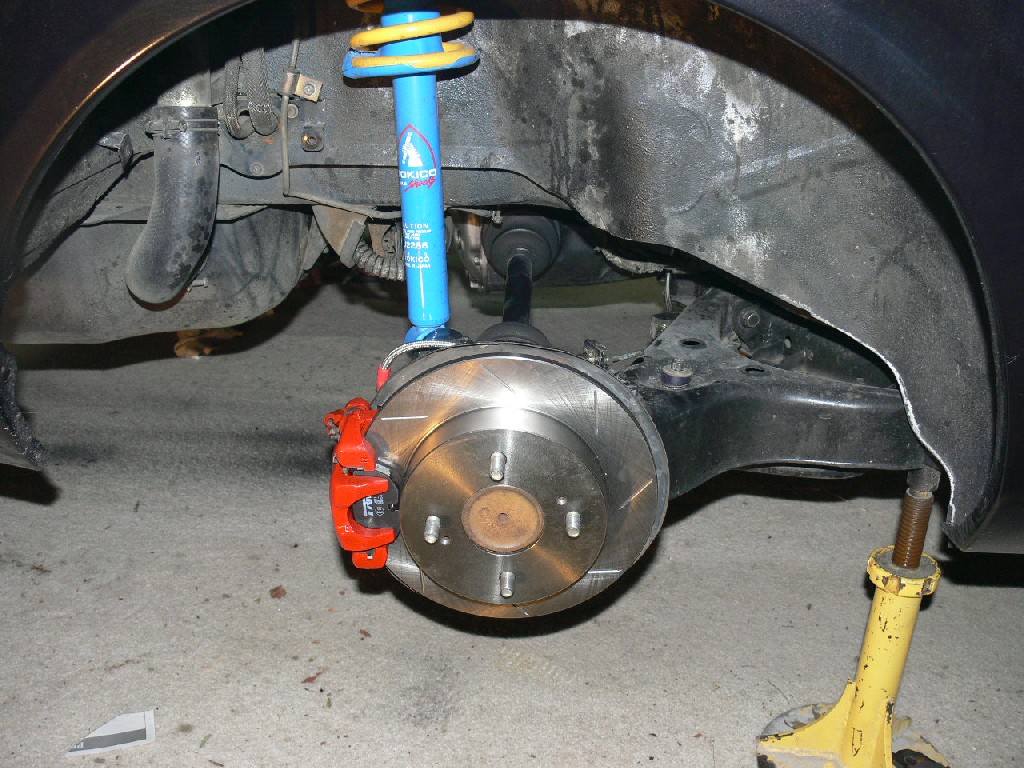

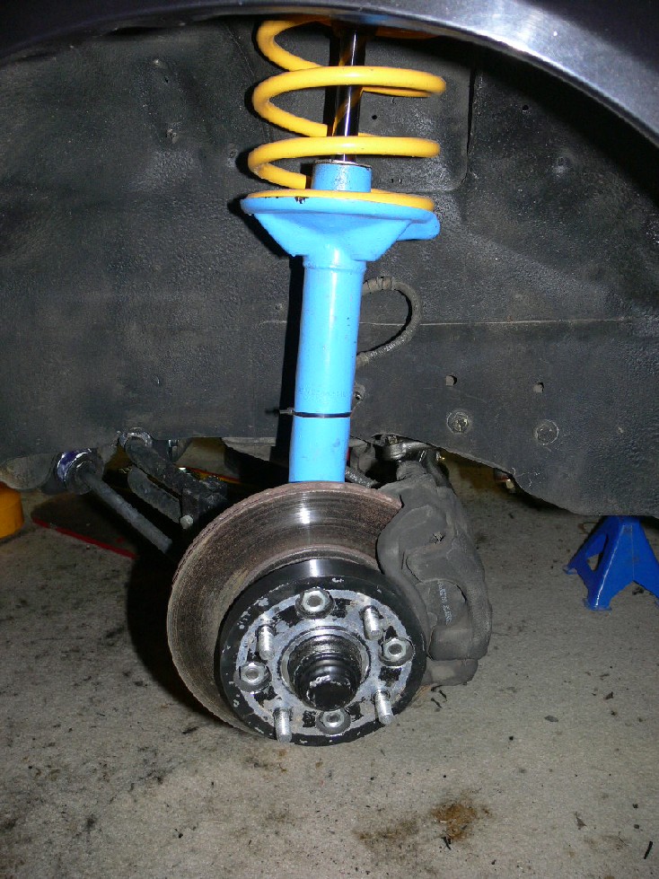

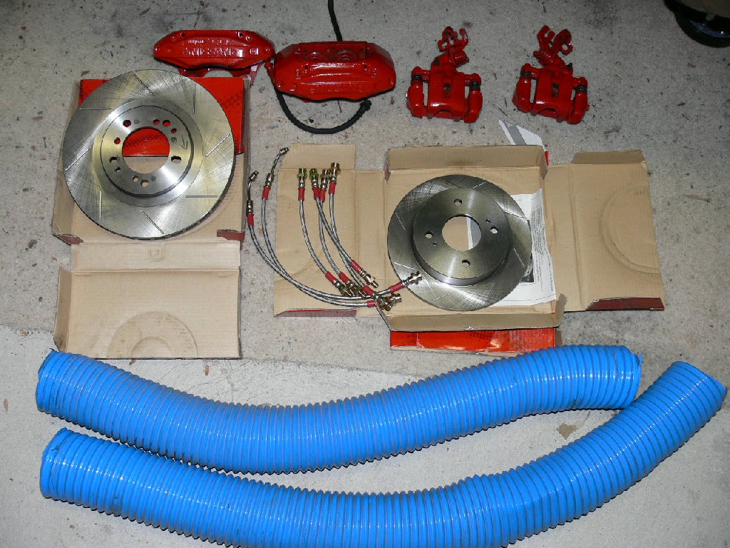

Here are some progress pics of my brake upgrade.
Starting from standard to hopefully finished soon.
Master cylinder already rebuilt and upgraded to 1" piston.
Fronts are Z32 300ZX 4 piston calipers
With 296 x 30mm slotted rotors, modifications needed as nothing off the shelf.
Custom brackets need to be made. The joys of being a toolmaker and having access to manual and CNC machines. ;D
Stainless steel braided lines.
Rears are standard series 2 280ZX with slotted rotors and all rubber hoses replaced with stainless steel braided lines.
If this doesn't give me more braking confidence..........nothing will.
First shot is standard brakes.

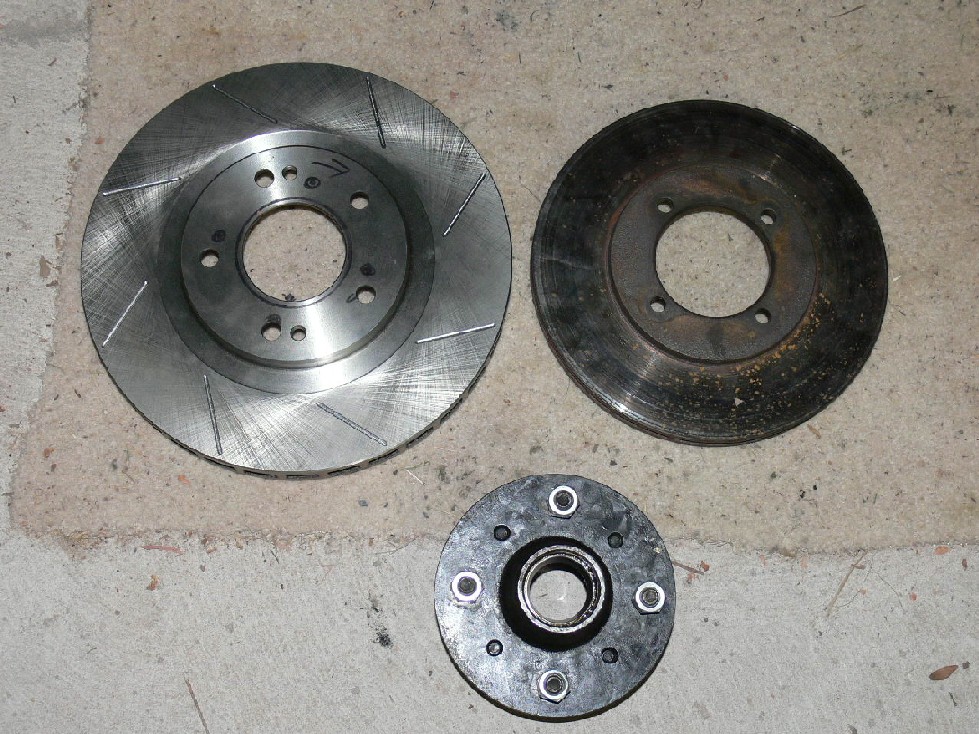

Second, rotor difference.
My oven bake painting facility, my wood heater is so ugly that I love it more for it.
Rear brakes should be here, forgot to take a before pic.

Here is an update on progress.
The rears are now finished. Straight bolt on and off job, nice and easy.

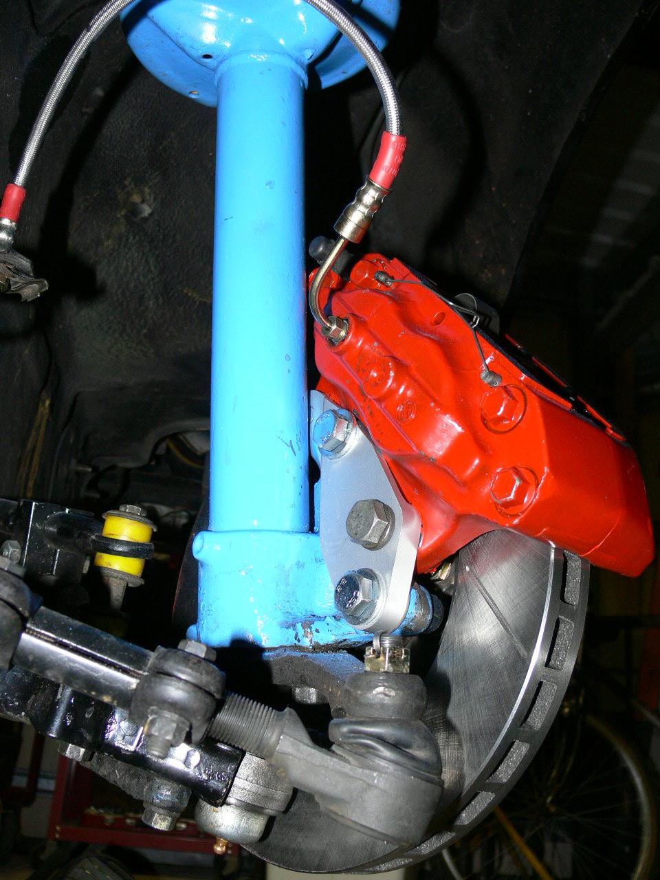

Front rotors needed boring out of the location hole and redrilling monting holes. Trial and error with modelling the caliper bracket in solidworks, printing it off and cutting it out. (I draw the line at colouring in)
I also found some ducting laying around at work, thought I'll give it a go to try and fit them to the fronts.
Hoping to have it on the road next weekend

Here is the caliper adaptor so far, it needs more material removed to clear the strut.
I was thinking of getting it plated at work. What do you think, satin chrome, bright chrome or gold plate finish?

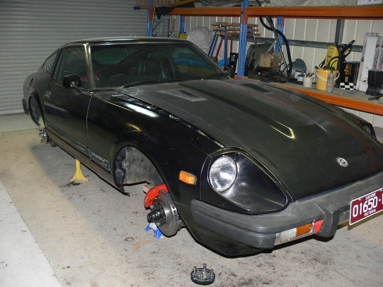

Yay its all on.
But I have a problem.........No one told me that I need brake fluid.
Will have to get some tomorrow.
Time to test.
