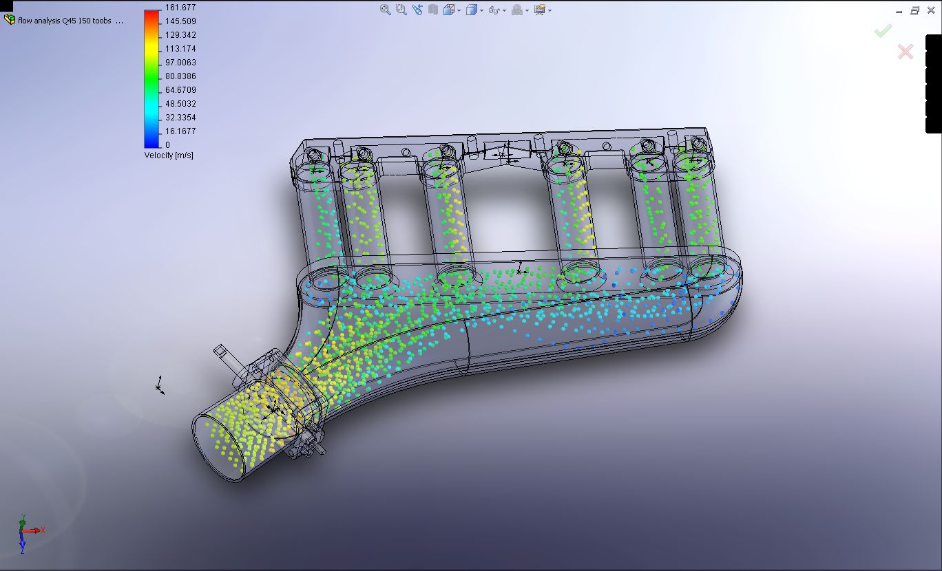

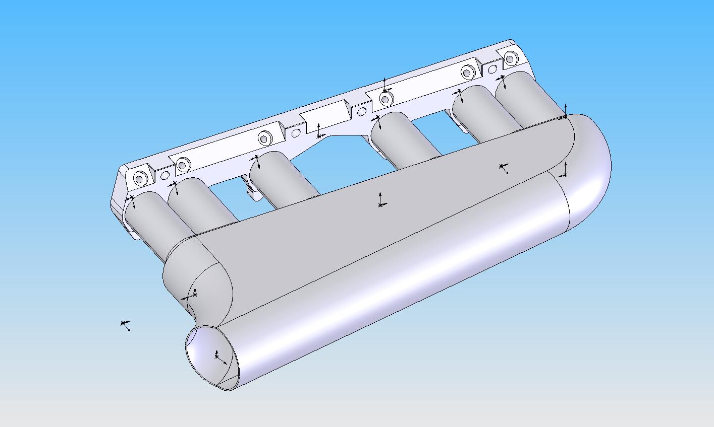

Hey there, I want to build a custom Aluminium intake manifold.
Which of these concepts should I continue with?
Also, i have many choices of throttle bodies to use.
RB20 (dia 60), RB25 (dia 65) or Q45 (dia 90).
Which would be best for an L28 (to be modified in the future)?
(I hope the attachments work.)

KISS principle (KEEP IT SIMPLE STUPID)
Go the first one it is easier to make.
Just ensure it has the same diameter as your Throttle body. This will ensure you get very little presure drop when the air enters the chamber. Therefore your boost pressure will be maintained throughout the whole system.
It also has less welds in it and will give air a smoother air flow. Even though the flow will be disrupted at the 90 degree bends on the intake cones. But the intake cones will straighten the airflow out again.

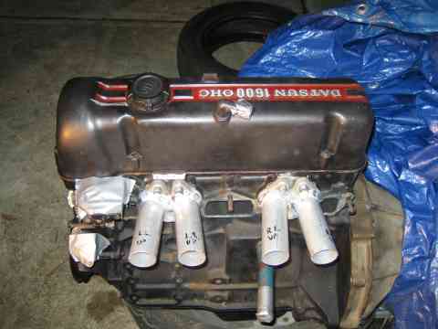

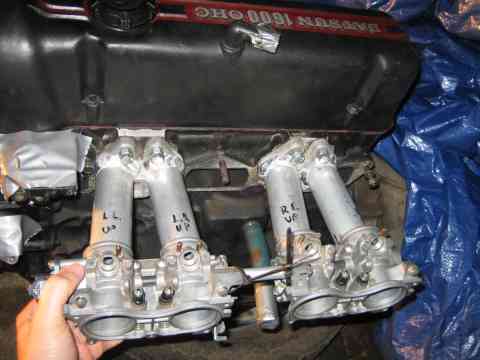

Tripple carb or homemade manfold with motorcycle throttle boddies.

One of the draftsmen here at work suggested the same thing. He says he has done one before on a friends car. Where he 3D lasercut stainless tube and tig welded it together. All 6 tuned pipes straight from the throttle body.
Back to my original question.
My main concern that using the Q45 throttle body would be too big. I have spoken with a few mechanical enginneers here at work, they all think that it will be ok to use.
So I am thinking of another design of plenum that is tapered to increase air speed as it approaches the intake runners.
Will keep you posted.

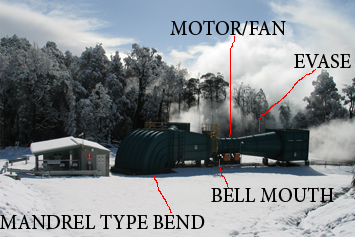

as explained above 6 separate pipes too each cylinder. basically like header in reverse. just the pipes would have sharper mandrel bent radius's and all join together at the AFM. Also each pipe to each cylinder must be the same length so that each cylinder is working against the same friction factor.
With the throttle body, the engine will only use as much as it is going to use. even if it is not using the full capacity of the Q45. I don't think this will affect it? As long as your plenum has the same capacity as the Q45.
In underground mine ventilation which is very similar to intake and exhausts, tapering the intake will increase the air speed, but will also increase the pressure and therefore friction that the engine has to over come.
In a mine ventilation fan the bellmouth increases the fans efficiency, by straightening the the airflow and making it laminar (smooth). Also on the output side of the fan an evase (pronounced evahzae), which is a cone shaped object that starts the same diameter of the outlet then increases in diameter, this increases the power produce by the fan by holding onto the pressure for longer when venting to atmosphere.
This type of exhaust i used on top fuel dragsters.
When you have designed this up I may have to get you to make it in stereo so I can buy one off you. ;D

Some pics of the above explanation.
This particular fan moves "250 cubic meters of air per second"

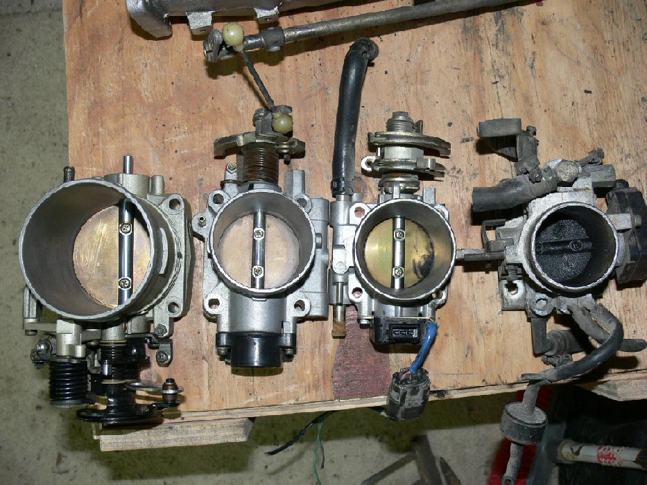

I think it's a no brainer as to which throttle body to use.
Now just need to design the plenum to suit.
Will also use injectors from RB20.
From left to right.
Q45, RB25, RB20 & L28

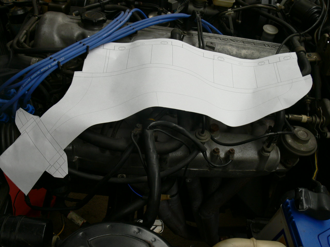

Been reading bits on the web (thanks for the links Hunter) and Race mag has gone into intakes in issue 13 and 14.
I will have to re-design. I am starting to understand more about the theory now, its not as simple as having larger diameter runners and plenum. There is high and low pressure waves to "tune". Volume available and so on.
Here is a pic of a 1:1 plot of a design to check for room.
