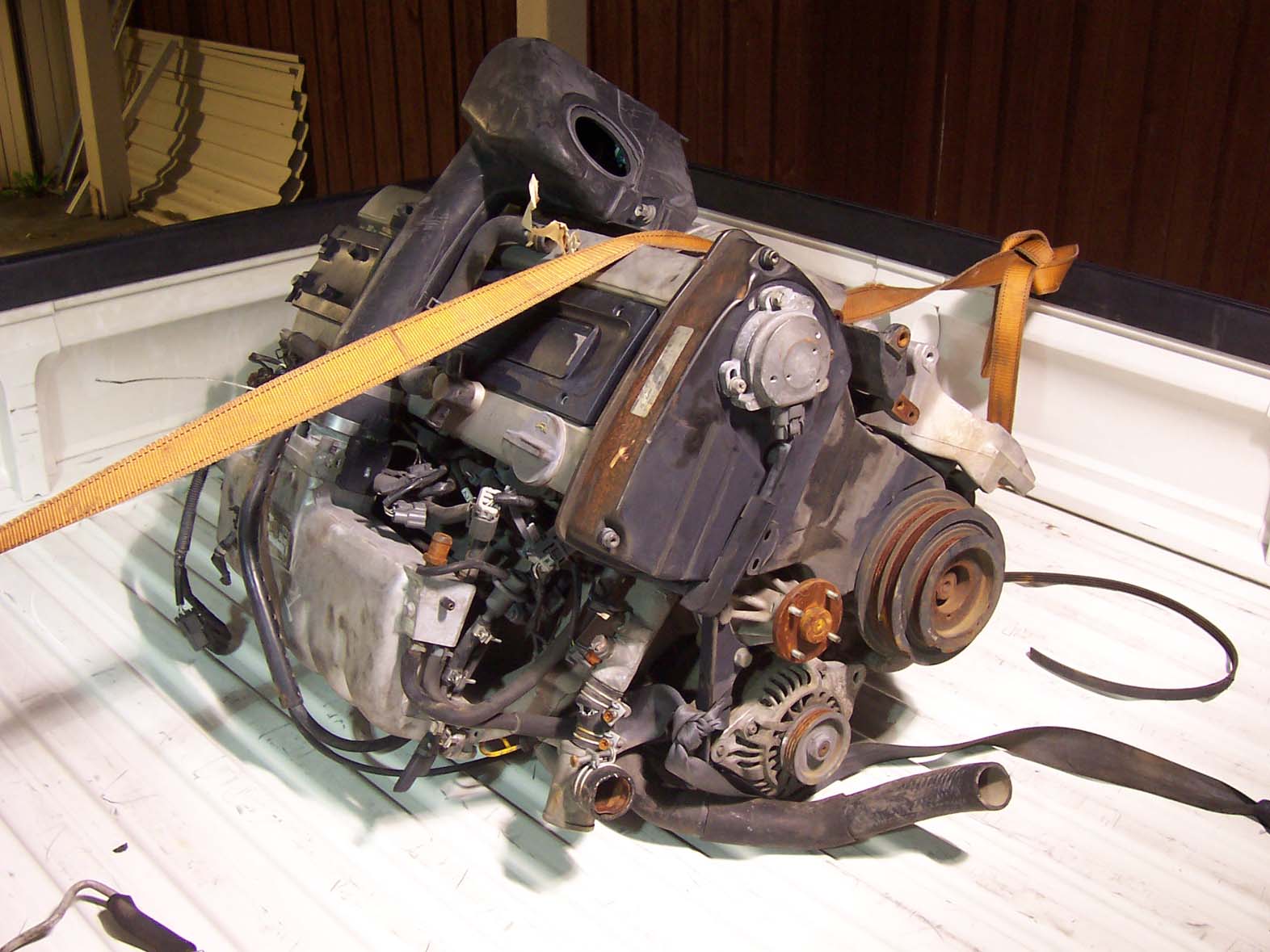

Moderators Zedman240® Posted May 11, 2008 Moderators Share Posted May 11, 2008 Just thought if anyone else is thinking of going the RB series engine direction, a few pictures and info of whats to be done and what you need. First thing that comes to mind is the sump! If you are thinking seriously about the conversion, find and grab hold of a RB20 200ZR sump! Or second best a Patrol GQ (RB30) sump which will have to be modified and oil pickup! Nissan in Brighton say they are no longer available or what may be the easiest, just modify the existing sump. I tend to go with the one that involves the least stuffing around. I've already found a RB25 motor, and started removing all useless original items....like plenum chamber etc.. First pic is when I brought it home, then after the "diet".... More stuff to follow! Quote Link to comment Share on other sites More sharing options...

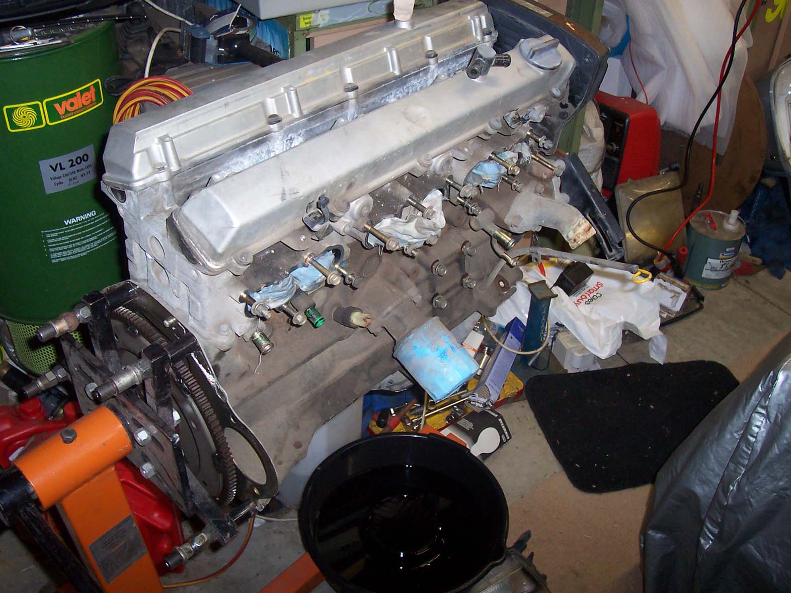

NZeder Posted May 12, 2008 Share Posted May 12, 2008 Ok just popped out to the garage and took some very quick pics - I did not un wrap my RB26 manifold but this does give you an idea on the differences. 1. The RB TB mounting has the same bore and bolt locations but from the left and right they are just rotated around - you should see this in the pics. 2. It should not be too difficult to make a bolt on adapter going by the look. 3. I recall seeing an old Alfa or like which had an adapter that did just this - I will make a template out of MDF or the like and visit the local weber guy that I know that has one of these Alfa adapters and see if they are the same. 4. If the Alfa adapter is different I will take the MDF sample to an engineer/CNC to get some made up. Quote Link to comment Share on other sites More sharing options...

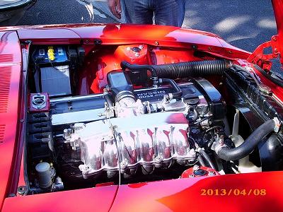

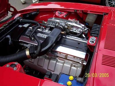

zedls1 Posted May 15, 2008 Share Posted May 15, 2008 Hi NZeder, hope the following pics can help. John Quote Link to comment Share on other sites More sharing options...
