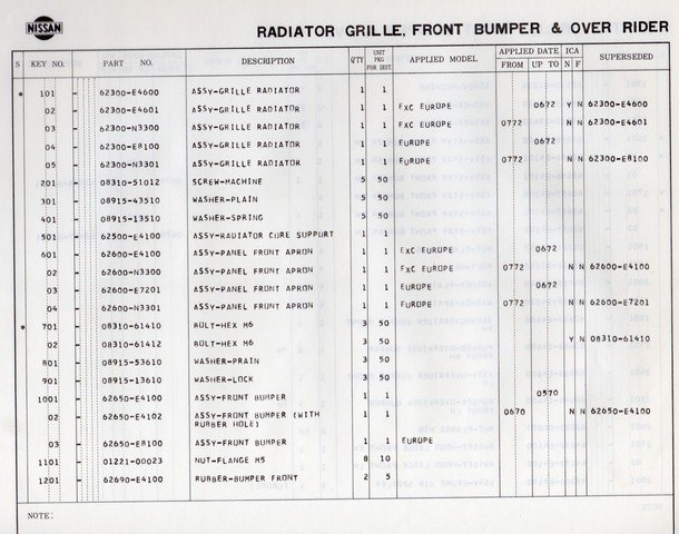

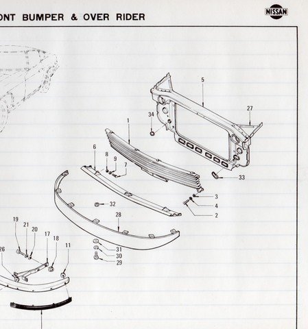

Your servant, Sir!
The first such valance ('front apron') was 62600-E7201, superseded by 62600-N3301 and others (they made them through 1978) and they were specifically for the UK and 'European' models that were equipped with the corresponding 98300-E8100 front spoiler - part of the 'Euro' road package which included a rear spoiler and specific springs/dampers.
The front spoiler was made from an expanded polyurethane material which was relatively flexible. It had steel tabs moulded into it which lined up with the captive nuts in the front apron and lower corner pieces, and unfortunately those tabs eventually tended to rust and 'blow' out of the polyurethane. Lots of spoilers ended up being thrown away because of this...
If such a valance/apron turned up in the USA it could well be the result of a simple part-ordering mistake.
