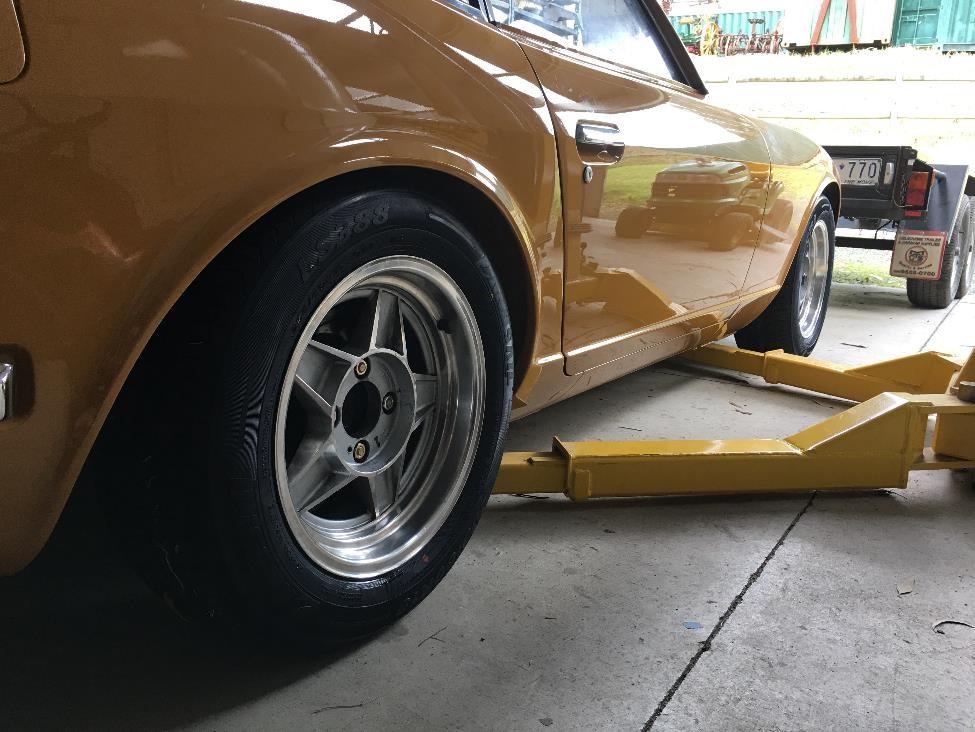

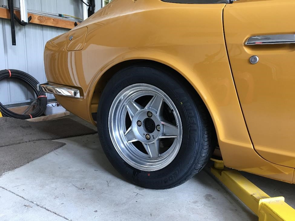

Where do you want your wheel/tyres to sit?
As a comparison, I run 15x7 0 offset with 205/60 tyres and they sit nicely inside the standard guard with no scrubbing.
If you want the original look ie central in the wheel house, with standard width wheels then go with the standard offset.
Hi Cozza, could you please share a photo?
What Cozza said
15x7 0 offset with 205/60 tyres on mine
