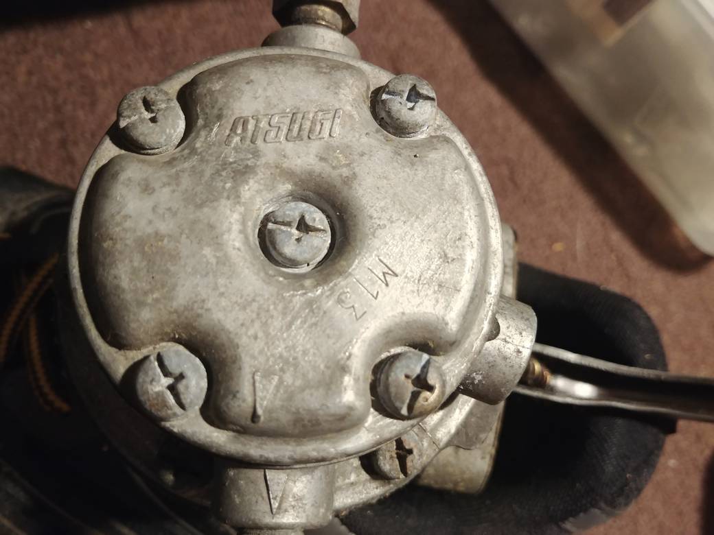

... I've found my fuel pump (on the 72 240z) to have Atsugi on it instead. ...
The Nikki pump that I have came with an engine I bought recently.
I retrieved the original fuel pump from my 9/73 240Z from storage today and it is also an 'Atsugi' brand with 'M13' stamped into the top cover.

Nikki supplied fuel pumps on the earlier models, up to around late 71. Very late 71 and onward were Atsugi.

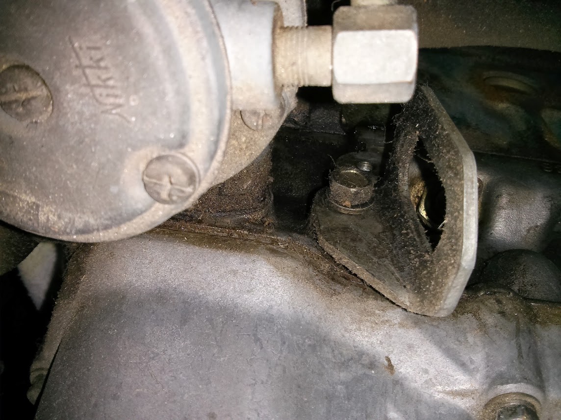

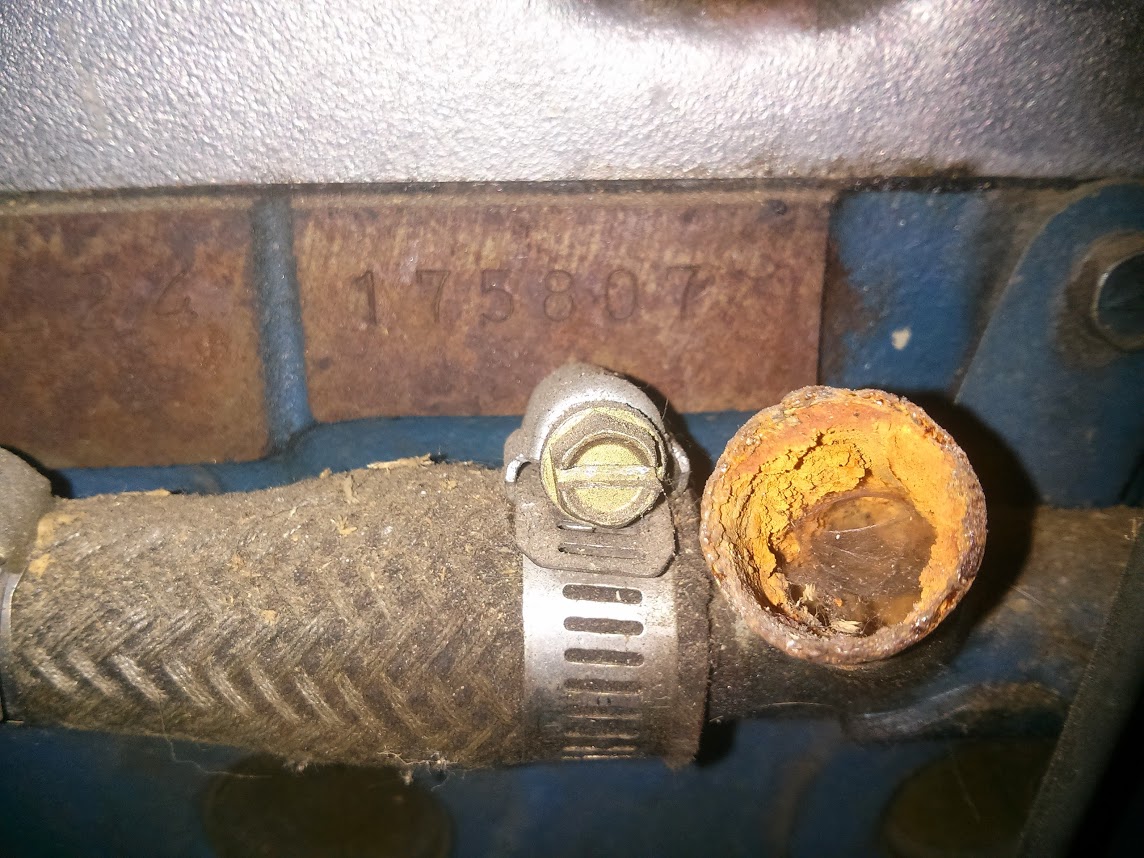

Going through photos the other day, I noticed my 73 240z's engine had a Nikki pump on it. Which I assume is it's original pump. (Engine no. photo attached).
Possible - but likely taken from a wrecked earlier car. Have not seen or heard of a Nikki on anything other than 70/71 before. Suggest the outlier remains the outlier until it's no longer an outlier ;)

The Nikki pump I've been talking about is on my 1971 car. I guess they were something that was replaced over time anyway.
