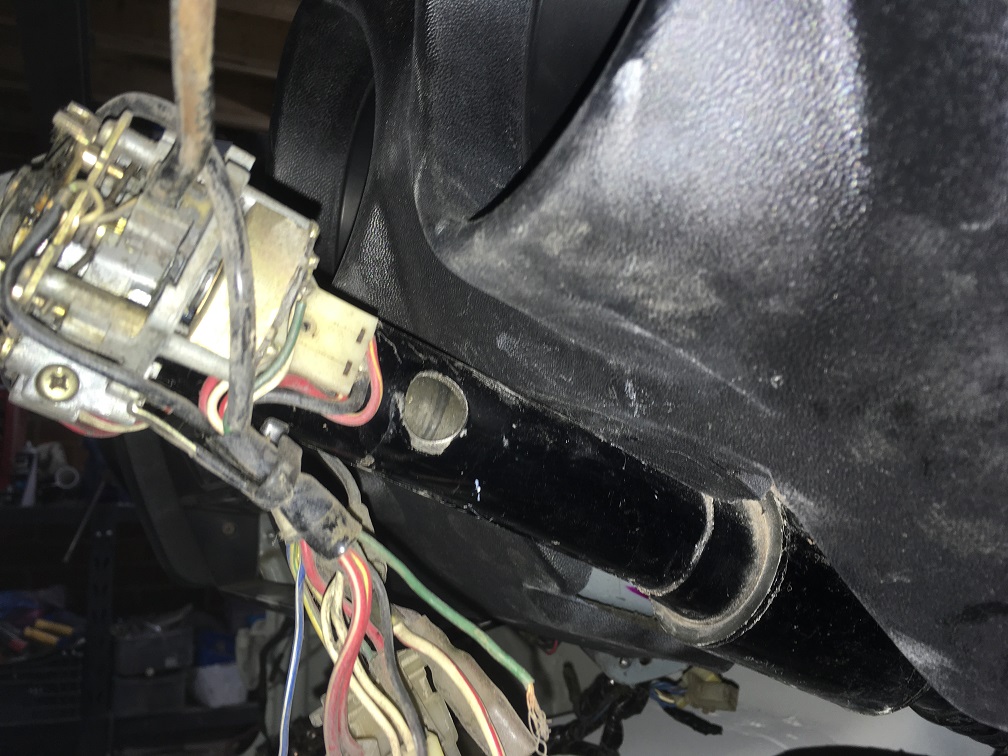

I have a problem with my steering column hitting my dash and I'm not sure what the problem is.
Now I have installed a 260Z dash in my 240Z, but thought the dash and column positions and height would be the same. I bolted my steering column straight up to the pedal box with the 4 bolts. It all mounted fine. Now with the dash in something is clearly not quite right. I can't mount the lock on the column because it hits the dash.
Does the column mount straight to the pedal box or should there be a space in between them to bring the column down a bit?

The column bolts down to the floor/bulkhead with 4 bolts, and to the underside of the dash/box structure with 2 bolts, using an ear bracket with slotted holes IIRC???

The bottom bolt section allows provision for the column to have slight angle changes , the top section has provision to adjust the angle of the column slightly, these two securing bolts pass thru the dash base & assist in securing/stabilizing the dash itself . Suggest you fit igntn/lock unit prior to bolting up these two top bolts as you can then adjust the column to suit your needs for clearance purposes . Hope this helps .
                              Gavin might best be able to answer if the dash is ok for 240Z fitment .

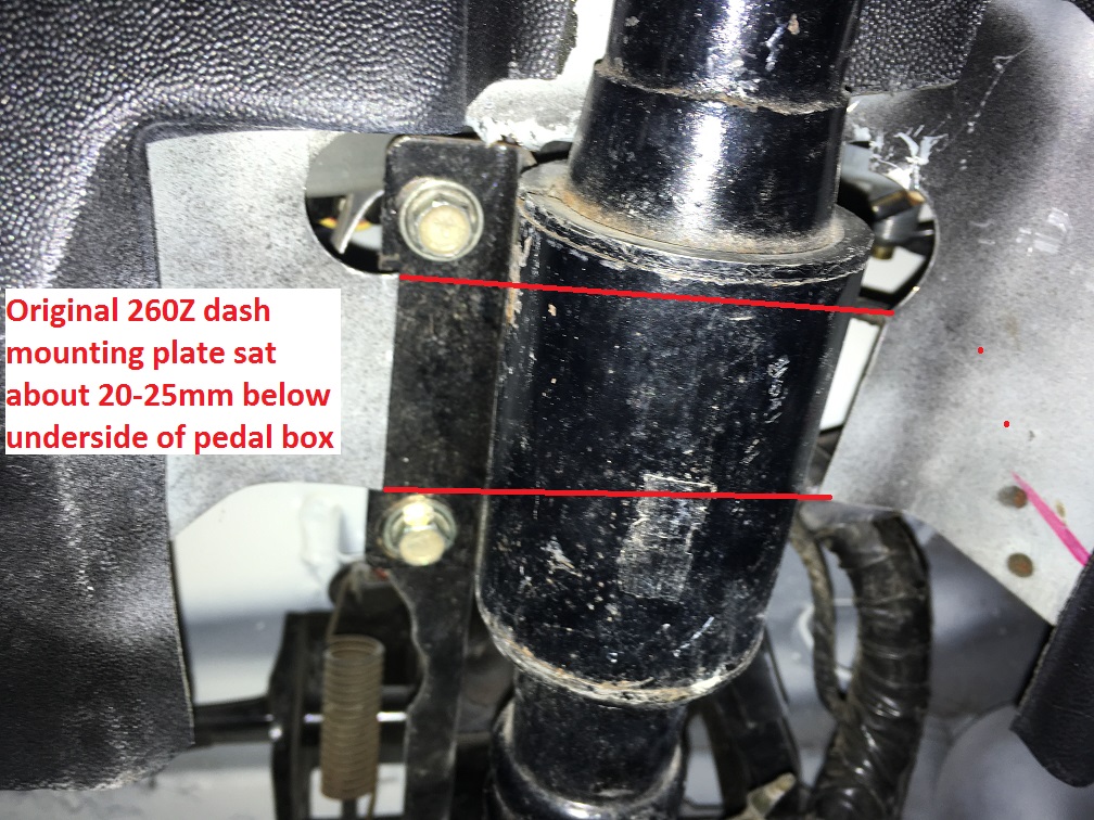

I know that flat bit that flat plate under the dash with two bolt holes in it, it's the plate that was hanging down way too low to clear the pedal box and so I had to to chop it off. :( It was a long way down. I wonder whether the earlier pedal box is a little different to the later box.

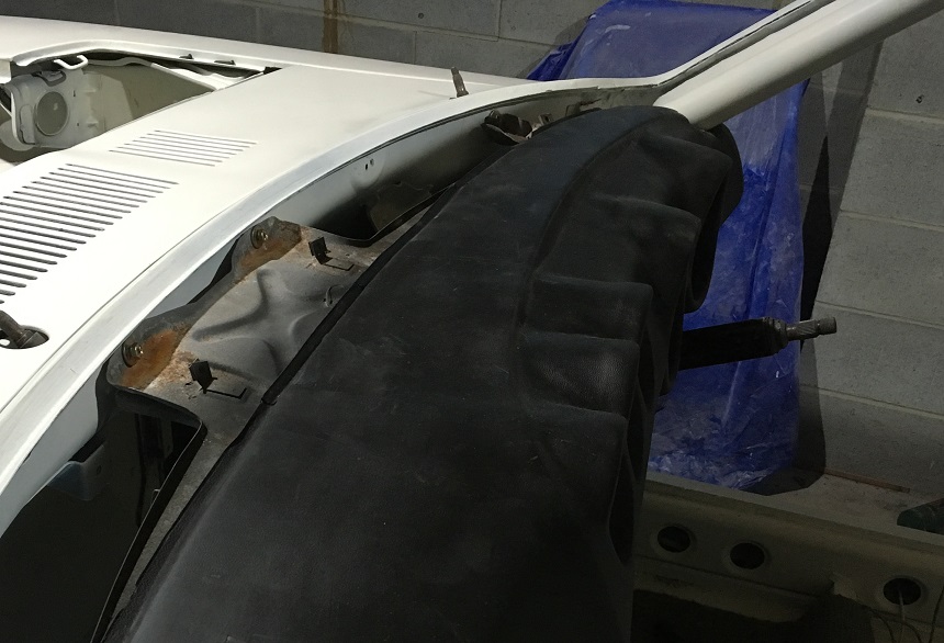

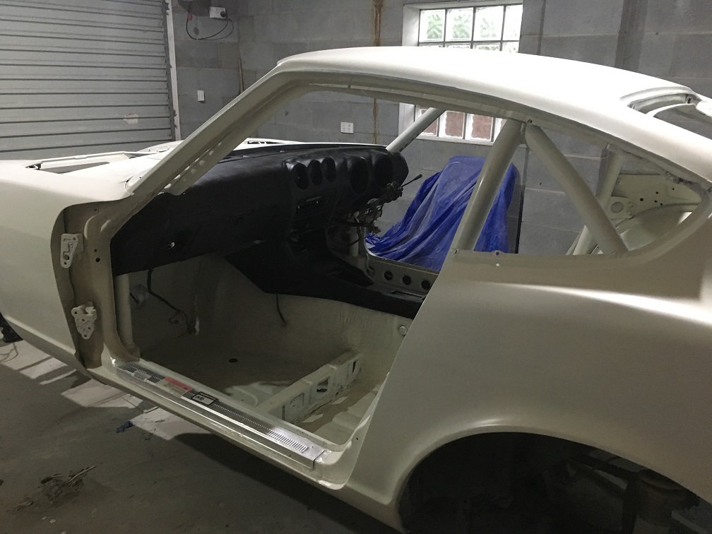

It's possible the cuts outs for the roll cage are not large enough on the rear and so the roll cage is forcing the dash down a bit. Perhaps that's why the gap between the dash and console is angled and not even?

The column is mounted hard up to the underside of the pedal box with the four bolts. I think this is how it should be.
The metal plate under the 260z dash with the two mounting bolt holes sat about 20-25mm below the pedal box and so had to be chopped out.so I could bolt the column up to the pedal box It makes me think the 260 column is meant to sit the 20mm or so lower than the 240 column.
I chopped out the dash a bit more around the roll cage bar and it did not help.
Now I can put a spacer, perhaps 10mm or so between the column and pedal box to lower it if I have to but would like to get it as close as possible to where it should be.

I've done some more more around the cage and got it up a bit better. I feel the dash is now up where it should be, but the column is still too high. I think I'll drop the column down 10mm or so. Seems wrong but the 260z one must sit lower, unless the lock just mounts pointed down a bit.
