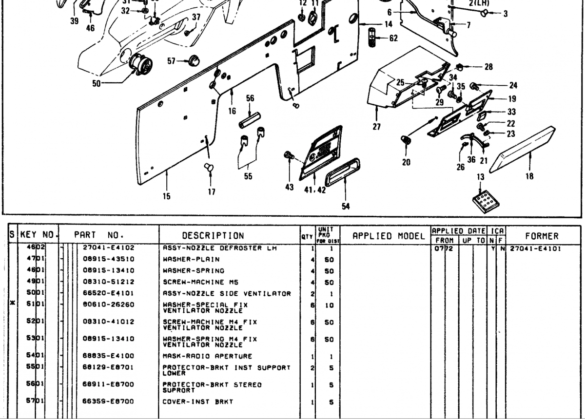

Pfft, as if you need Alan (HS30-H) to tell you that. :) 68835-E4100 was described as a radio mask aperture and was a blanking plate/storage box. Here is the AU parts manual page.
Presumably you could order a 240z without it at the dealer, just like you could forego the clock (blanking plate like Z432-R) and probably power antenna or for that matter order defrost glass (as I've seen a few AU market cars with the vertical line glass, so I assume they must have optioned it) but I'd say very few actually did that.

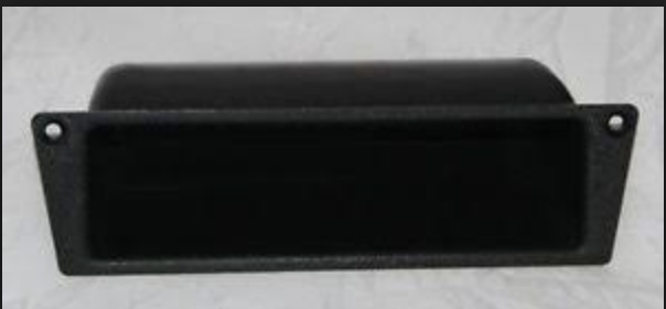

Actually Alan did give me more information about the DIN pocket here. (Photos of what it looks like also attached).
http://www.viczcar.com/forum/topic/14558-the-ebay-thread-2-post-ebay-parts-here/?p=160681
http://www.viczcar.com/forum/topic/14558-the-ebay-thread-2-post-ebay-parts-here/?p=161010
Gav, It's nothing to do with the 432 or 432-R.
432 was technically 'Deluxe' spec, so they all had radios/8-track radios as standard spec.
'PZR' 432-R was technically 'Standard' spec so had no radio as stock equipment, same as Fairlady Z-S ('S30-S'). The Z-S had blanking plates over clock aperture, centre dash vent and radio aperture, but on the 432-R the clock aperture and eyeball vent holes were not even cut in the dash covering vinyl. The Z-S & PZR radio aperture blanking plate was flat not pocketed.
Please remember that pretty much every 432-R sold to the general public was unique. The spec on small details like this was rather loose, to say the least. Some of them were made with heater/defrosters, some not. Some of them were made with gloveboxes and lids, some not. Some made with glovebox lids but no 'box' inside. The flat panel on Takeuchi san's 432-R radio aperture may or may not be original (there are a few things on his car which are like that...) and only one or two 432-Rs had choke and hand throttle controls relocated from the (missing) console to the dash area. It was all personal preference, and often modified by the supplying dealer.
I've got one of the 68835-E4100 DIN bins (I'm rich...! Or maybe not... ) and you won't find it in any of the early Japanese market parts lists despite that 'E41' suffix indicating 1970 S30-specific parts. Best I can figure is that it was a rare option for music haters with short arms and deep pockets...  :)

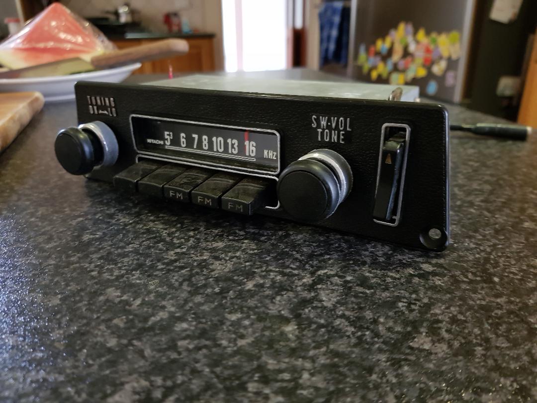

Just thought I'd d post this up as an option for people wanting that original radio look....
Reproduction radio face plate and knobs can  be bought from the US from 240zrubbers (thank gav for putting me onto this)
This was a bit expensive at $275 delivered but at least everything is in new condition.

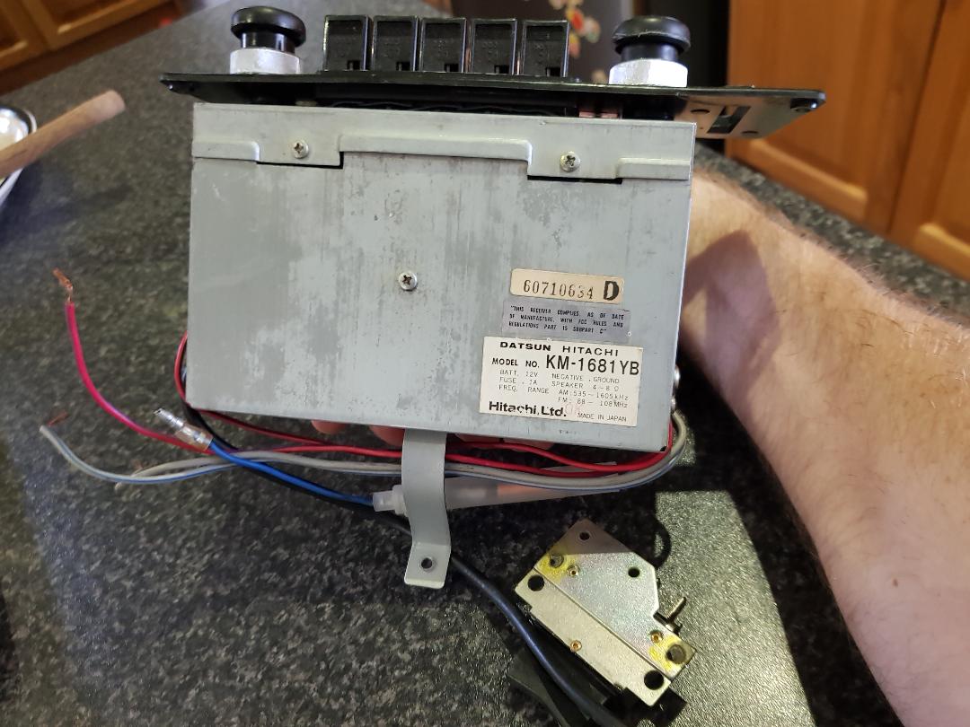

I then bought a 280z hitachi radio which was US$22 buy it now... But works out to $AU$75 delivered.
I already had the aerial switch so just need to attach it to the radio and mount it up..

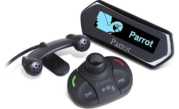

I have a Parrot Mk9100 phone kit in the zed which has ipod connected, screen hidden just under the dash and wireless remote control rolling around in centre console tray so I have fully functioning phone and stereo but with old school radio look. I pulled this out of the wife car which came with it when we bought it, as i upgraded it to a sat nav unit
I am going to wipe off the 'fm' on the buttons for a slightly more genuine look.
At first glance everything looks legit but on closer inspection the gurus will pick this imposter!
This was about a $350 exercise, quite expensive for what it is but much cheaper than a genuine original , it also has fm so you can actually listen to music if you wanted to...
