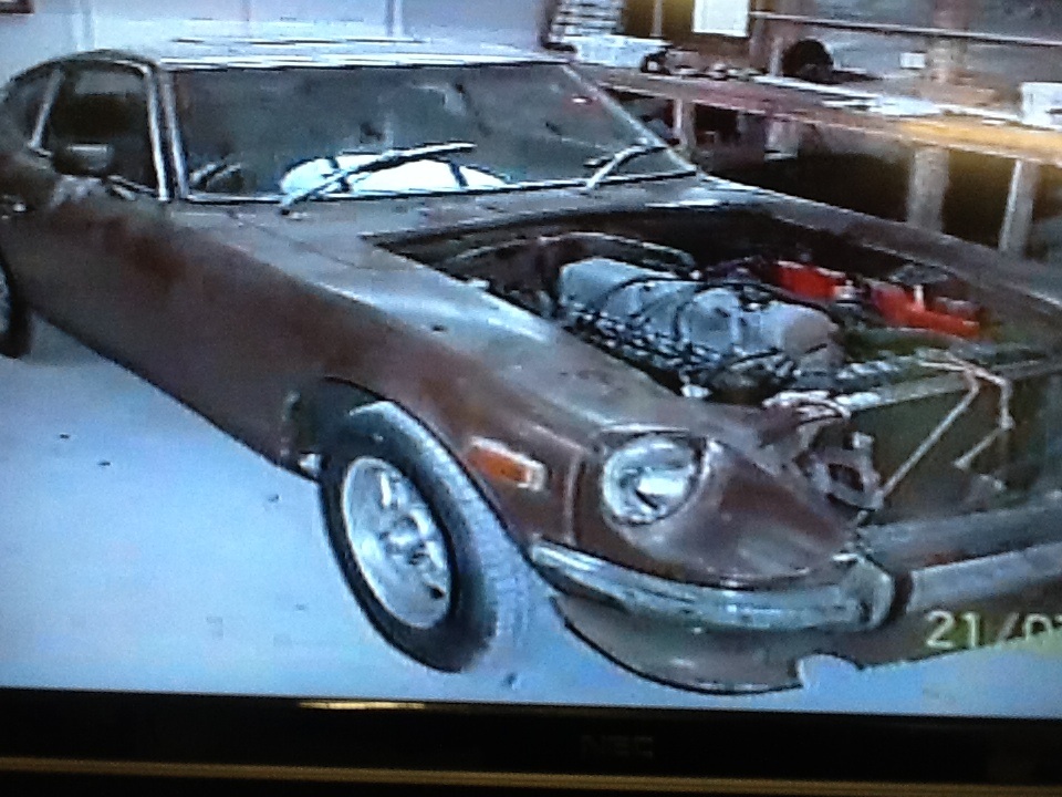

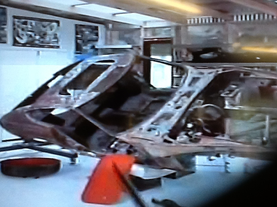

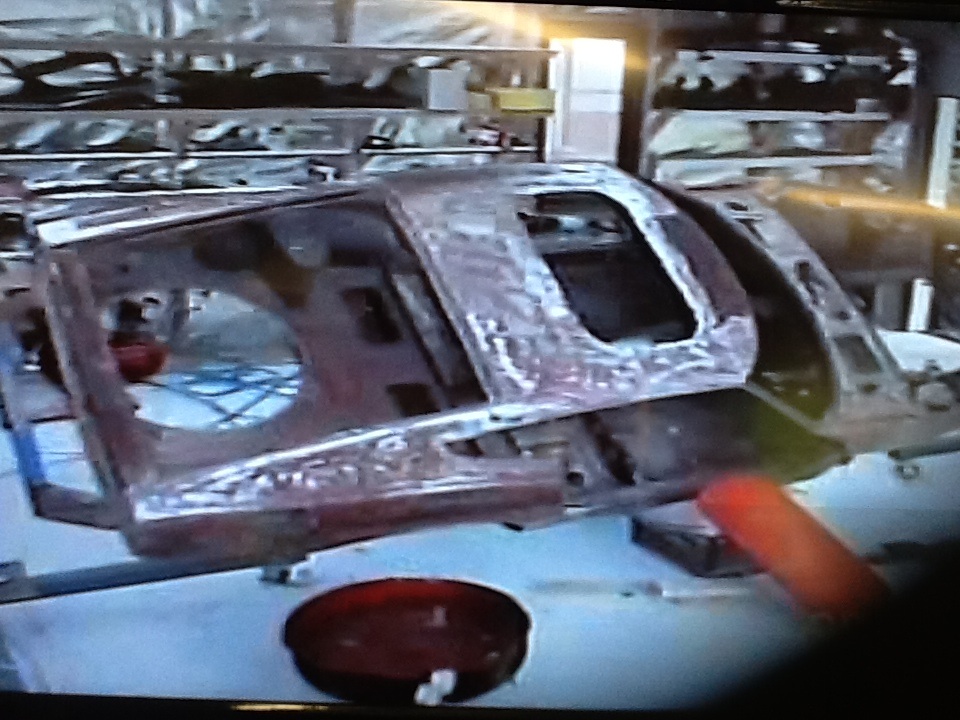

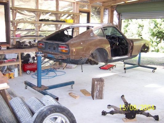

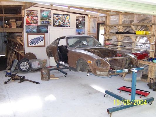

Hi guys. I bought this car in 2004 for about $2500. I had already built a few zeds but this would be my first full rotisserie build. Wanted to do it with a few ideas I had, not standard but a few mods to make it noticeable from the rest.
Just to be clear this car is 95% finished as seen at the 2017 VicZed BBQ .
So after finding a rotisserie the strip down could begin. After taking the engine and gearbox out I would lift the car a high as I could with jacks, blocks of timber. I used the engine Crain to lift the front end and mount it onto the rotisserie .
