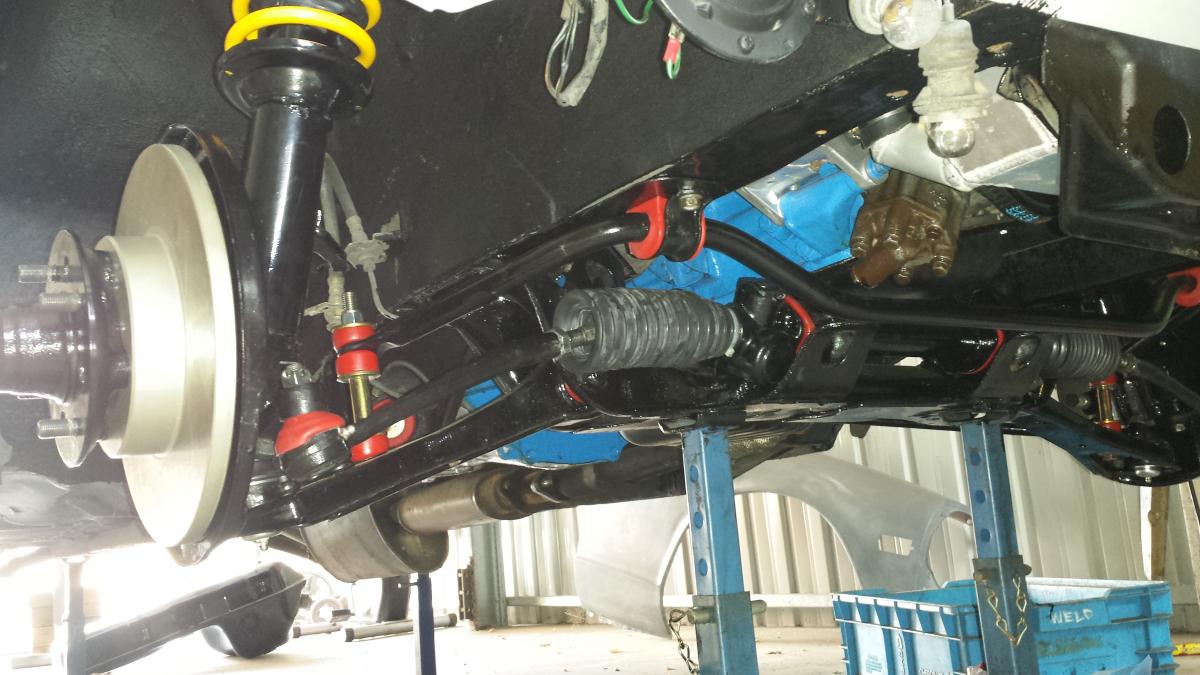

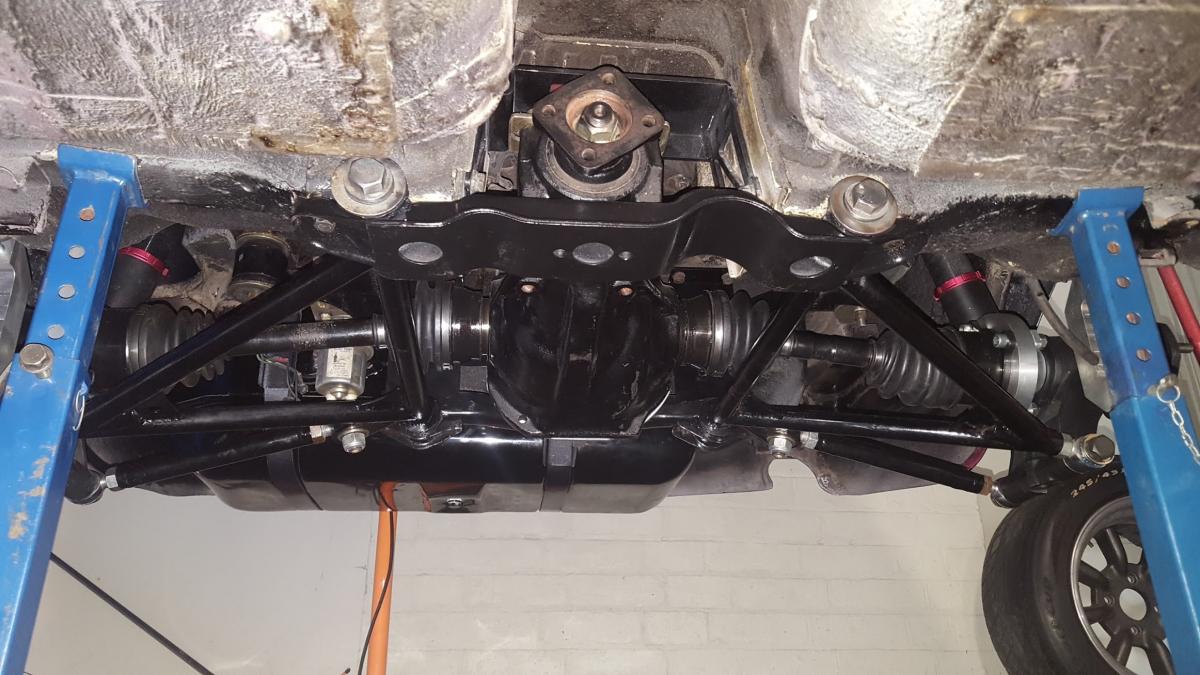

Posted 13 November 2017 - 01:24 PM
I used killrust on mine and worked a treat. I wire wheeled anything rusty and gave anything else a scuff with some sand paper. Makesure everything is wiped down with wax and grease remover then prime it and topcoat.
Edited by blu260z, 14 November 2017 - 03:27 PM.

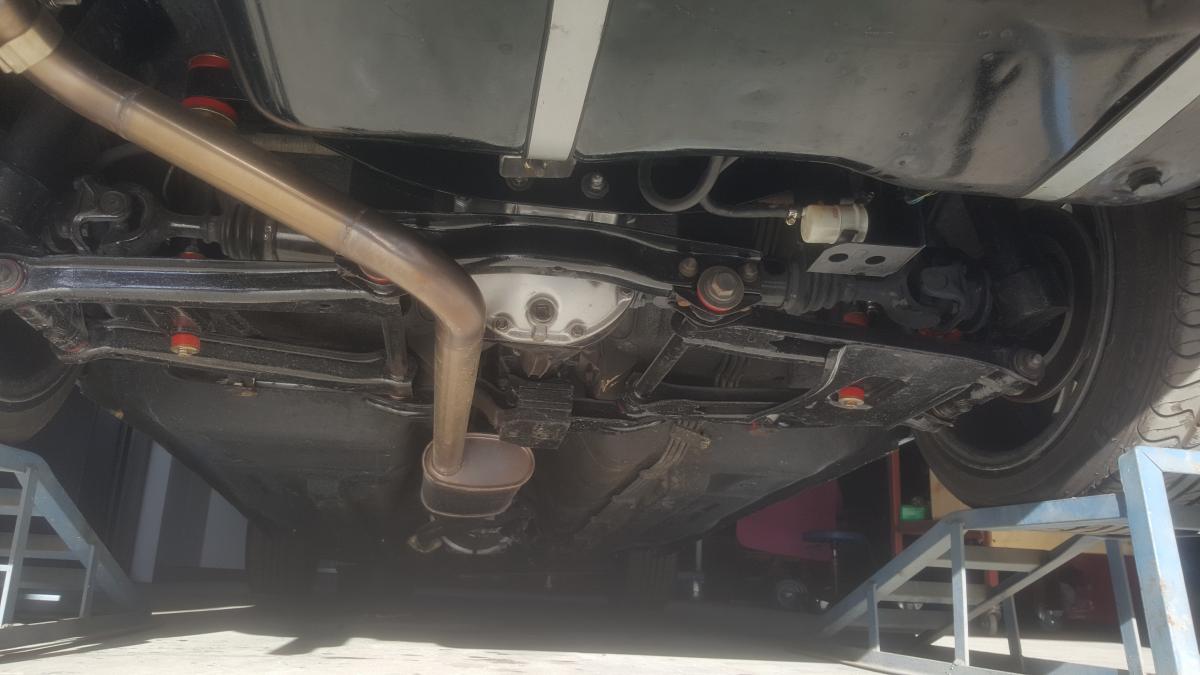

I used the Kill Rust, sand paper, paint stripper and wire wheel method.
Edited by d3c0y, 13 November 2017 - 09:57 PM.
