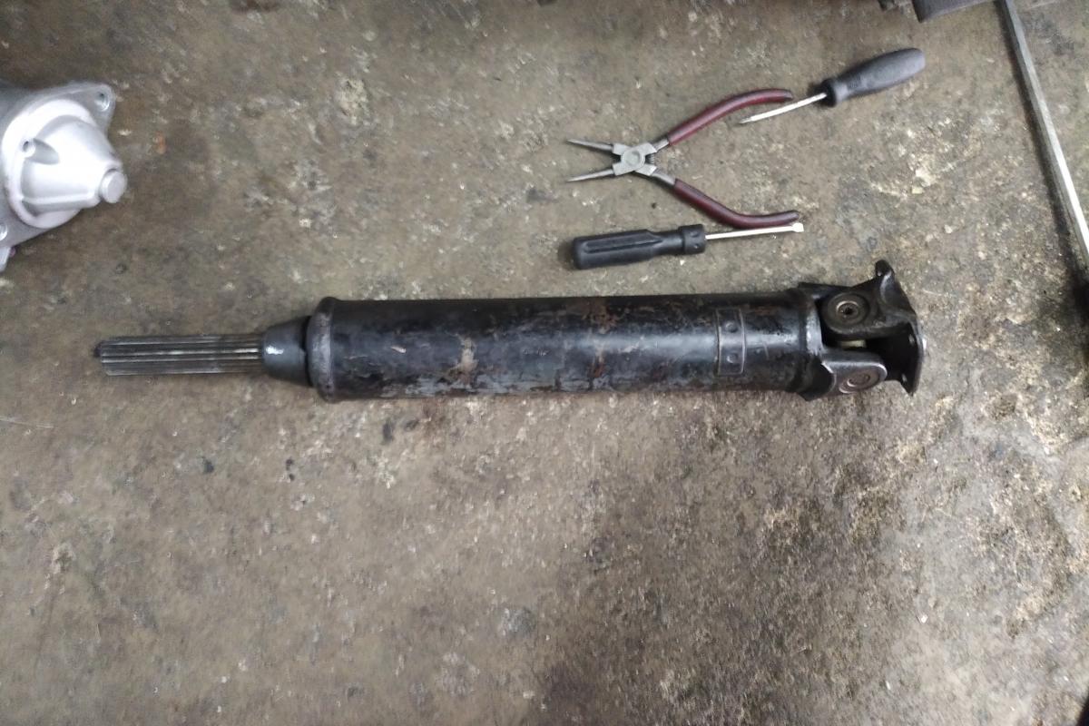

is there something wrong with this tail shaft?
this is what I gotten when removed. the flange is to 71a and the spline to differential.
Edited by locklock, 05 November 2017 - 12:53 PM.

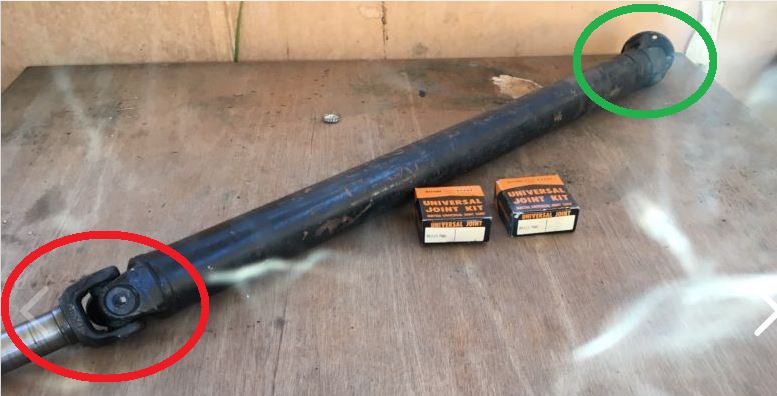

No picture in your post above, I'm eagerly awaiting one as I'm with Lurch and don't understand ? The tailshaft will have a uni joint on one end, with a flange that bolts to the diff. The other end is an internally splined yoke also with a uni joint. It has to have a splined slip joint somewhere to take up any misalignment / movement / etc.
Like this, front yoke may or may not have a dust shield depending what its off.

Yes, there is something wrong with the tailshaft you posted. Throw all that splined section away - all you need from your existing tailshaft is the flange and uni joint on the diff end . Then take the front yoke and uni joint from the S13 / RB20 / whatever box you have. Then join them together with a solid tube of the correct length, get it balanced up and away you go. It then bolts onto the diff and slips into the rear of the gearbox on a splined slip joint.

Just to be 100% clear, in the photo attached here, the bit circled in green comes from your existing tailshaft and bolts to the diff. The bit in red comes from the new gearbox. The tube joining them is new.

don't know what the previous owner did. the green circle was bolted to the 71a tail, and the red circle was just stucked into the differential.

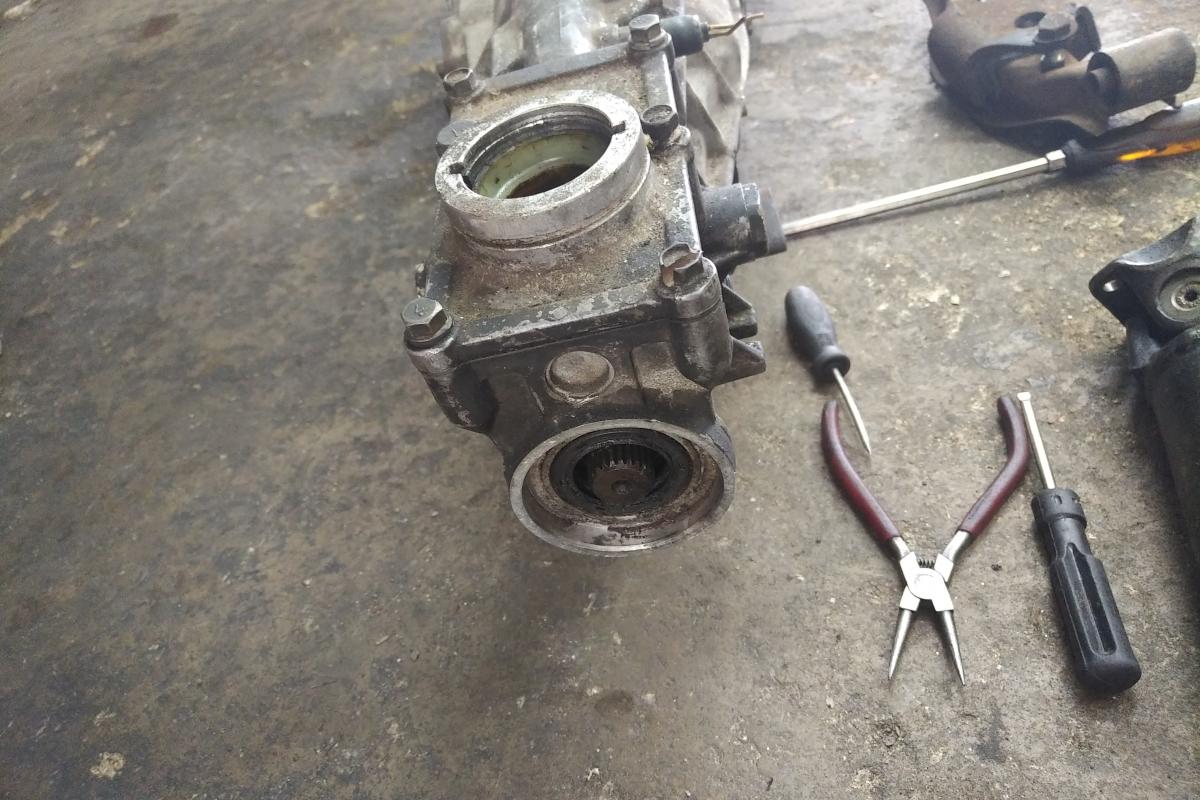

That’s intriguing, can you post a pic of how it was stuck into the differential?

sorry cozza, don't have pic taken. I believe it's 2 piece drive shaft.

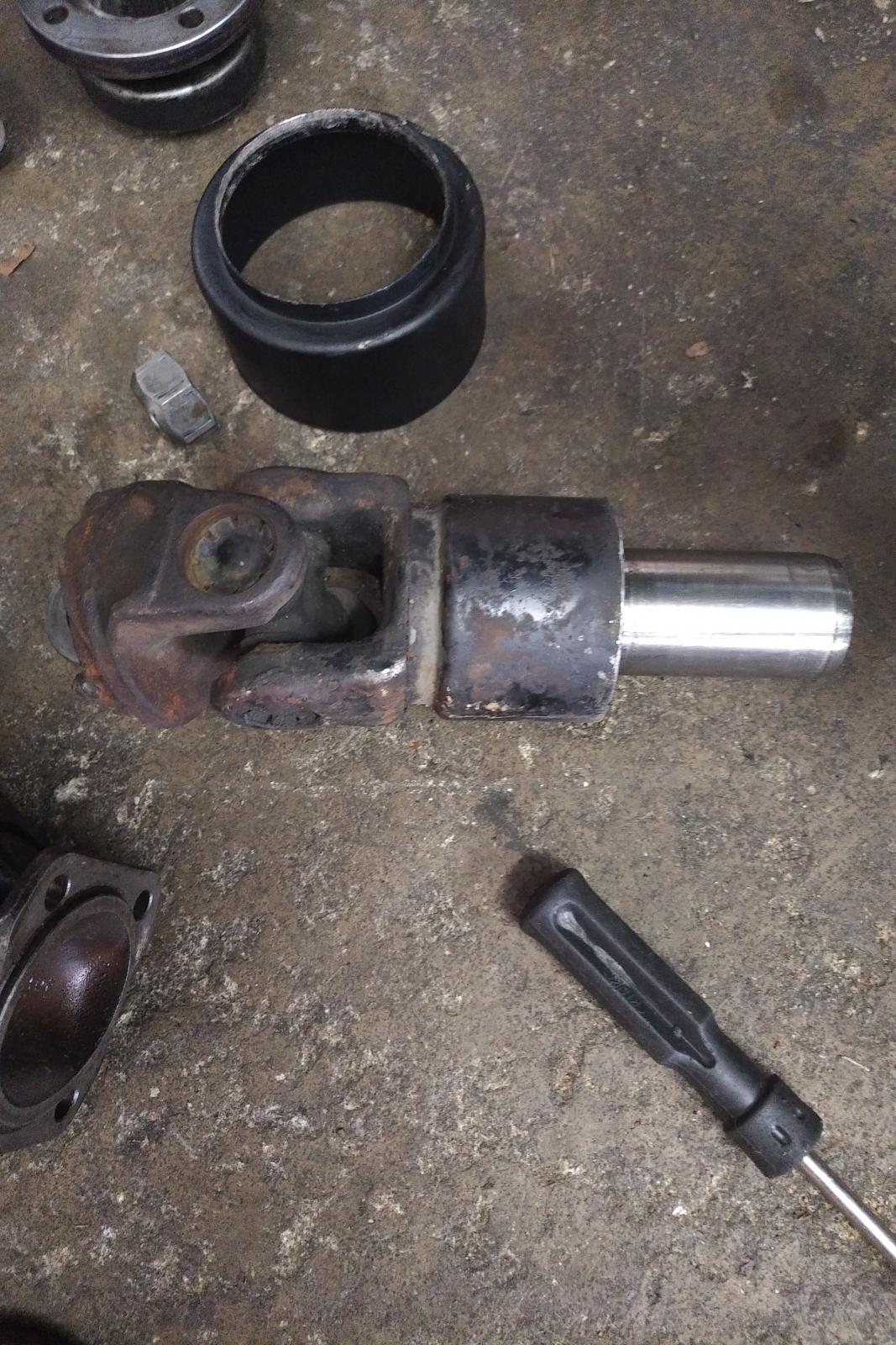

is this the original shaft?
I'm quite reluctant to shorten it, can I use a s13 shaft for this setup instead?
