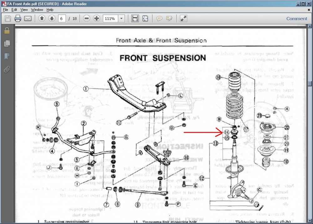

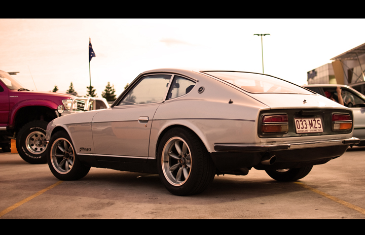

I've attached a pic of my car (its right at the bottom as an attachment) when it had the low king springs in it, which is about all you get without sectioning the struts which is not very low. If you look at the "good looking" (subjective, i know ) cars on the internet they are 90% running coilovers to get them low enough to close the gap from the top of the tyre to the wheel arch. eg:
datsun-240z-owner-left-no-bolt-unsnapped
The inserts are inside a strut tube, which has the spring perch on the outside. Just google "240z front strut and have a look". Who is going to know they have been sectioned if the job is done properly too?
10758d1369412350-front-strut-removal-str
You can get the MCA setup bolt in for around $2500 which is very reasonable. If you are getting konis, re-valving them, sectioning struts and getting custom rate springs I don't see how it's going to be much cheaper or less work.
And if you aren't prepared to spend that on the shocks and springs then was your massive list a massive time waste? You were talking a couple of grand on adjust arms just a few posts ago.
Progressive rate springs are crap for handling that's why basically no coilovers have them. So do you actually value ride quality over handling?
This is a bit of a contradiction to the topic of your thread "Holistic Approach To Handling. Done Right The First Time!"?
Also good quality coilovers aren't harsh especially if you pick the right spring rates. I had a Gen 4 Liberty with cheap nasty Pedders coilovers and it was the worst riding car i have ever been in (i didn't install them).
