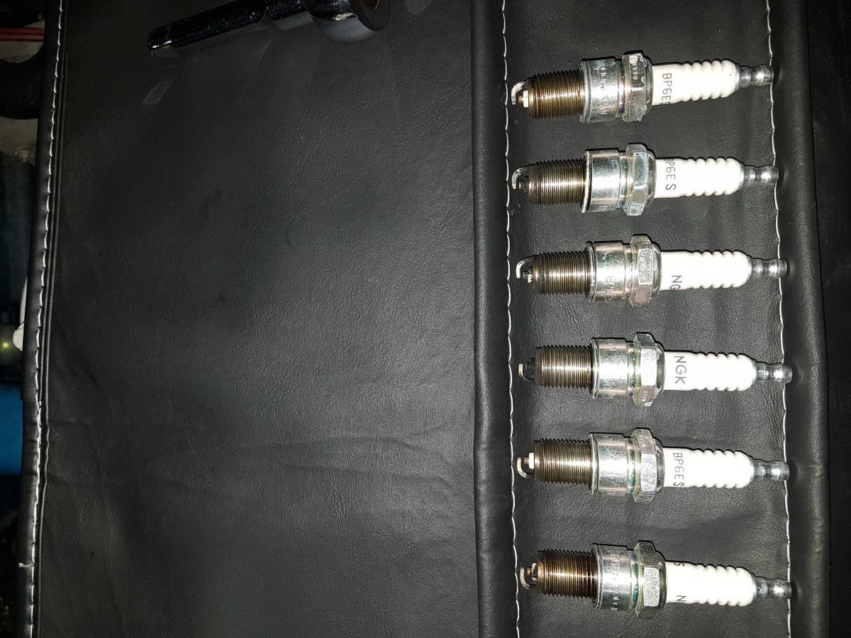

This is a picture of the 6 spark plugs in the following order of cylinders 6-5-4-3-2-1. This ishow they came out after long idle time during traffoc jam last saturday. I have already lowered the mixture knobs on both carba to 2.5 turns and have installed new spark plugs to test.
Edited by jalexquijano, 06 October 2017 - 12:13 AM.

but the  electrodes look white, which is a sight of TOO LEAN a mixture? unless its the reflection of the flash

http://www.crankshaf...ing_spark_plugs
Looks like you're too lean and too much timing.
