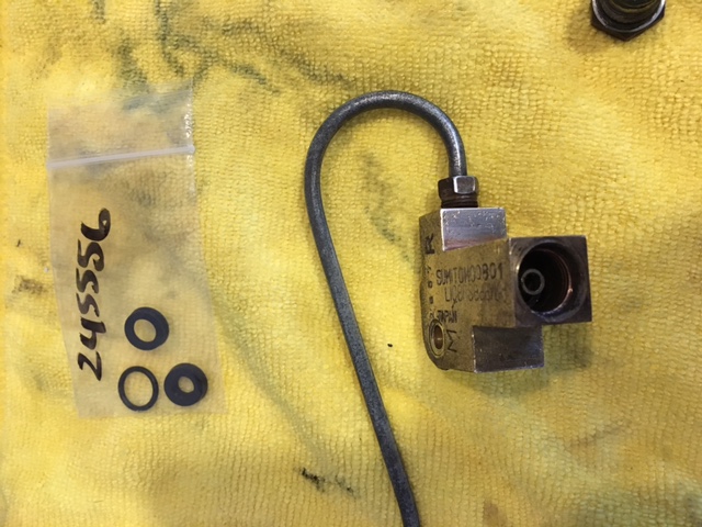

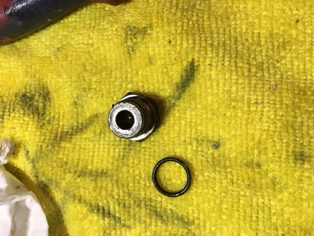

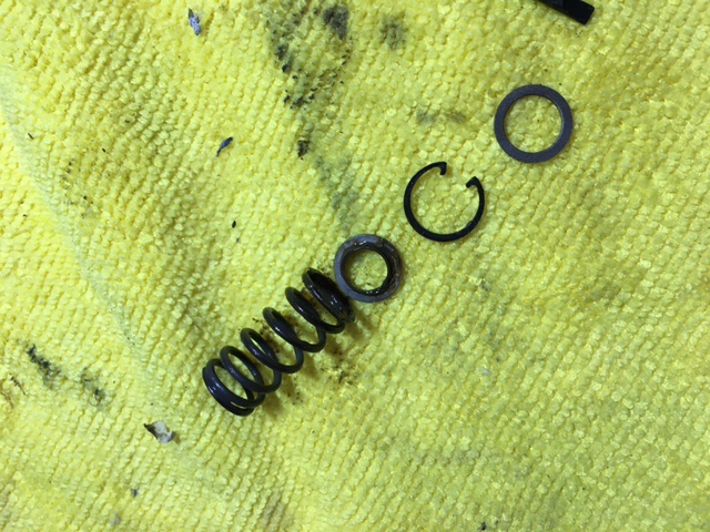

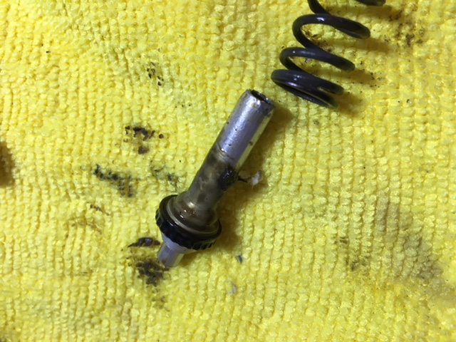

benv Posted September 5, 2017 Author Share Posted September 5, 2017 Update: I have been quite busy, cleaned and reinstalled center tunnel fuel and brake lines. Stripped the main body to bare metal and uncovered the worst bondo surprises, Jeff CBR and I should have a competition for the most unexpected find underneath bondo. I suspect his bonnet may win though. I also moved the lca holes (+19,+6) in the front cross member to correct bump steer. Some general pics to follow soon. It is hard to keep these build threads interesting as restoring zeds seems to be a well defined science and most of us go through a similar process. Anyway I did rebuild my early proportioning/delay valve: The rebuild kit includes one o-ring and two seals. The hardest part is removing the tiny cir-clip in the chamber holding the spring and plunger in place. I used two small watchmalkers screw drivers. I used brake fluid for cleaning the parts and for lubrication. When reinserting the circlip one needs to make sure it is in the lower groove, not just below the bolt threads Quote Link to comment Share on other sites More sharing options...
Cozza Posted September 5, 2017 Share Posted September 5, 2017 Nice info Benv. Just wondering where you got the kit from. Also, how did you find the condition of the seals etc upon removal. Where they hard and brittle, swollen or anything? Looks like it was pretty gummed up with sludge which I'm sure would have an effect on its performance. Thanks Mick Quote Link to comment Share on other sites More sharing options...
benv Posted September 5, 2017 Author Share Posted September 5, 2017 Thanks Mick Kit was $12 from theZstore. Surprisingly I didn't think the seals were that bad after 40 plus years, the new ones are more supple though. In my case I may not even use the valve as I plan to install Booster/master cylinder /calipers from an R33 which may mean a R33 proportioning valve as well. Quote Link to comment Share on other sites More sharing options...
