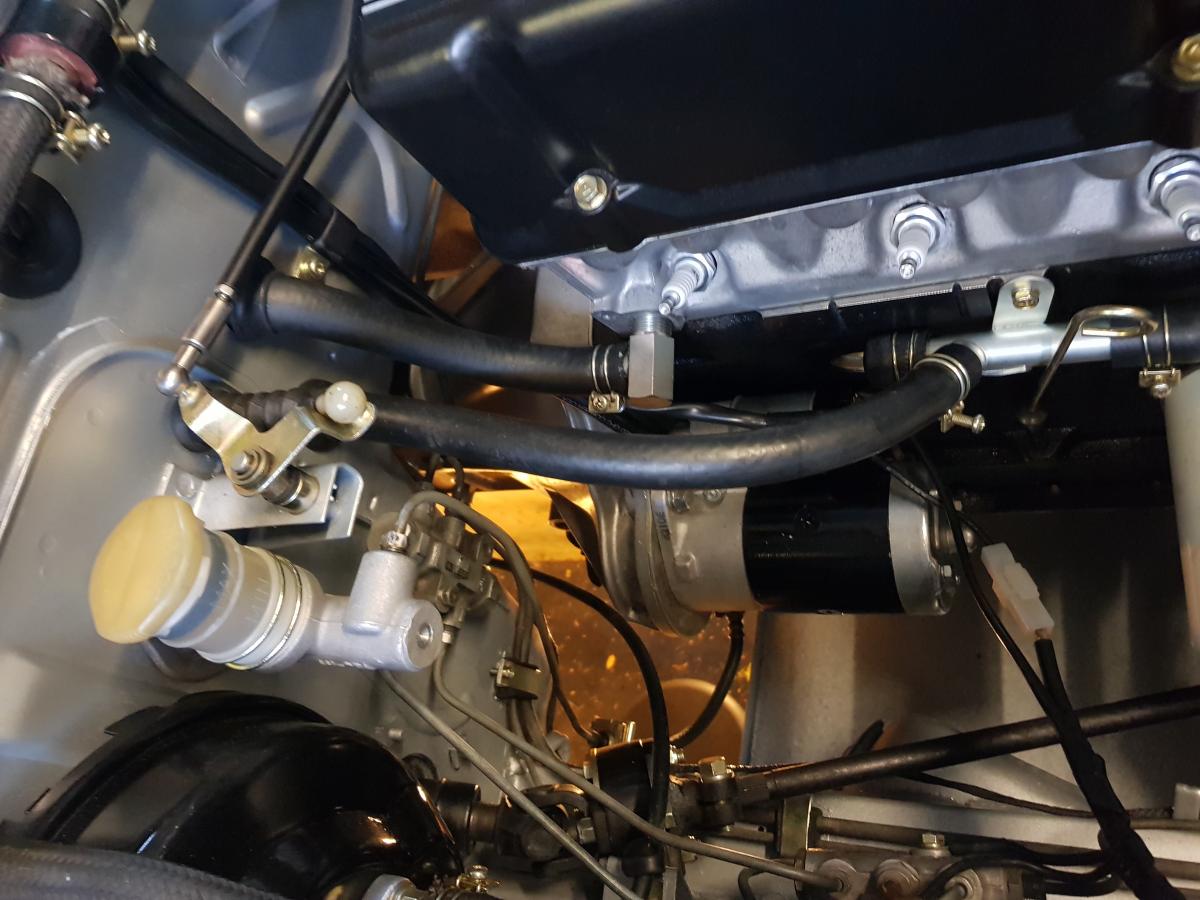

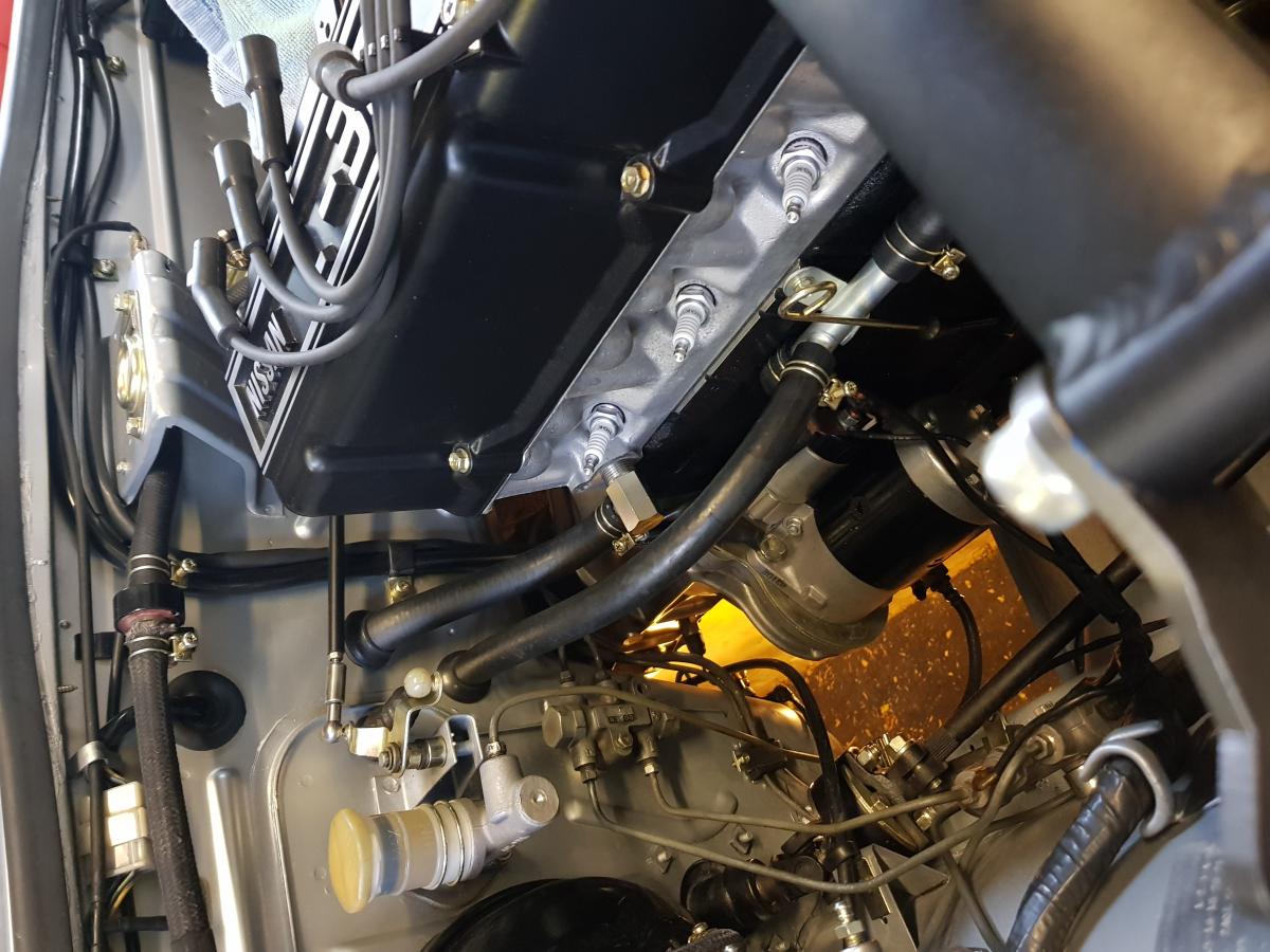

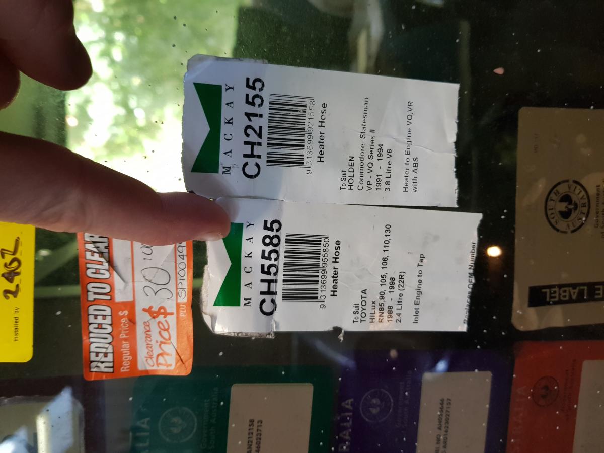

I bought a toyota hilux and holden commodore hose and trimmed a bit off . came up quite well. i'll take a photo and get the part numbers in half an hour.
Edited by CraigZ, 30 July 2017 - 10:34 AM.
  • OdinZ likes this
#7 CraigZ
CraigZ
  • 165 posts
  • Location:Adelaide
Posted 30 July 2017 - 10:37 AM
See photos attached, with part numbers
I actually prefer the look of the shape of the replacements than i did the original braided ones.
but do like the braided hose look

thanks all, i tried my local Repco store and waded through all the hoses they had in stock and found a couple that I felt would work. Bought a couple of brass 5/8' fittings and got it all back together no issue. I also put one of the springs on (thanks "old retired z fart" and Bunnings.  The hoses were: Ford Courier 02-115 and the other was Corolla 02-0093 and the last one was Holden 02-1087. After a bit of cutting and fitting, all came good. Definitely not original but not too much on my car is now but it works for me. Appreciate the quick input all, cheers
