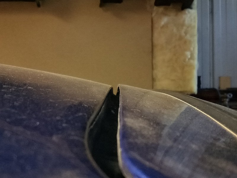

So i bought
2 gaurds
Bonnet
2 light buckets
Rear hatch
Total $1490
gaurds are pretty good. Line up well with doors and everything. Very few imperfections in gell coat. The only thing is they dont come with the catch bar for the inspection hatch. And they told me to.just make something and glue it on :-(
Light buckets are not to bad.. but dont match the shape of the gaurd 100% but better than repro steel ones.
Bonnet is great. Very light and ridged.
The rear hatch.. was un usable. Sat almost 20mm above the roof line. After hours of grinding and bending the mounts, it still sat high. The alloy mounts were not deep enough in the frame and stop the hatch from droping down level with the roof. The glass hatch is 5mm thicker than the steel one which is no good for fitment. The back right corner also doesnt match the body shape. Ive attached pics so you can see how it all looks :-).

Well gav, i actually restored the original rear hatch and gaurds/light buckets and then desided to give the fg a go lol. So ive done everything twice now . Im using my steel hatch now. (I got a hold of a rust free steel one now too.. a
) yeah ill get some pics for ya :-)

When i told them they didnt realy beleive me, but told me to drop it off after ive modded the mounts so they can patch it up... But im 2h away from them so thats not an option.

My hatch sits a bit high too, not as bad as yours though.
I suspect they arent trimming enough off the back mould before joining it to the hatch skin, but thats just a guess.

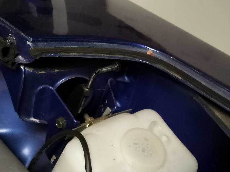

I ended up using the metal inspection covers because it was easier than fabricating some sort of clip mechanism to the underside, but I still had to make a little bit for it to clip onto. Its just a strip of metal with a nut welded to the end, then a long bolt bent at the end.
Its adjustable so I can fine tune the height of the cover and get it flush with the panel.
Ive only done it on one side, because the other cover is 95% mesh. Nothing to attach anything to...
Once the bonnet is down they cant come open.
