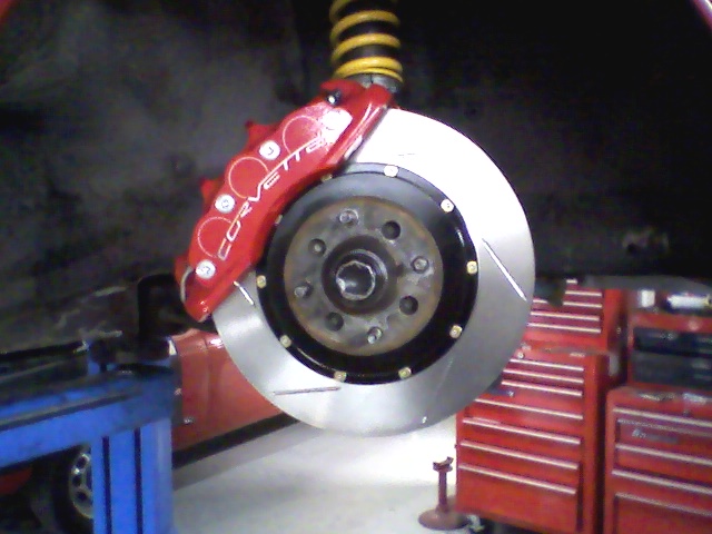

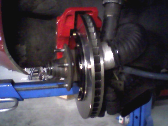

Thought someone might be interested in my new front brake setup.
calipers are Corvette Z06 6 piston, 6 pad, 330 by 32 stoptech rotors custom hats and adapters.

The cost of the various parts goes like this..
hats $200
adaptors $300
calipers new, Ebay USA landed AU$750 a pair
competition brake pads AU$280 landed
rotors Stoptech USA approx. AU$700 landed
The bits were made by a bloke in Melbourne called Chris Woods
very happy with his work.

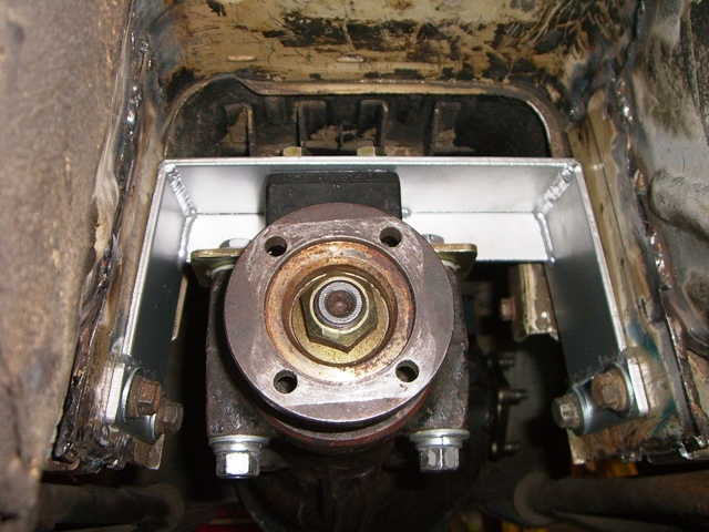

I would like to do the rears as well, but that might have to wait for a little while. due to having the my LSD recoed and fabricating a front diff mount to stop tearing apart standard diff mounts. Here is a pic of what I had made by Chris as well.
The cost of fabricating the mount $80, special polyurethane mount $64

Ive bought one of the poly mounts with one of those brackets in mine due to the same problem, but haven't gotten around to it yet, $80 seems quite reasonable for a one off part that size and complexity, or does chris woods sell these parts a bit?

Chris did the mount as a one off, so yes a very reasonable price.
The rotors are a high quality competition item from www.stoptech.com and the price is for 2.
The reason I went with the Z06 calipers is that PBR who makes them won a engineering design award for this caliper, and they are a road caliper with dust seals so they comply with ADR's. I am in the process of bedding in the rotors and pads and I have to say the comp pads squeal like a stuck pig!!!

Could you please PM me Chris's contact details? As at some stage i should work on the diff mount in my car...Are you no longer running a diff mount under it? It also looks like you may of had some extra plates welded in around there to strengthen it up? My concern with it bolting directly to the sidewalls is putting the holes in the right position, i was hoping to get a braket made up that used some tube so the existing mounts from the strap could be used but then it would need to be fairly tightly toleranced and is a pain to measure the dimensions correctly!

Nice like the ducting setup too - got any more pics of that? Also it looks to me like those calipers are a mono block ie single casing = less flex. So what are the bolts in the casting for? I assume done for some manufacturing process only? ie how the fluid galleries are created between the pistons.
I did not know that PBR made a mono block caliper? Do they make some 4 pot version? If yes what size rotor and pistons do the have/support.
I have some Porsche Boxster mono blocks that I plan to install, again with a custom hat and adaptor but I will use a DBA rotor for my setup as the Stoptech is too large for my requirement - I think the smallest rotor they sell is 320mmx28mm and I am going to around 300mm x 25mm as the Boxster caliper is designed for a 24-26mm rotor. If I got calipers from the Boxster S then I could go to a 28-32mm rotor. The Boxster calipers are 4 pots both front and rear.
