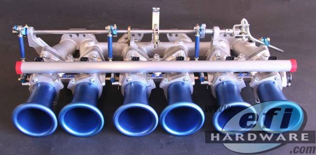

https://www.efihardw...e-manifold-45mm
PRO-STREET-SERIES-Nissan-L-series-6-cyl- ? ? ?

Hi Lurch, I had looked that complete set up. It looks very nice, but it was quite a bit.
I had also considered the individual pro street throttle bodies. They look good too and the air bleed is a nice thing to have. I did wonder about the method for retaining the injectors as didn't look as sturdy as the other ones I was looking at. I also wondered with the injector appearing to sit well out if they may foul and air box. A couple of options there.

That Ebay unit, in the OP, states its from Ballarat Vic.
Isn't that Steve Newing at EFI Hardware?
Just buy it direct from him!
A not so often on here chap from Sydney, told me about his LO-Budget alternative to these expensive TB+ Inject units,, brilliant dea, and so simple!
Get a decent triple Weber type manifold, weld bosees on, at near to head, at an angle, fit injectors, hook up a rail, run the usual high pressure fuel control, then, just bolt on a old set of 45dcoe's, dont need to be matched, no need for chokes or aux venturies,, run them dry, and gutted, they just control air!
A TPS, a MAP or similar, air temp sensor, hooked up to any basic type ECU, controlling injects and ign.
Best bit, compared to all these TB+Inj, you are shooting the fuel steaight at the backside of the intakes!
