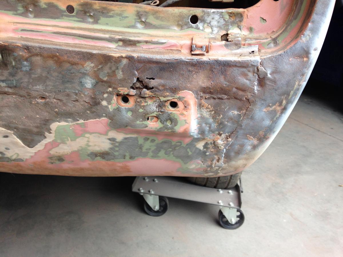

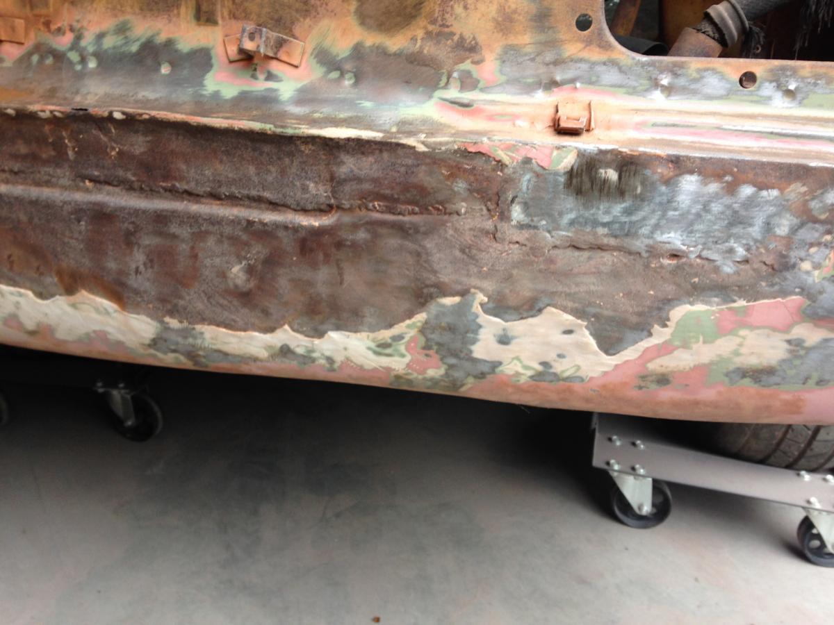

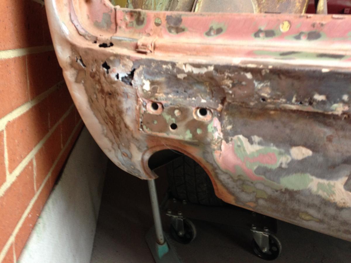

I'll attach a few shots tonight, I don't believe it is in a fixable state. I may be overreacting though.
Charlie got back to me with an excellent price and I could not be any happier with the purchase. He is a very friendly person and doesn't seem to be trying to rip anyone off, if anyone needs the lower rear valance panel, I highly recommend him.
Here they are...
Edited by Rickers, 27 April 2017 - 05:11 PM.

@Rickers, yeah that's pretty rotten, someone has had  got at repairing it before and not really done the best job. Anything can be fixed and it looks like the top half is worse than the bottom but would be a bit of fiddling about...
@Ledge, don't suppose you have any photos of the motorsport part or work required to fit it? The ones I got from Canada look like they could use a bit of English wheeling and may need a bit of trimming. Only other difference is the fact that gauge of steel is a bit thicker.
