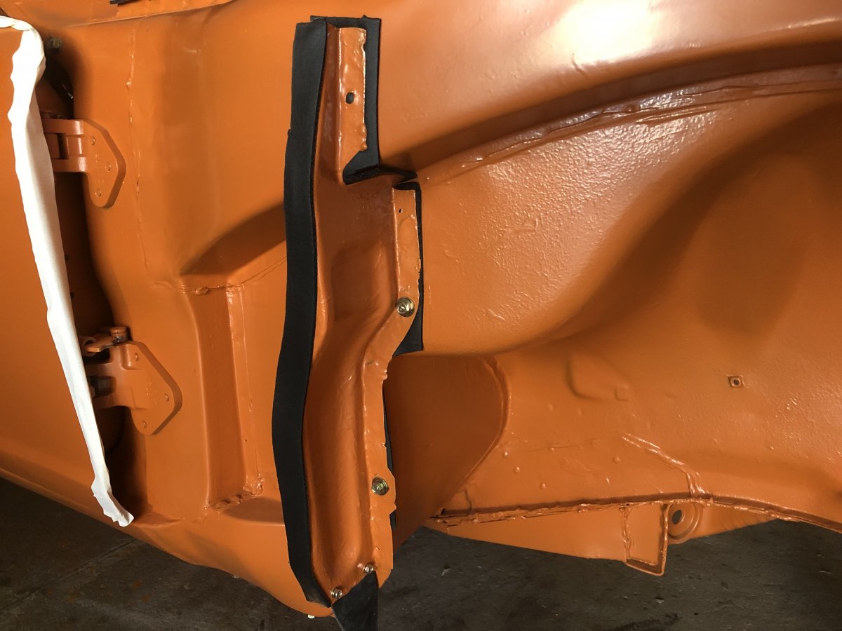

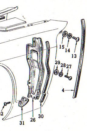

Take a look at this topic;
http://www.classiczc...-support-panel/
"The Nissan gaskets #4 and #30 are NLA and you would not want to use them anyway as they were open-cell foam that held water and contributed to the rust problems. I used 5/16 thick X 3/4 wide closed-cell foam weatherstrip for these two spots - a perfect seal when the fender was bolted up."
There is also a rubber seal that runs along the top and is held in place with clips;
These are available from suppliers such as the Z Store;
Inner Fender Weatherstrip, 70-78 240Z-260Z-280Z US $29.95 each (2 Required)
http://www.thezstore...ZS/PROD/34-1221
Inner Fender Weatherstrip Clips, 70-78 240Z-260Z-280Z US$6.10 each (12 required)
http://www.thezstore...ic03a02/40-3972

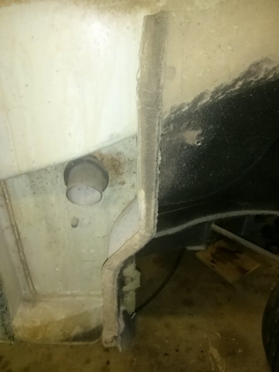

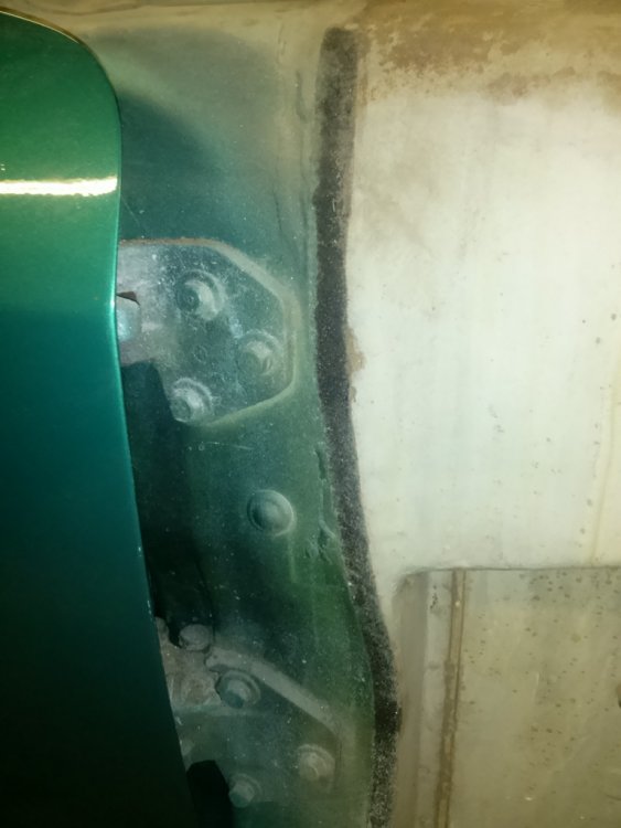

Eric you've inspired me to remove the front guards on mine to inspect beneath, first time in about 25yrs.
The foam pads on the 4 x 'table' brackets on top of the upper chassis rail are 8mm thick x 36mm wide.
The remnants of the 2 x vertical strips look to be about the same thickness.

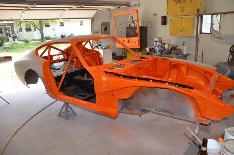

Is that your car GongZ?
I wish that it was, and I would like the garage included too please.
The photo is from "2009 240Z build";
http://forums.nicocl...403961-840.html
