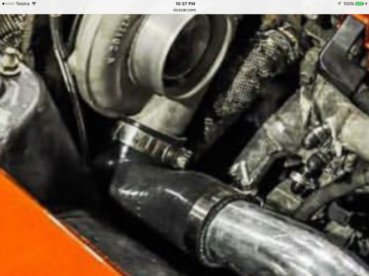

Here is a guy I follow on instagram.
He did the swap himself using a conversion from CXracing.
It makes a very tidy 550rwhp @25psi
On stock internals but unsure of turbo setup.

Look at the size of that turbo!!
Could just be the photo, but the plumbing looks restrictive - not that it would matter with a turbo that size.
