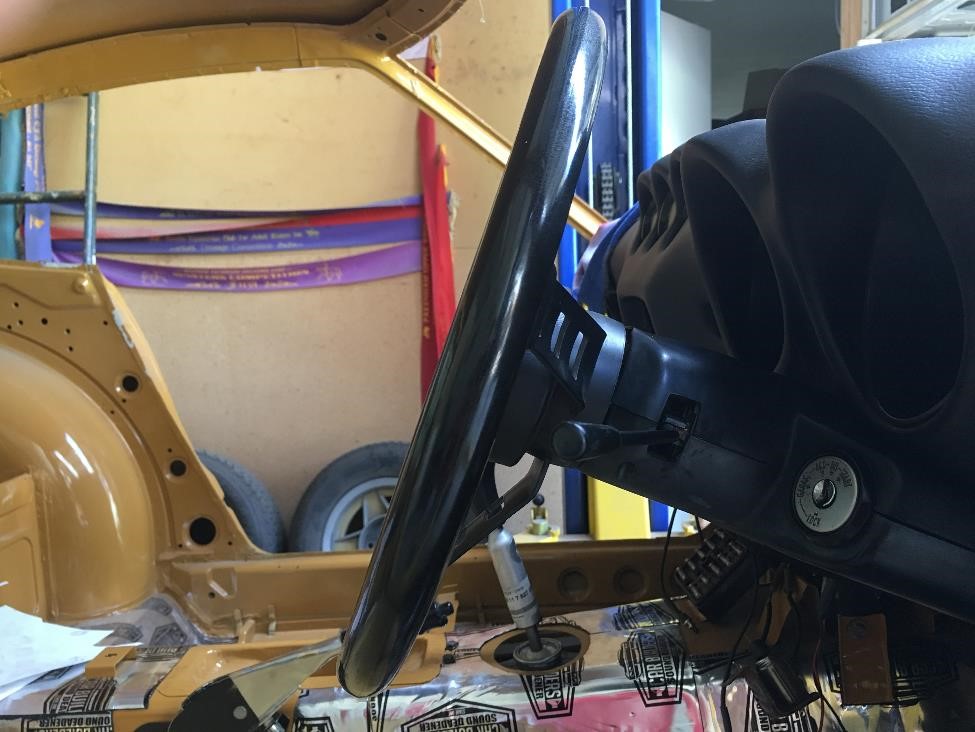

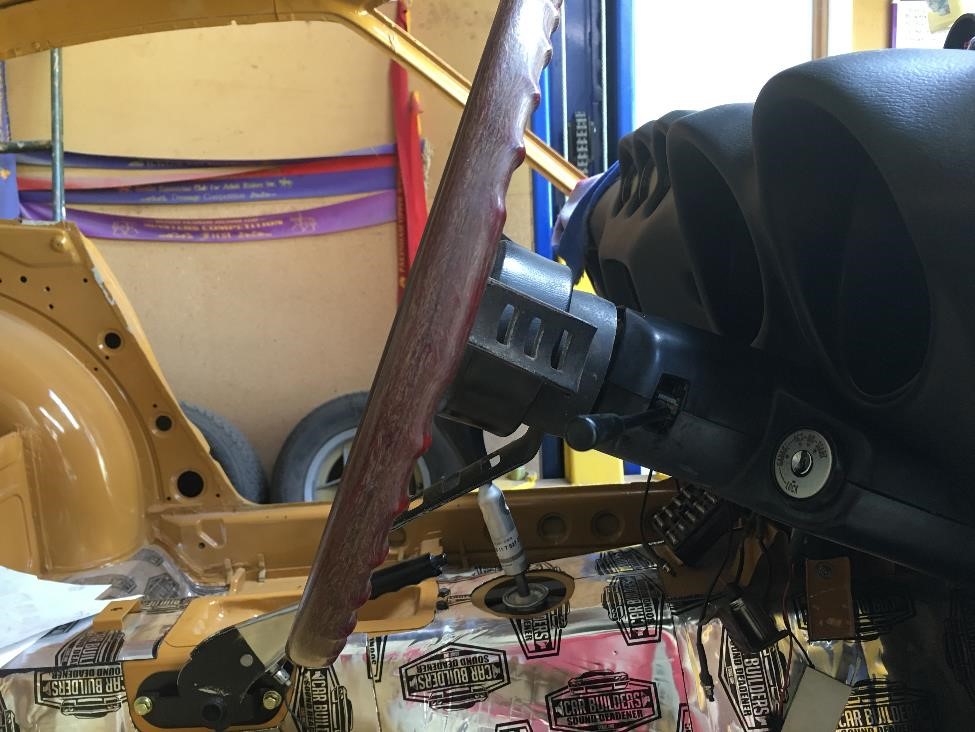

#6 KatoKid
KatoKid
  • 1,713 posts
Posted 08 March 2017 - 03:38 PM
Pics attached.....roughly twice the clearance with the standard wheel which also feels about right.

#7 Riceburner
Riceburner
  • 3,263 posts
Posted 08 March 2017 - 04:07 PM
My stalk looks a lot straighter than that, it must've been fiddled with at some point.

#9 PB260Z
PB260Z
    Peter (PB)
  • 3,292 posts
  • Location:Northern Sydney
Posted 08 March 2017 - 06:16 PM
Hi Dave
When I fitted the Compe to my Bus I too had clearence issues, but not quite as bad as in your photos.
Maybe yours has been bent forward to suit an 80's deep dish steering wheel ::)
I very carefully (and nervously) bent mine back about an inch or so.
PB
#10 HS30-H
HS30-H
  • 632 posts
  • Location:London, England, UK.
Posted 08 March 2017 - 08:35 PM
Since the 'Compe' steering wheels - made by Izumi, same manufacturer as the OEM steering wheels - were based on the Japanese market steering wheels, they have a flatter 'dish' than the Export type wheels. This can lead to the spokes being a little close to the indicator stalk, and the solution is simply to (carefully!) bend the indicator stalk back a little to give a bit more clearance.

#11 KatoKid
KatoKid
  • 1,713 posts
Posted 09 March 2017 - 06:31 AM
Thanks everyone, looks like I need to do some bending!
