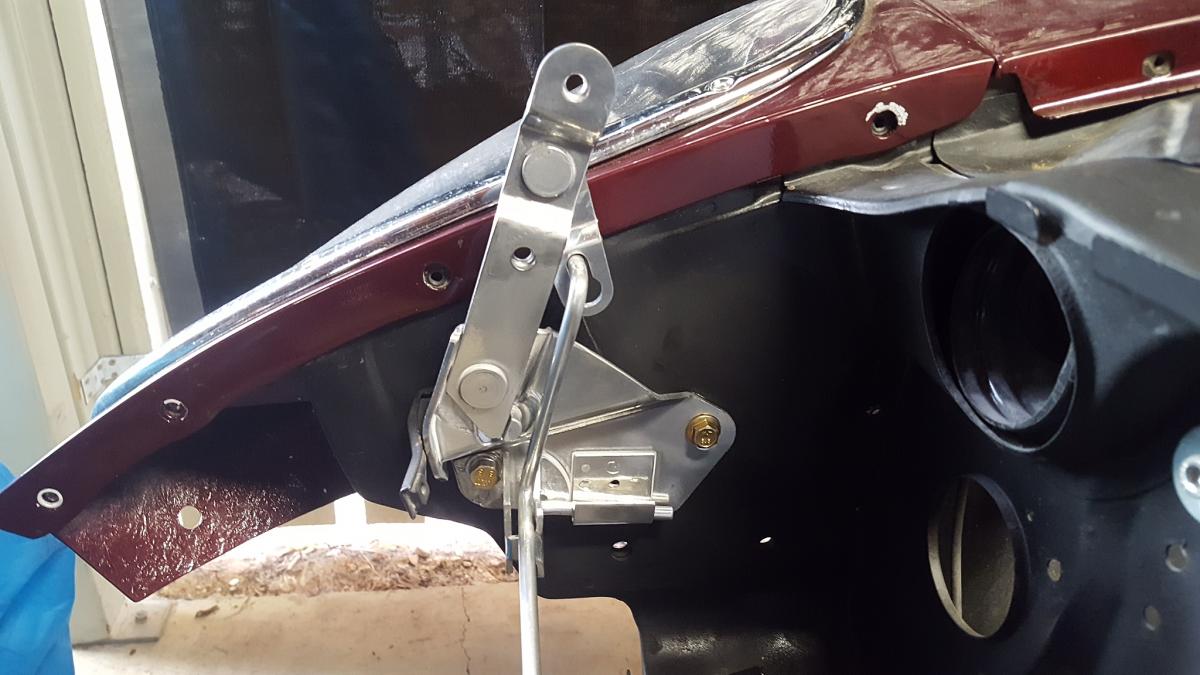

I just went through this recently too and i'm trying to remember what I did. But basically you assemble it off the car and if the front of the hinge is on your left spin it to the right after one side is bolted in the car like Retro Z said. Just make it look like my photo if you do it the other way it doesn't look right.

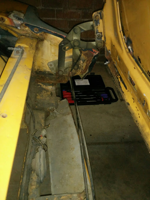

https://www.flickr.c...eposted-public/
the bottom rod is nearly 180 degrees out - i can't twist it that far

If it wasn't 180 degrees there would no be tension on the hinges in the open position...
  1. Assemble the rods and hinges off the car, yes on side will be upside down.
  2. You can leave the top button part of the rod disconnected on one side if you want to make it easier to twist
  3. Get wife to hold one side together while you bolt the side that's the right way up to the car.
  4. go to the other side, thank wife, twist hinge assembly 180 degrees towards the rear of the car
  5. Use a tool of your choice to pull the other rod into the tab.
  6. Congratulate yourself

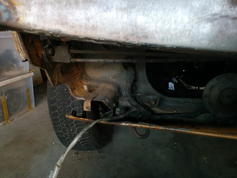

Posted 28 February 2017 - 07:08 PM
ok, got the hinges in and one rod - by combination of using my knees, hands and some rubber blocks. scratches EVERYONE, so much unhappiness all round.
now, no way i can stick it the 2nd rod by hand or with a screwdriver - has to be rotated 180 degrees also. i was thinking of using a long crowar and using some ubolts to hold the rod in place, then i can lever it in
surely someone has rigged SOMETHING for this?

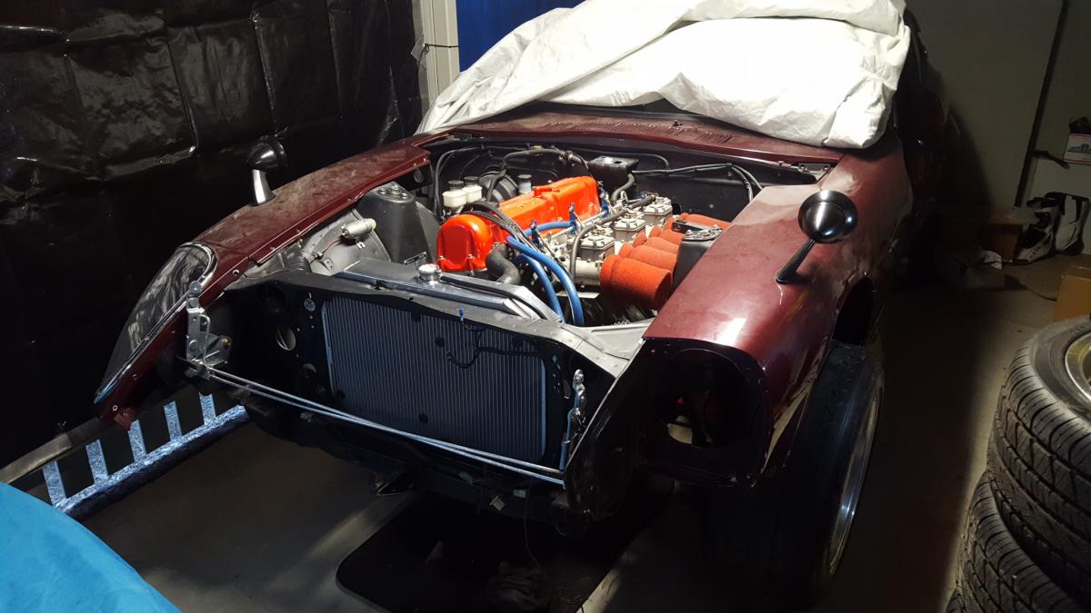

thanks all for your help - if there was a virtual beer, i would buy a round
this is how the saga ended last nite ( post mounting first hinge and first bar)
  • i ended up using a "d" shackle to steady the bottom of rod into the recepticle where it would go once in place eg parallel to the bottom bar
  • sat down in from of the car and using my bare hands rotated the rod using a weightlifting squat type of a manouver, while pushing the hinge backwards and down to meet the rod
  • slipped into the opening and bob's your uncle
you definitely needs hands and arms of steel to do it this way. i was jiggling around with straps, rope , jimmy bars, vice grips, etc
