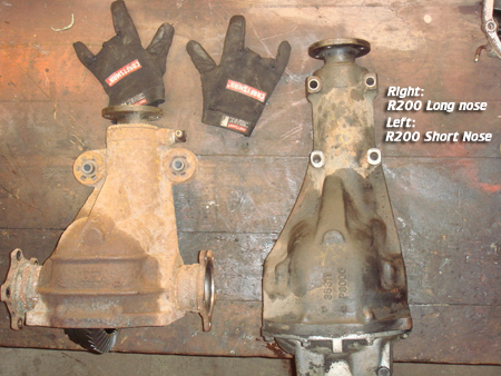

The searches I've done have come up with lots of R200's, but not many are defined as long nose or short, so I'm just going off the pics.
Can someone point me in the right direction of a thread that lets me know what models came with the short nose or the long nose?

From what I know short nose R200's started from S13's, Z32's, not sure about Skylines. Anyway from Nissan models that used the multi link type rear suspension, they used short noses, turbo Z32's did not use the R200, they used something bigger.
