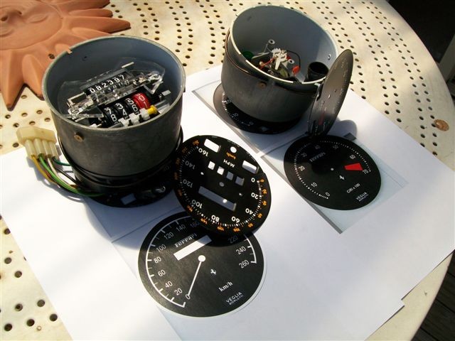

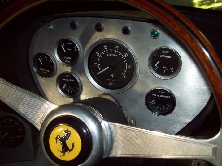

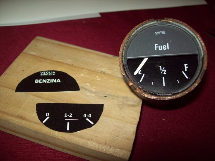

Turned my Smiths (Jaguar) gauges into Veglia (Ferrari) just using MS Word.

How on earth did you use Microsoft word to design gauges?
Professional silk screening would make them look OEM.

Crikey... Don't you young long-haired fellas know anything about computers?
Scan the original dial and import it to Word. Then just use the 'Draw Tools' to position and overlay the new text and/or images.
Take it to Officeworks and have a matt finish A4 photo sheet printed ($3). Cut out the image of the dial - ask your mum to do it if you're not yet allowed to use scissors - and then attach the cut out dial to the original dial with double sided tape.

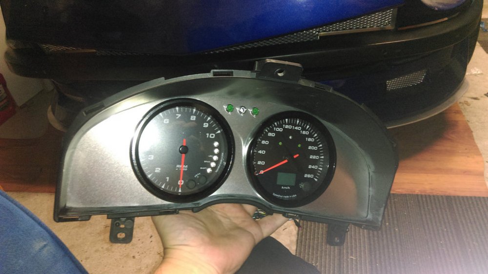

I have custom gauges too, but mines still a work in progress.
It was surprisingly hard to get a good photo, too many reflections...
