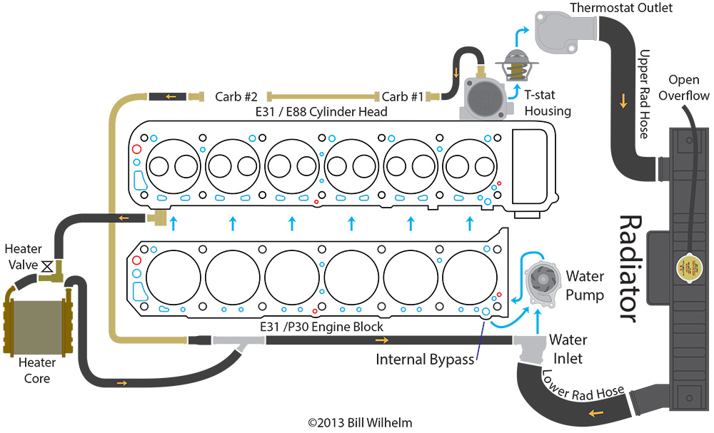

Pulled this pic from here: http://forums.hybrid...ystem-diagrams/
Might help.

My car has triple Webers and no heater so the sketch provided by Skipz doesn't really answer my situation.
I have seen pictures of some cars with the heater valve half way along the hose I wish to remove so with these I would assume that if the heater was not on there would be no flow into that fitting on the back of the head.
