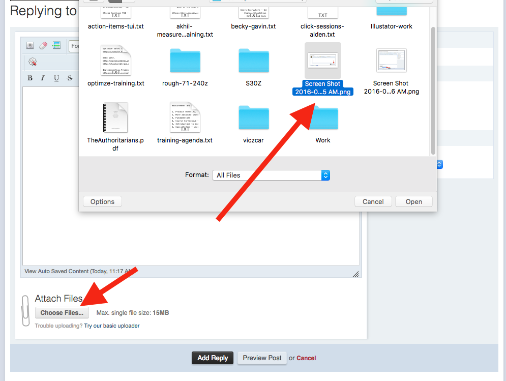

Barry I'd love to see photos, you may need to use the "More Reply Options" button at the bottom, instead of just using the quick reply post.
Also if you're using Chrome web browser, they recently started to disable Flash ahhhhhh!. So you need to right click on the area where the choose files... button usually is and enable it.
I've attached some screenshots of how to do it.
Side Note: I will need to update the forum software shortly to the latest version. I hope they have resolved it and rely on HTML5 instead of flash for the new uploader. I didn't upgrade sooner because the new version was in beta and I wanted them to iron out all the teething issues before attempting the migration.

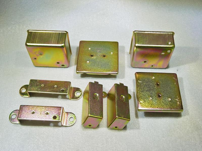

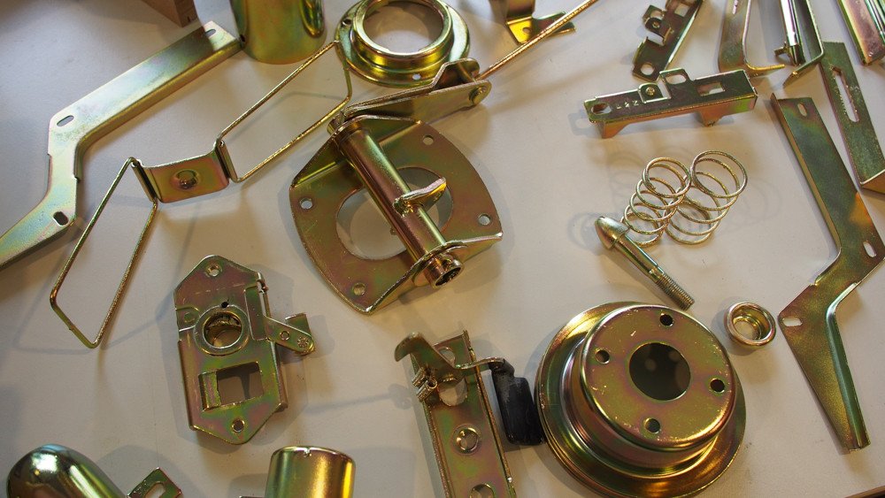

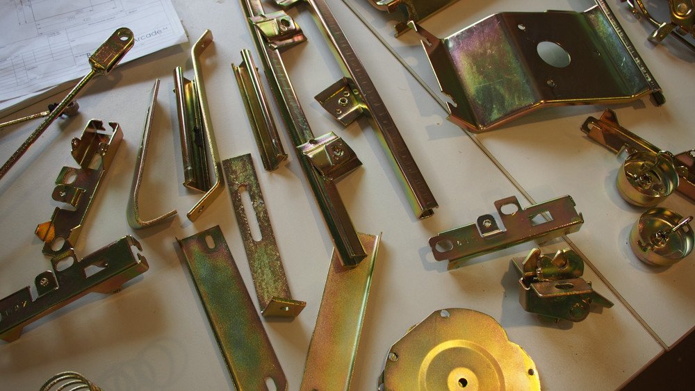

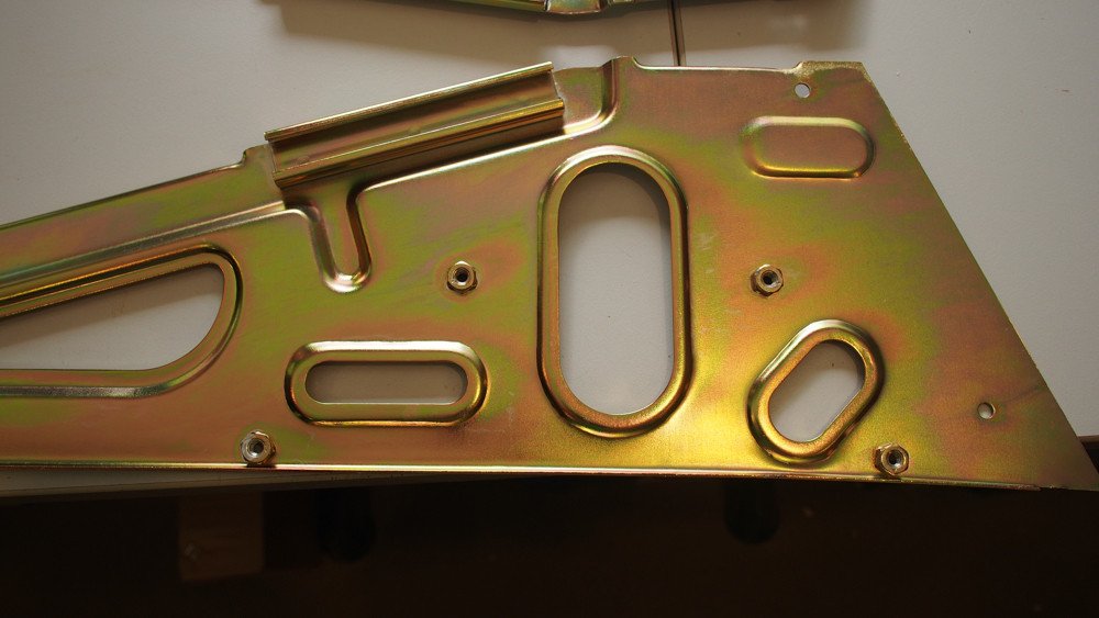

Hi Everyone,
Here is a few samples of the Chrome on steel, silver zinc and yellow zinc. Unfortunately I don't have before photos of most bits. The sun visor stems are my first attempt at chrome plating. They were very rusted before I started.They were sandblasted, wire brushed, then buffed before being plated. I'm very happy with the result although I think I can improve on it.
I think I have the zinc plating well under control. I have also had good success with the Copper, nickel, and chrome on steel. I cannot get an acceptable quality level with the chrome on plastic although Caswell maintain it can be done. I find their copper conductive paint has almost no adhesion qualities even when I used a good quality adhesion promoter. After plating it peels off. I have tried a couple of other conductive coating that worked slightly better but still not good enough.
Barry

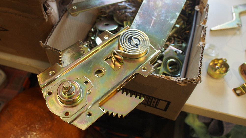

Before I sold my engineering business 4 1/2 years ago we used to get large quantities of bits zinc plated in Brisbane. They would only do silver zinc. Excellent work but on occasions they did loose parts. In some cases I think they left them in the acid wash too long and they dissolved. I have actually fitted 3 45mm DCOE Webbers to my vehicle but I am rebuilding the Hitachi's just for the experience of doing the zinc plating. I'll probably offer them up for sale when they are done.

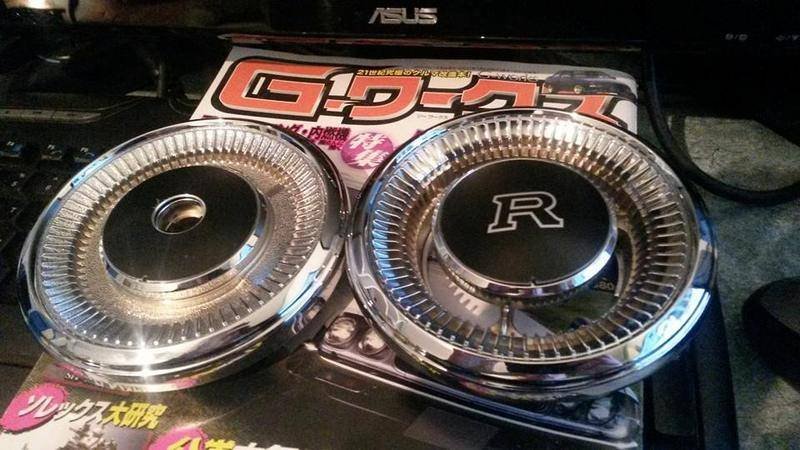

I have used A class to do plastic chroming and it came up perfect. Also cam, maye of mine used that place and he was happy with the outcome
10172599_10152343947099641_1129881691372
10264289_10152343946919641_5066613829535
  • gav240z and Yamahacam like this
