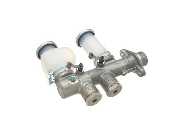

Hello Austin,
Nice looking car!
I noticed that the brake master cylinder reservoirs are in the wrong location.
Early 240Z's (1970 TO AUG 1971 - according to USA supplier http://www.new-datsu...rts-brakes.html) had a master cylinder that looked like this;
46010-e4602-240z-brake-master-cylinder.j

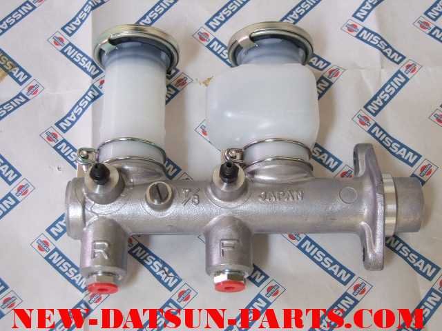

And later cars were fitted with this type;
Note that in both cases, the larger reservoir is for the front brakes.

Thanks @gongz
I will make the change when i do my brake fluid change and hopefully braided lines next time.
