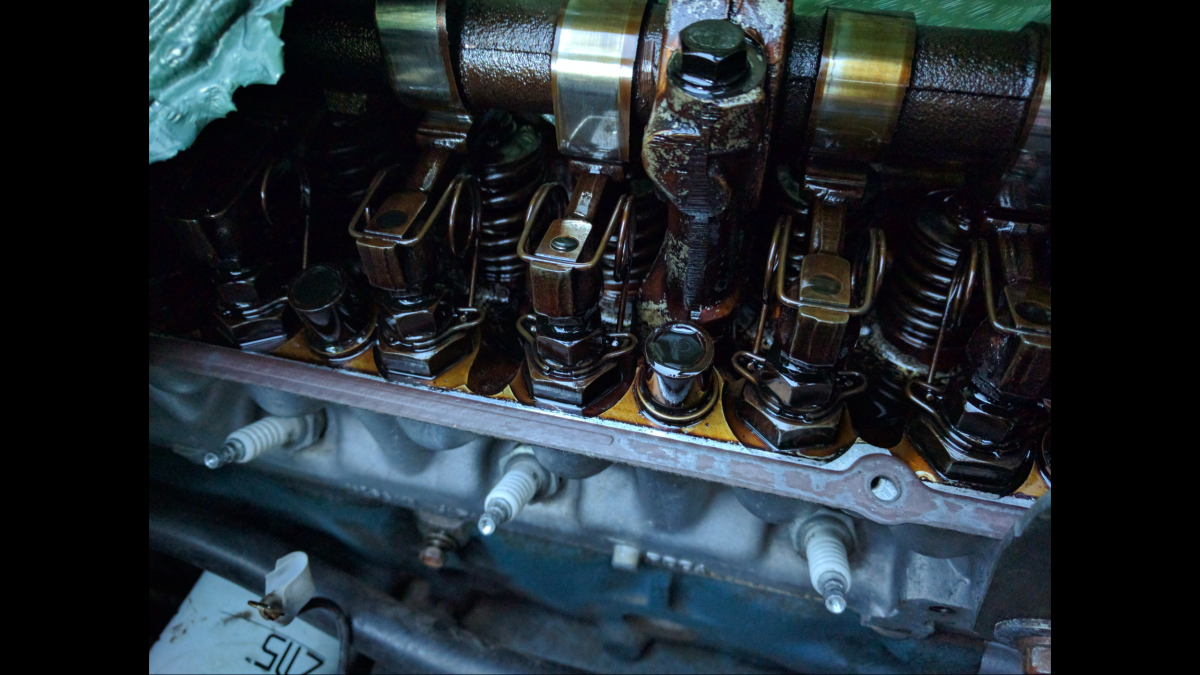

I decided to take my rocker cover of to polish and take some photos. Any ideas?

They are the regular ones. To answer your original question the P90 heads generally came with flat tops as the combustion chambers are bigger and had a lower compression ratio. It will be fine with twin SUs and will make about the same as any stock L28 depending on the condition.
