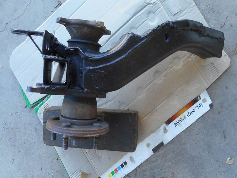

Onto the hard bit now, complete rear suspension revision where few (any?) have gone. The semi trailing arm setup is being converted to a trailing arm with lateral links system eg Gp C Bluebird, E36 BMW. The original sub frame is gone, the diff has been solidly mounted to the body, the inner legs have been cut off the suspension arms and two lateral links will run from the outer hub assemblies to a new rear diff mount setup. Lining everything up accurately and designing solutions are the tough bits, I'll let the pics do the progress talking.

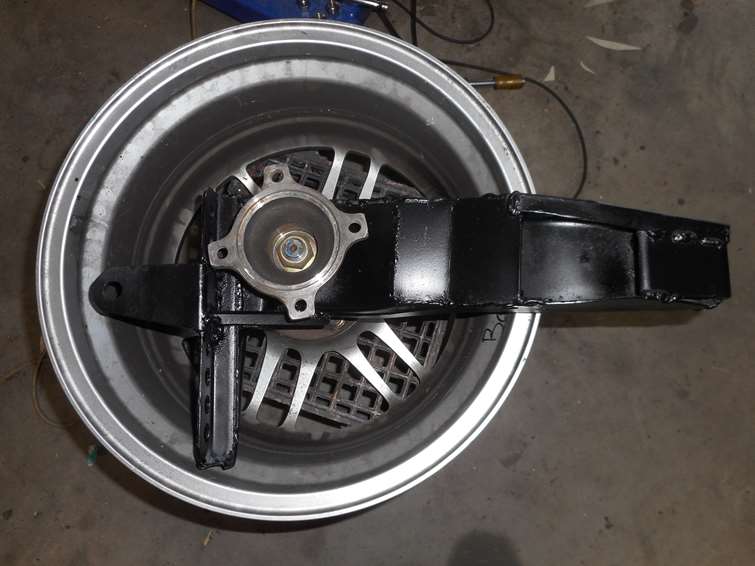

The hardest part is done, I now have a left and a right trailing arm finished. They are set up to accept two lateral links and a coilover each side all rod ended, even the coilover botton end. Work has started on chassis brackets to accept the inner lateral links ends, have some nice swaged aluminium radius rods made for speed cars of some sort which are getting modded as suitable lateral links, with L and R threaded rod ends it's all adjustable by simply rotating the links.
Could go on about the numerous design changes, fabricated parts that didn't work out, the difficulty in getting both sides the same but pfft, I know what the fans want, pics!!!!
