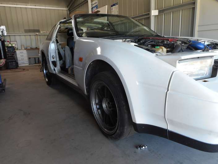

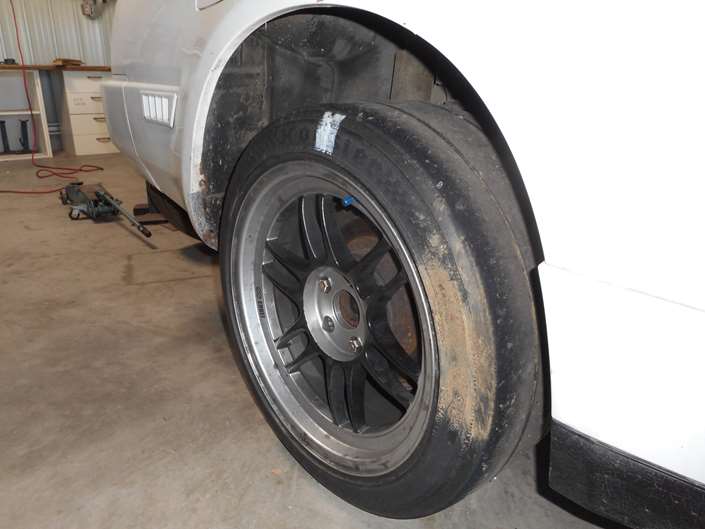

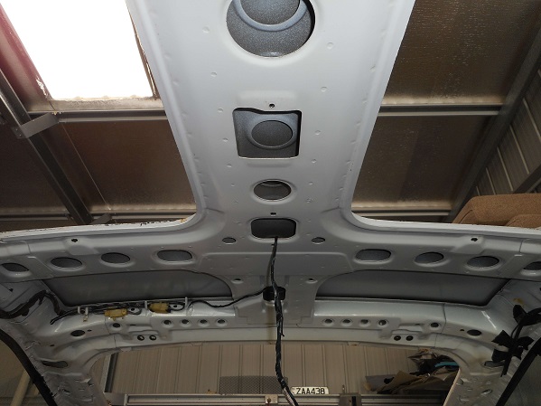

260DET Posted July 29, 2016 Posted July 29, 2016 Pics are always good so below are some taken with the engine and transmission still in which show the huge amount of space for big tyres in the wheel wells. Those are the race Hoosiers off the 280 which bolt straight up with no clearance problems, F 9" rims, R 9.5". I'm bloody rapt, so much space for bigger wheels and tyres. The project itself should start next week with filling in the T top openings and adding some structural bracing across the top of the door openings. Seeing that it's a turbo model the brakes look like they have Z32 rotors, just need some decent calipers. One thing I've learnt is that suitable brake pads are very important, proper race ones will withstand extreme temperatures and actually brake much better. Having stock rotors means that they are not expensive to replace too. The rear axles are second generation CV jointed and for the R200 diff a reasonably priced Quaife LSD centre is available. Keeping all the stock type suspension, the rear will be interesting, I have some fairly dramatic mods in mind to get the semi trailing arm setup working satisfactorily So the project is going to be stock based except for the engine and auto trans. Sirpent and ScottyB 2 Quote

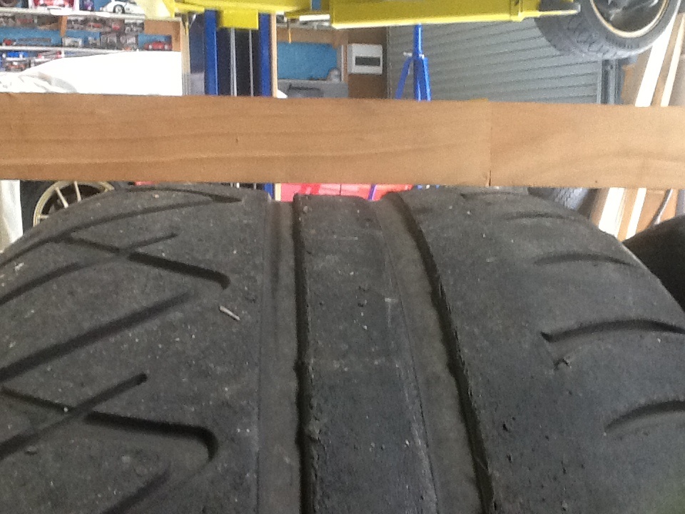

Gordo Posted August 8, 2016 Posted August 8, 2016 Kumo tires, worst track tire ever, can NOT handle the heat. I've had bad experience with them. Will never buy again. They are Cheap, and there's a good reson for that. The pic of the tyre is after about 10 minutes of racing. Quote
dat2kman Posted August 8, 2016 Posted August 8, 2016 Kumo tires, worst track tire ever, can NOT handle the heat. I've had bad experience with them. Will never buy again. They are Cheap, and there's a good reson for that. The pic of the tyre is after about 10 minutes of racing. THOSE are the cheapest crappiest fooly sic bro Kumho "sport" tyres you can get!Try some V710, or V70A , you'll change your thinking very quickly! Gordo 1 Quote
260DET Posted August 8, 2016 Author Posted August 8, 2016 Bad luck there Gordo, that would thoroughly piss you off Hankook's and Yoko's seem to be the semi of choice up here for lap times and heat cycles. There is a new semi available but only in 18" so far, Nankang's from Taiwan. Hella cheap and they work well apparently. Quote
d3c0y Posted August 9, 2016 Posted August 9, 2016 (edited) I was running KU36s due to having to have something that had a treadwear rating worse than 180 so basically road car tyres for Lemons. Gordo were those 245s 45 17s by any chance? Our 255s seem to be fine with it but went through 3 pairs of 245s and they all did the same thing... Grip from them isn't a patch on a semi, but i dont think they are marketed as such either. Edited August 9, 2016 by d3c0y Gordo 1 Quote
Gordo Posted August 9, 2016 Posted August 9, 2016 Yer guys, don't want to high jack the thread. I wasn't expecting great grip or time from them, (tires). But didn't expect them to go out of shape. Haha. Cheers. Quote

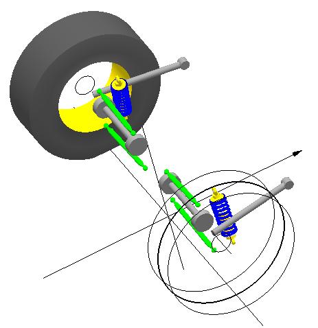

260DET Posted August 20, 2016 Author Posted August 20, 2016 Still ripping junk/weight out of it, somewhere under there is a half decent body with plenty of stiffening potential, it has enough wiring in it to connect up a small town. Anyway, besides the boring stuff I've been thinking and researching interesting things, like what mods to do to the dreaded semi trailing arm suspension. It could be modded the usual ways but where is the fun in that? So how about copying the Group C Bluebird arrangement which itself was derived from the OE semi trailing arm setup. What is that I hear you ask? Susprog representation below. Quote
dat2kman Posted August 20, 2016 Posted August 20, 2016 Why dont you just leave it all as is, build it up, go and play in it, then see what it needs, to get it better. The USA SCCA and old GT boys are all over how and what to do. She aint rocket science, unless you wanna play Space Cadet, and go shooting off into orbit! Quote
260DET Posted August 20, 2016 Author Posted August 20, 2016 (edited) Jason, the best STA suspension mods I've seen are made here in AU for 1600's, there is not a lot available in the US for the Z31 that changes the operation of the suspension like is available for P cars and BMW's. There is no rush for this build so I want to get everything sorted as much as possible, I hate doing fabrication mods after a car is built too, build it properly in the first place so that the basics are right and only bolt on stuff is maybe required later, like say a brake upgrade. Edited August 20, 2016 by 260DET Quote
