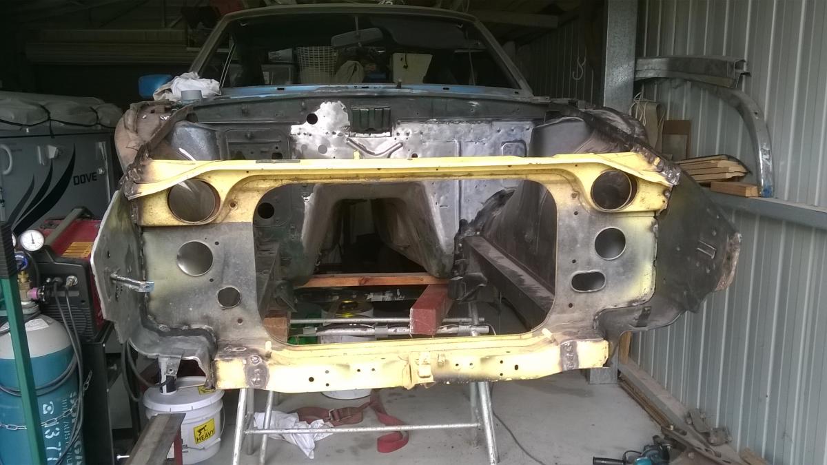

my radiator frame and rails were so far gone from rust that the frame .. just fell out
now life is looking up, the rails are fixed, the frame repaired, but i just don't know how it goes on
from what i can tell, the opening in the back of the frame is narrower then the width of the rail
http://www.vord.net/...-rail-large.jpg
so it doesn't fit
second question is: how is the frame attached to the rail ? 4 welds at the top, 4 at bottom and two verticals on the front to secure the tab?

Hopefully this picture may help. You can see where the spot welds were completely drilled out. I have some more pics at home that show the other side, can post tonight if you need/want. Cheers Jeff

Posted 21 July 2016 - 09:33 PM
I haven't got a pic from the back of the rad support, however I have attached some more pics from when I fitted my new rust free rad support. I fitted it just like Nat0 explained. I hope these pics help. at the rear there is just 2 small seam welds, one where the panel meets the top of the frame rail and one where the panel meets the side of the rail. In the first pic you can see the remnants of the factory weld on the side of the chassis rail.
Cheers Jeff
