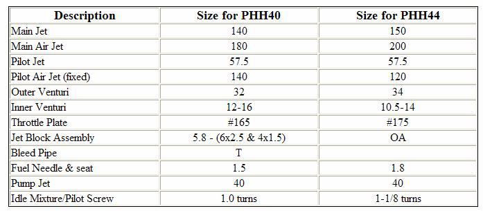

Factory standard for the 44's on a 2.4 are,

Oh look,
So close to the chart above!
