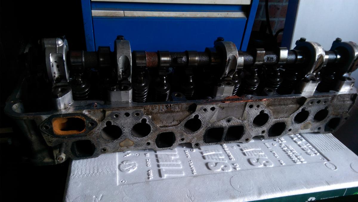

Pulled the head off over the weekend..
Appears to be in quite good condition but I'm yet to take an measurements.

Looks good from the pics, would be keen for some measurements as ive also got this head and i think mines ported but im not 100%

Posted 28 June 2016 - 09:45 AM
Sure,if there's anything specific let me know..

Just a measurement of the ports, even a photo inside the ports would be awsome.

Hi 240z71,
Mine is standard at the moment but the intake ports I guess are the ones your interested in and they are 35-36mm diameter.
From what I have been reading and obviously depends where and what you read but there are calculations to work out port size for a certain displacement but also for valve size as from what they say no point having huge ports with lower air velocity when the valve size is the restriction.
The book I have been reading says for the intake ports must not be more than 0.82 of the valve size, so with 44mm valves the ports should be 36mm and looks like Nissan knows that too as that's what they are. I know there will be people who don't agree and I guess I'm one of them to a degree but with this head I'm going to try it and follow what they are saying.
