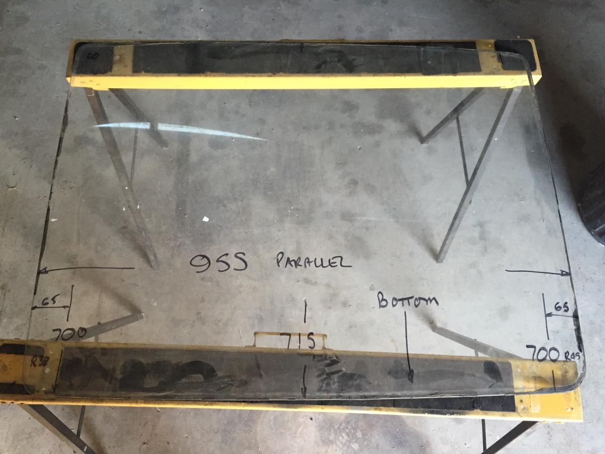

#14 PeterH
PeterH
  • 237 posts
  • Location:Northern NSW
Posted 19 May 2016 - 04:33 PM
What's  the time where you are George ??? tooth hurty ?? sorry.
Is this info any good for a start
Top of glass is straight, sides are parallel , the corner radius varies ( not sure if the glass is genuine or after market ) bottom right R45 bottom left R38 top both sides R20.
Should be able to read the sizes from the photo. The outside vertical dimensions are measured at 65mm form outer edges. all dimensions are in millimeters.
can't help with measurement inside the rubber at the moment.

Posted 30 May 2016 - 05:39 PM
Excellent, time to bomb George's inbox with requests for measurements! :). Since he has an OEM glass to take measurements from.
First strip starts 19 cm in from the edge and each one is 3 cm apart.
