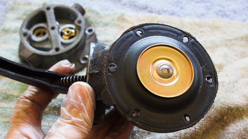

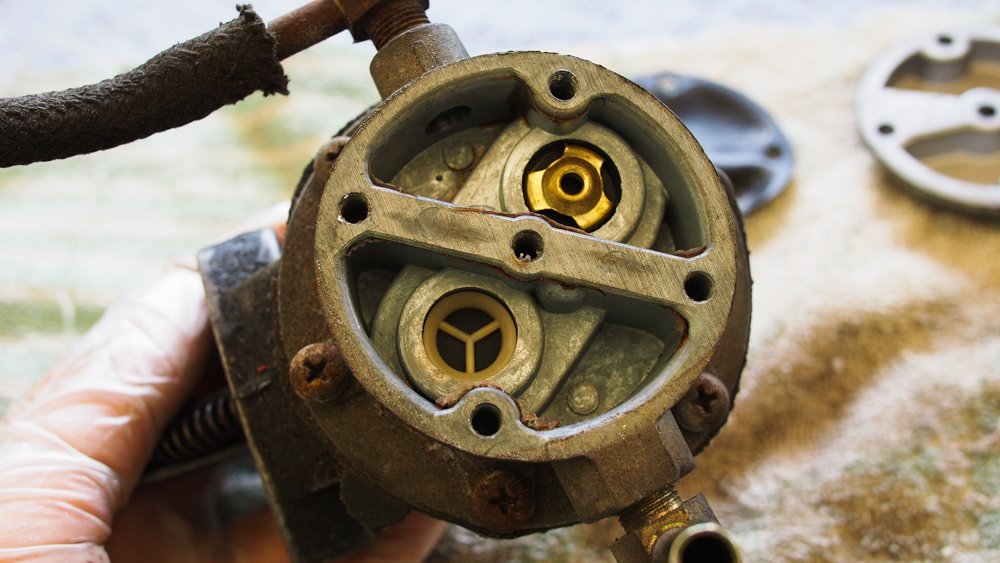

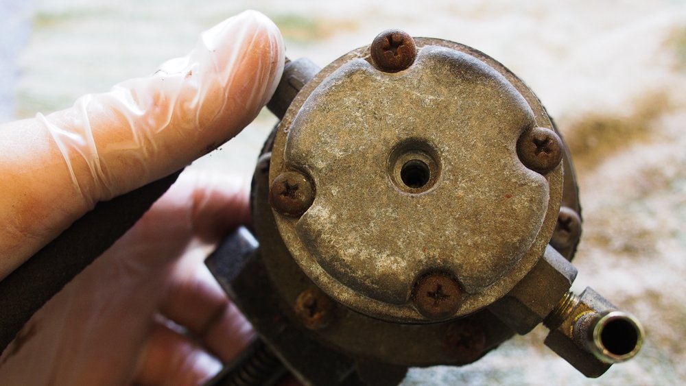

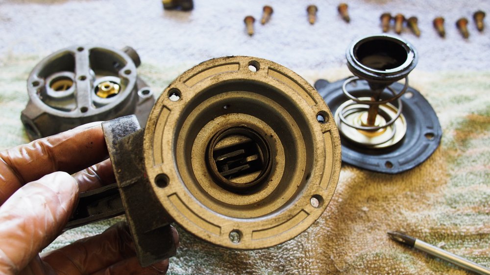

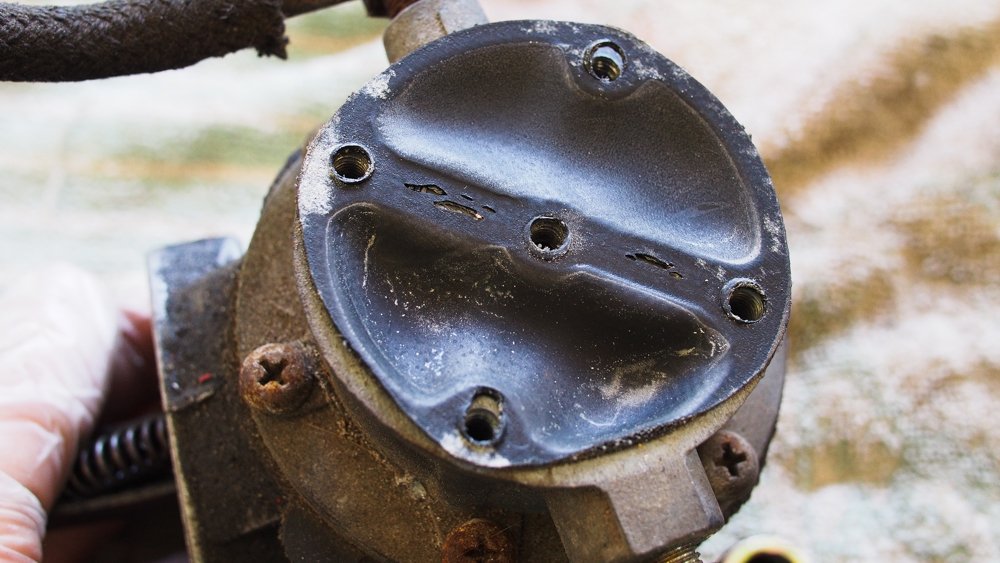

Posted 28 April 2016 - 01:36 PM
George - Been abit of a learning exercise, first carbie vehicle. May revist the fuel pump as i believe they have a filter inside (correct me if im wrong)?
All you need is a Phillips #2 screwdriver. Give it a go, it's dead easy.
Check for cracks as per photo #2 and other gunk. Clean everything and replace filters/diaphragm if necessary. Careful with the filters though as some types are secured to the cast making it impossible to replace. You most likely will not need to replace them - just a good clean with an air compressor.
