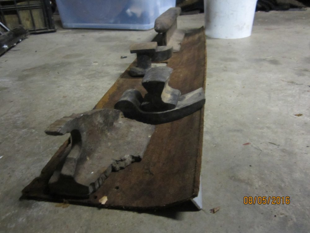

Posted 08 May 2016 - 06:56 PM
OK. I've answered my own question. From the old roof and the shape of the rear light roof strut I could see the panel was meant to be curved on one side.
I tried to make a replacement out of 3 mm Kraftwood by soaking in water and bending to suit but it came out weak and  out of shape.
I reasoned that if the old panel was put out of shape by water, why not try and use water to put it back into shape.
I soaked the lower part that was meant to be flat in water for 1/2 hr
Then placed it on a flat surface with weights to level out the bumps.
It has returned to its "proper" shape and when totally dry I plan to coat the back with some fiberglass resin to keep it's proper shape.
I'm quite pleased with being able to reclaim this original piece as it was in a horrible shape to begin with.
The thin foam coating will be replaced with the 2mm floor underlay foam recommended in another post.

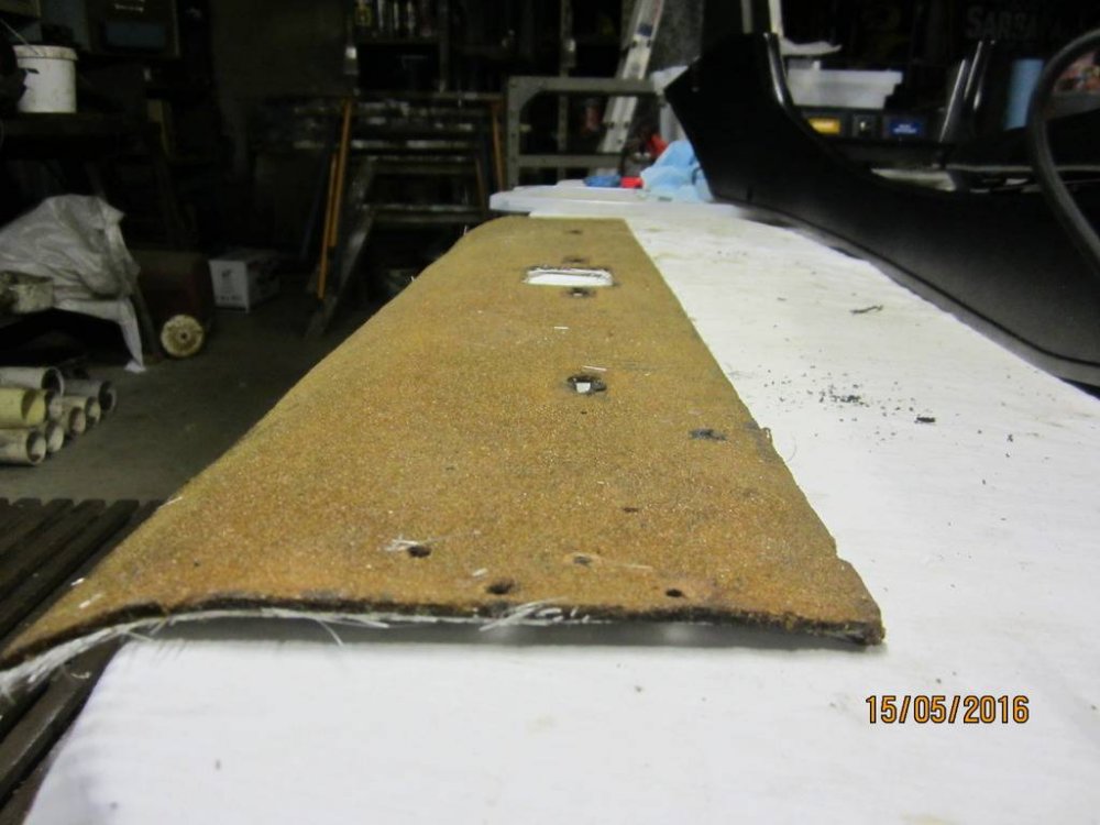

Posted 15 May 2016 - 07:48 PM
The recovery of the panel is almost complete. I managed to flatten it out again and have fiberglassed it from behind to give it strength and water resistance.
Here it is flat.

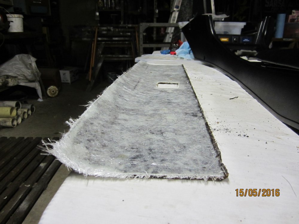

And
Fiberglassed from behind. I just need to smooth the edges before I replace the end fittings and recover it.
