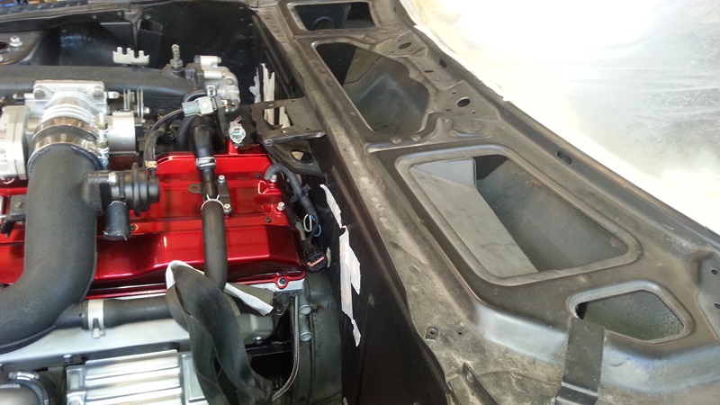

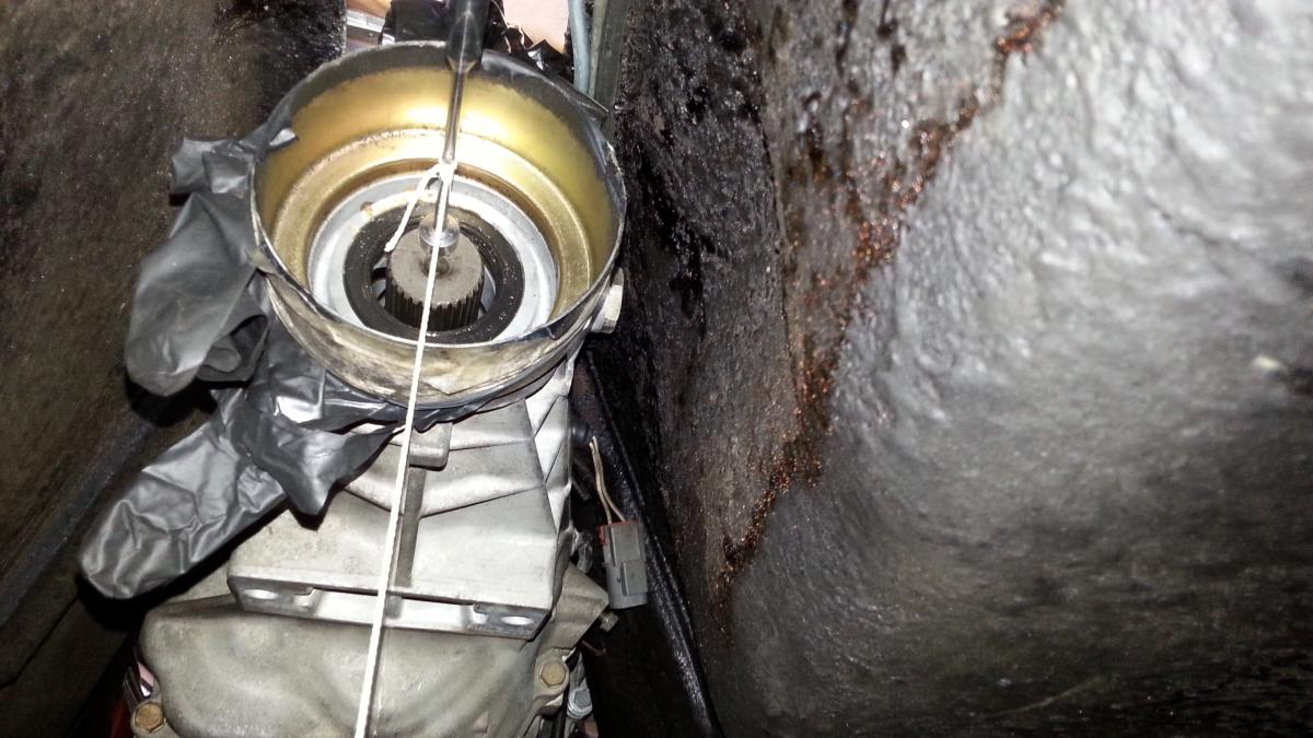

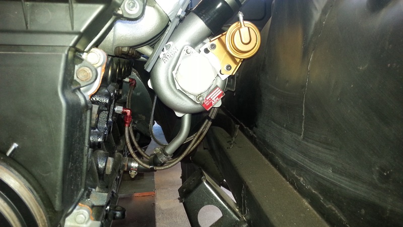

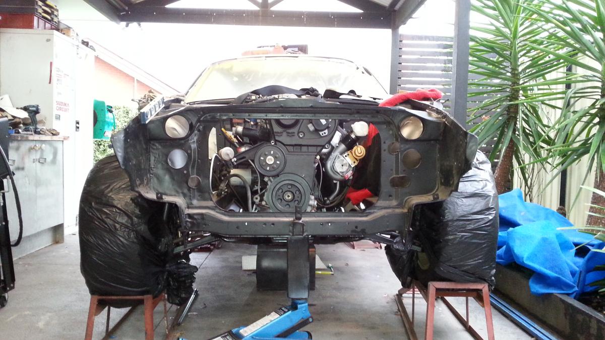

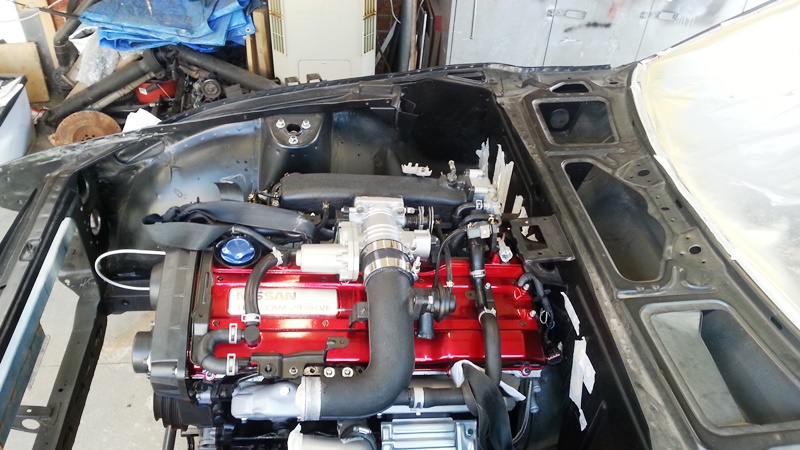

So finally, almost 6 years into the worlds slowest zed build, I have the RB sitting in the bay of my '74 2+2!
Not a fan of the conversion kits I've seen that use round poly bushes (eg. CX racing)... would like more damping than that, hence I'd like to use the original R34 RB25DET mounts (or something OEM) combined with a custom bracket.  Same with the gearbox (R33 turbo 5-speed).
I'm handy with metalwork so the actual fabrication isn't a problem.  But I'm stuck with getting the motor and gearbox sitting in the right position and on the right angle (relative to the diff, an R200 longnose).  Currently the motor is just sitting on a strip of timber on the crossmember (temporary hack job rear bowl sump fitted while I mod the RB one to clear the crossmember), while the rear of the gearbox sits on blocks. Plan was to jimmy, shim and nudge the whole shooting match up down, left right, etc until it was in the right spot, take measurements, and fabricate the mounts to keep it in that position.
I've done a little reading on how to get the angles right (eg. http://www.rustynuts...m/driveline.htm) but I'm curious to see how others here have done it, specifically with an S30.
Things I'd love to find out if you've done an RB conversion:
- How high above the crossmember is the bottom of your block at each side?
- How high does the rear of the gearbox sit relative to the top of the tunnel?
- Is your shifter sitting in the middle off the opening in the left-right axis? (which places it offset towards the drivers side, since the opening isn't centered, nor is the diff, they're both more towards the drivers side, making me think the crankshaft has to be too?)
- Any other measurements that might help?  Eg. from the side of the block to the chassis rail?
Realise I'm asking a lot - but if anyone's willing to spend some time with a tape measure, I'll do a write up with mount drawings, etc, and make a donation to the site (actually I'll prob do that anyway since it's been a while since I have ;-) )
Any other info appreciated also - eg. problems you had down the line due to misalignment, experience with existing kits, etc, etc.
Cheers!!! :)

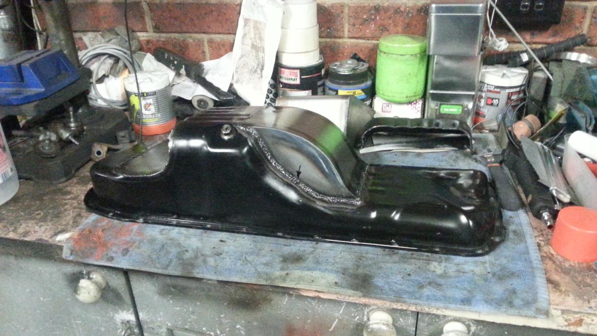

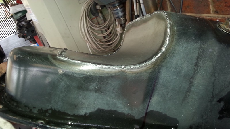

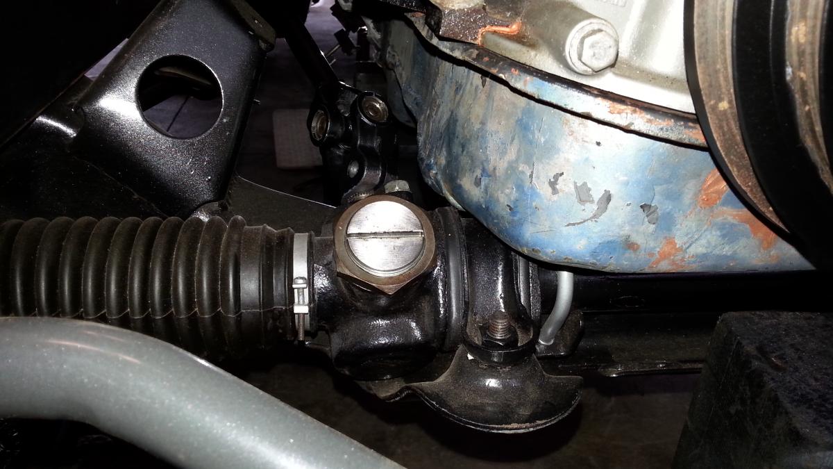

Meanwhile, here's my progress so far, with the custom sump mods.

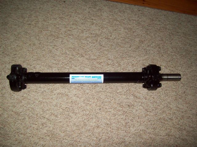

This will probably just confuse your decision-making even further but I'll post it anyway.
The John's Cars Inc (JCI) mounts from Texas are the most popular LS1 engine swap. They actually sit the engine 25mm offset to our driver's side. JCI has never offered an explanation why this is so. Some have speculated it is to offset the weight of the driver in a LHD car and others suggest it simply allowed for the best fit overall.
By coincidence when I installed the Holden LSD diff the input shaft is 20mm offset to our driver's side which creates an almost perfect sideways alignment with the LS1 gearbox output. I made the gearbox and diff mounts angled on the vertical plane to further ensure alignment. As a result I used Jurid couplings (rubber coupling) from the VZ SS Ute donor car on both ends of the tailshaft.
Prior to going down this path I discussed this concept with a genuine drivetrain guru (Ford research engineer) and he stated the Jurid couplings were good if the compound angle of the tailshaft didn't exceed 4 degrees, i.e. offset on the 'x' axis and the 'y' axis combined didn't exceed 4 degrees.
So, if you are struggling to get enough angle on the unis to avoid brindling you might want to consider actually straightening out the alignment and fitting Jurid couplings. Arr... the joys of hybrid builds!

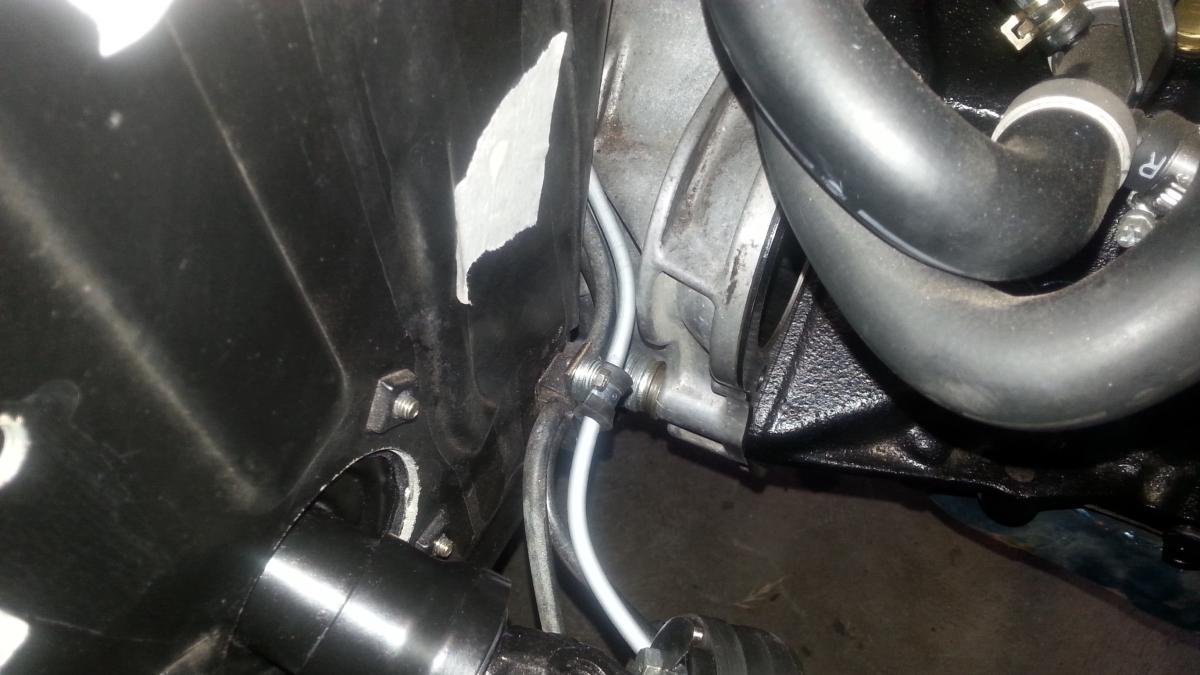

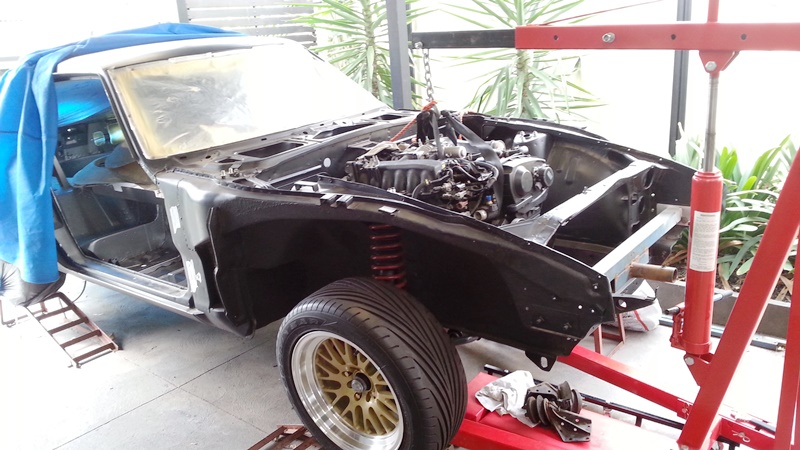

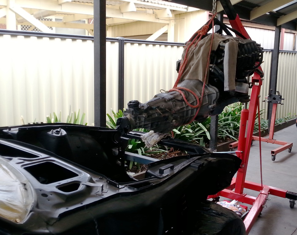

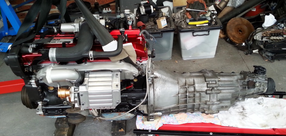

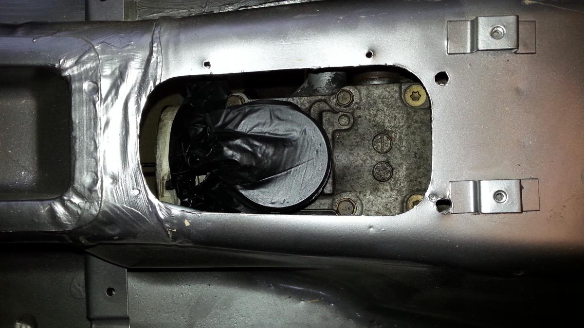

The snag Ive hit today when attempting again to get it all sitting right, was when I tried matching the engine/gearbox left/right offset with that of the diff input shaft. I found the diff to be about 25mm offset towards the drivers side. But if I move the crank and gearbox outout shaft over that far(with the engine tilted correctly), the gearbox hits the tunnel (speed sender removed) and the engine looks too close to the steering shaft. Amd the bellhousing hits the fuel lines. See attached pics. Any ideas on this? I noticed the shifter cutout in the tunnel is only offset 10mm despite the diff input being 25mm over... perhaps the crank should only be offset by 10mm?
