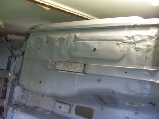

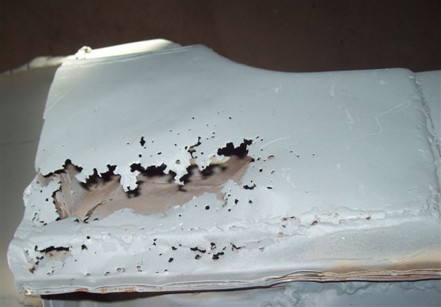

josiah Posted March 11, 2016 Author Share Posted March 11, 2016 Hi Gav, I was looking at soda/dustless blasting, I understand they're a lot less damaging to the thin metal than sandblasting. I've attached a couple of photos of the rust damage, this is pretty much the extend of it. With manual stripping, is it better to go with sanding? Or go down the chemical route with stripper. Quote Link to comment Share on other sites More sharing options...

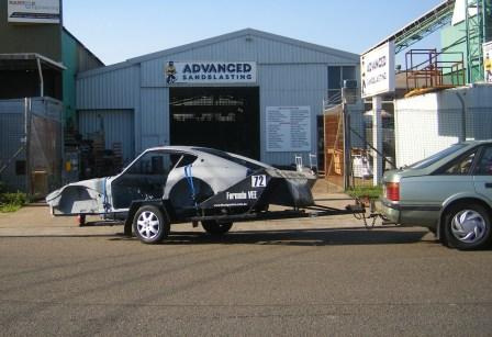

PeterAllen Posted March 11, 2016 Share Posted March 11, 2016 Advanced Sandblasting at Brookvale did mine and I was delighted with their work. It is some of the best value for your time/money you will spend and it really is the correct approach at the start of a project. If you'll forgive the pun, it kinda draws a line in the sand on the work required for the whole project. One of the major advantages of a professional service is they prime the shell immediately after blasting to prevent further corrosion. I had mine in primer for the best part of 5-6 years with no dramas. Groundhog 1 Quote Link to comment Share on other sites More sharing options...
PeterAllen Posted March 11, 2016 Share Posted March 11, 2016 ... the rust damage, this is pretty much the extend of it. ... Ha,ha,ha,ha... Great sense of humour you have josiah Quote Link to comment Share on other sites More sharing options...

Brabham Posted April 19, 2016 Share Posted April 19, 2016 Soda does not remove rust, it only removes paint. If you don't want to do a full ground-up resto you could repair those isolated sections of rust. For doing this, I find a crumpet wheel (clean n strip wheel) works best. Just make sure you move around and don't put too much heat into an area removing paint. Paint stripper is a messy job, and I tend to steer clear of it. I have also used advanced at Brookvale for hanging panels, and have been very happy with their work. If you want to leave it for a long time get them to put it in epoxy primer rather than etch primer. Quote Link to comment Share on other sites More sharing options...
