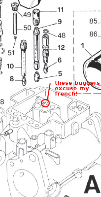

thanks mick 74 ... you got it one. I have dhla 40H 's with fixed air bleed ( the guys at the shop are calling it an idle air corrector which is where i got confused cos i know they can be taken out etc ) . I have attached a diagram from eurocarb of the area i am talking about. I really have trouble describing what i mean but i reckon mick74 has it.
The air bleed hole must be at least 4 mm i could put a blue pen nib ( metal part ) all the way down. The guys at the shop have never seen holes that large and they have never needed to work on that section of a dellorto before.
The consensus was that either a lead plug would be rammed down the tube and then drilled out or ARALDITE  over the hole and then drilled out. Seems odd but must be the way.

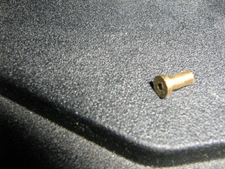

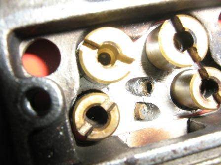

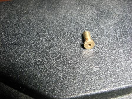

I hope this helps.
Slightly worked L26
Idle jet size = 55 (0.55 mm) , Air bleed resize = 0.9mm
Main jet size = 125 (1.25 mm ), Air corrector 240 , Emulsion tube 7772.6
Photos are of the Air bleed with and without insert , the insert has a collar on the top for easy removal and also that you cannot over insert, bore is 2.2mm for the air bleed (main body of carb) . This was done like this so that it can be resoldered and redrilled if necessary.
