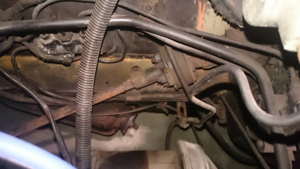

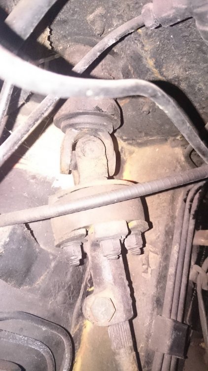

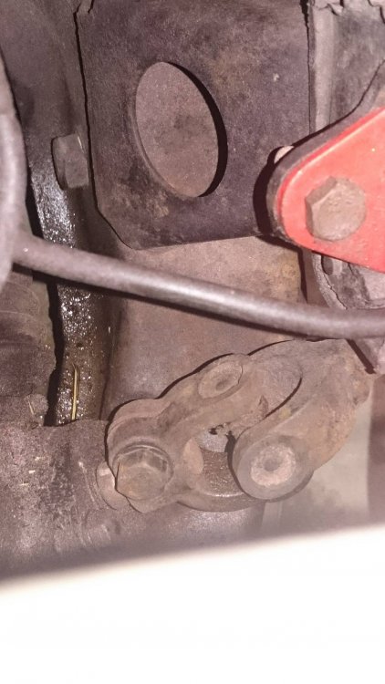

Hi Guys
I've been trying to search for info on replacing a 260z steering uni joint..
I've been on the phone to SW Motorsports who have been helpful but I have been informed that my type is not servicable but they can make a few calls to see what they can do.
Has anyone gone through the task of replacing one and could explain to me in more detail what the differences are between these and if I can fit one from another model??
Here are some pics to assist.
Any further info would be great.
Thanks

The top rubber nsulator is available.
The uni at bottom is a clamp/bolt on one side, and a factory welded onto uni fork on other side.
I've had a few bent/twisted ones repaired, by a lcal machine shop.
We just picked the tightest condition bottom uni and used that.
You sure you dont have an issue elsewhere? As the unis in the steering are a very robust, difficult to wear out item!

These uni joints are not available here in Australia and are not a serviceable product. I tried getting mine apart once totally stuffed them. Lucky for me I found a guy with a few spare steering rods. ;D

It's just a 10mm Uni-Joint - I bought one from my local bearing supplier & fitted it myself. Nothing special.

Are we talking the same rod unit here, all apart from this unit is serviceable I believe.
#7 Lurch ™
Lurch ™
  • 5,662 posts
  • Location:Victoria
Posted 09 February 2016 - 07:54 PM
Yes.
Otherwise I wouldn't have posted saying so!
My Zed is at the shop atm with the replaced UJ in the steering shaft, otherwise I'd take a photo for you.
If you don't believe me, send me your shaft, I'll repair it, & send it back to you :)
