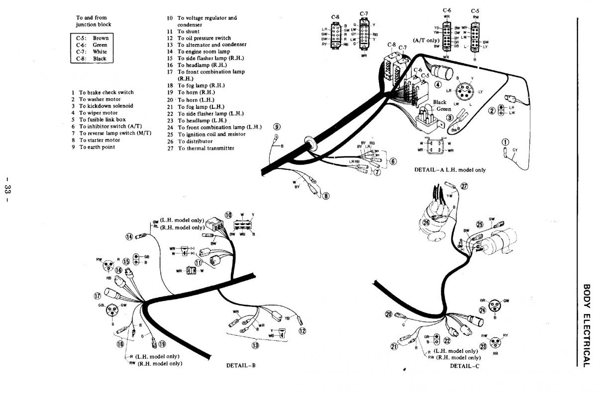

.These diagrams may assist as well :
Also in a PDF : Attached File  260z74.pdf   84.83KB   13 downloads
Edited by AndBir, 16 October 2017 - 04:36 PM.

Thanks,that's perfect
