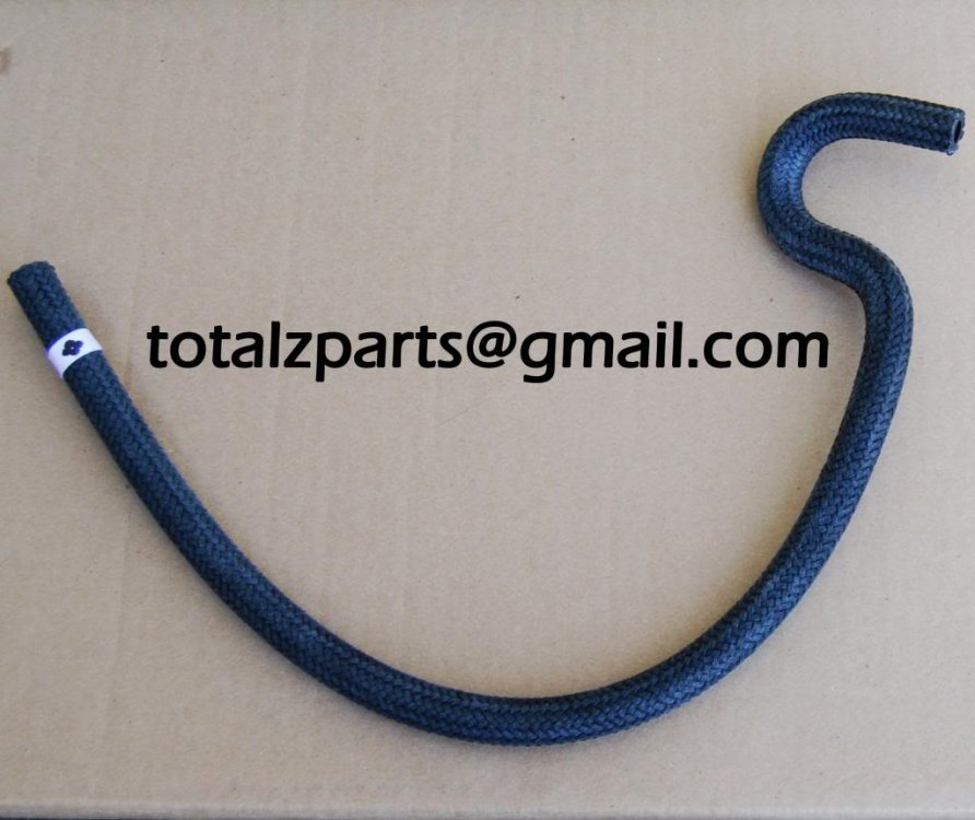

Hey Guys,
Just rang Nissan and the fuel tank vent line is no longer available. Has anyone tackled this recently on their car?

Wrong one i think Mossy, that is for the american cars with a Vapor tank,
http://www.viczcar.c...tilation-hoses/

Ok, I was just going by the pic jake posted, i thought it was the same. I'm sure I used one of these hoses on my 71 zed though.

My bad the one in the pic above is the wrong one. Nissan part number for RHD one is 17235-E4101 for reference.
