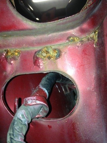

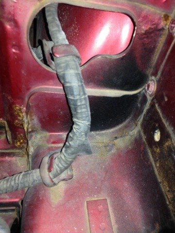

Hi Guys, just want to get an opinion on the rust in the pics.
It's located at the front of the engine bay, 2 picture show either side of the rust
This is a car I'm thinking about purchasing and while I'm quite good with the mechanical side of things my knowledge of body repairs is still on the light side.
Ideally I would like to know if this an easy fix for a panel beater or require me sourcing a front end and replacing the whole lot but any info would be greatly appreciated.
Thanks

thats' not the end of the world, but definitely look at the problem areas and think about the areas on the underbody you cant see that may have lead to rust in these areas.

Meh, that's easily fixed.

These cars rust from the inside out, so I'd be more worried about the areas you can't see than the ones that stand out like this.

Hey mate, I had rust there in my 260 and it turned out to be a massive problem (Now sorta fixed) Check out my thread here to see what the issues were.
http://www.viczcar.c...ple-260z/page-5
If it is as bad as mine was I would probably suggest just getting new frame rails. I spent too much time bodging mine up and although it is strong in the eyes of the law it's still modifying your frame. Hopefully it's not too bad however I would strongly suggest taking off your tow points to get a good look
