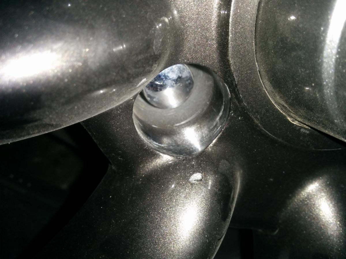

Yeah, they did a good job with the wheel alignment however I've just realised that my two front wheels have been pretty badly knocked up by them taking them off and putting them back on. They were in near perfect condition except for a tiny bit of gutter rash on one of them
What do you think?
They are chipped like this on each side of the lugnut on every lugnut of both front wheels as well as stacks of paint worn off the back. I took the car back this morning but apparently that's what happens when they get taken off and balanced "unfortunately the machine has to clamp down on the wheels" overall I'm really unhappy with the service and most likely won't be taking the car back there
Andrew

I don't believe that, you should be able to balance wheels without damaging them badly. This is the problem with cowboys that run tyre shops.
  • Andrew_L26 likes this

Yeah I'm pretty annoyed about it especially considering the amount of effort me and another member went to getting them down to Melbourne, now I have these annoying chips beside EVERY lugnut + some decent gutter rash looking scuffs. Perhaps I will be able to get some touch up paint, a few of them have actually spider webbed out and more paint is chipping off.

Hi
Man that sucks !
The chips around the lug nuts look to me like they were caused by not taking enough care when putting the rattle gun the nuts.
The scratches on lips, yes the alignment jig clamps onto that part of the wheel, but if placed carefully and not over tightened should cause damage.
In my opinion the problem is not enough care, or as Gav says "cowboys"
If the shop is part of a chain, contact head office and lodge a written complaint. Unlikely they will do anything but can't hurt to try.
I would also leave appropriate and polite reviews on various social media pages.
PB
