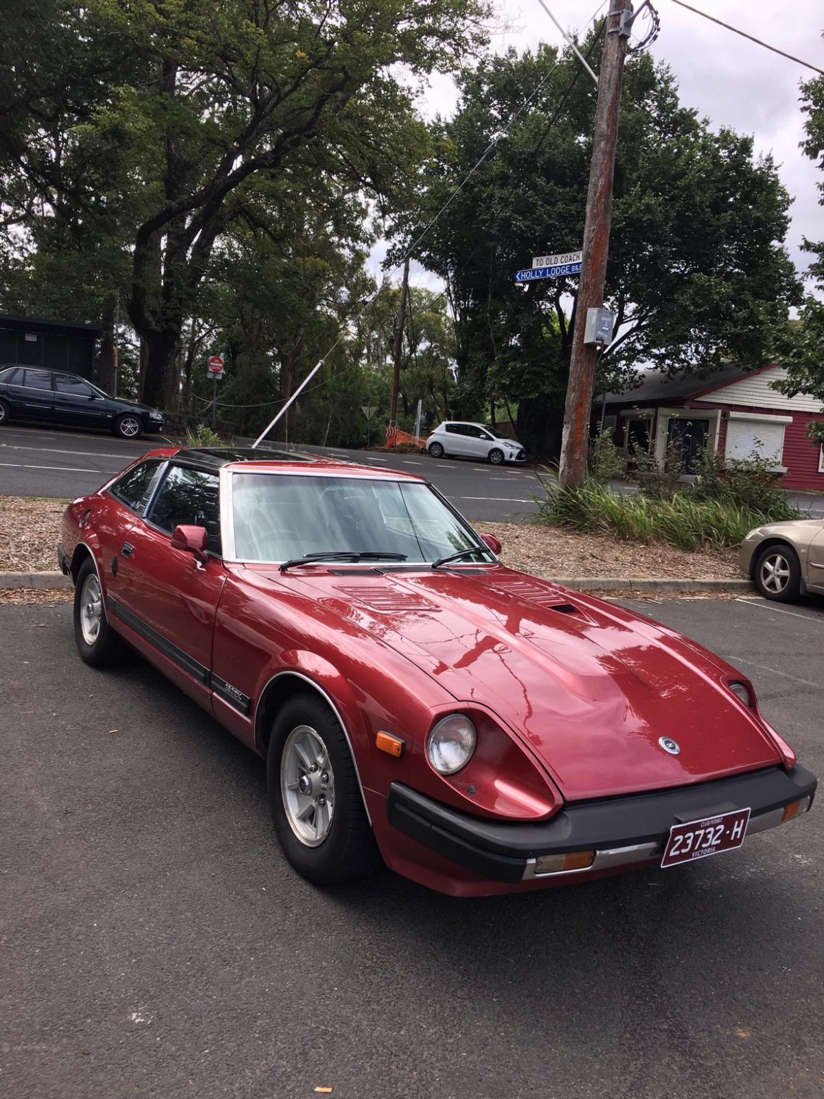

Hey all,

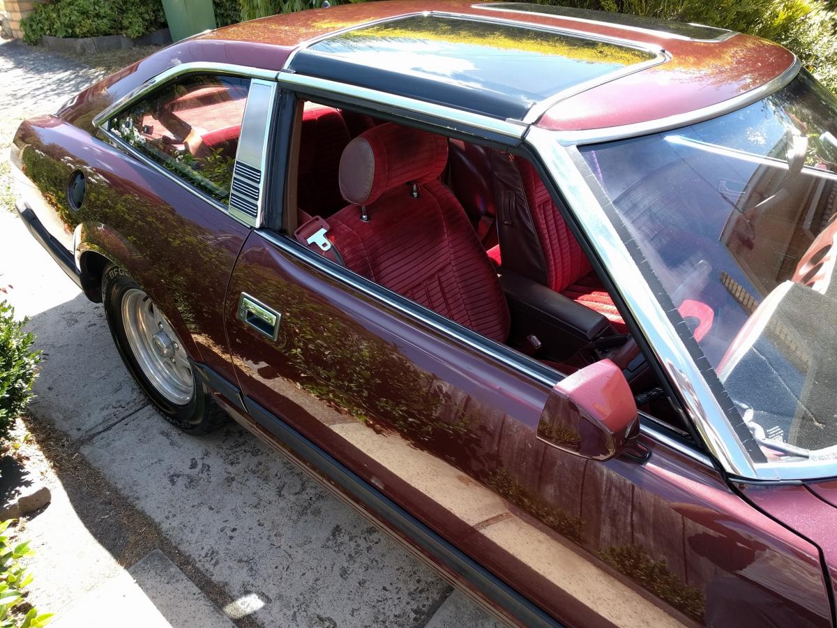

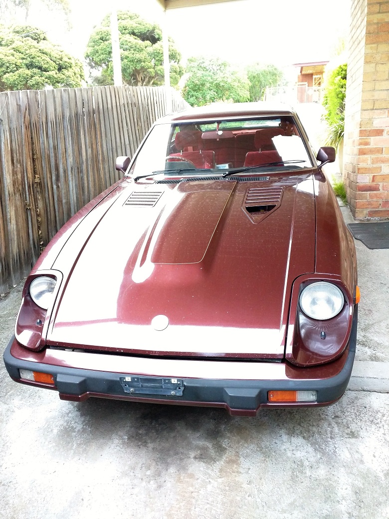

Picked up a 280ZX last week. My mate found one in a garage a couple months ago and I really liked the look of it, so I had to get one myself.
Very minimal rust in only 2 spots, but when I have it resprayed it will be repaired with minimal effort required.
Drives well,shocks and bushes were replaced by previous owner.
Engine runs, but cold start valve is leaking so I've got a new one on the way.
All electrics work even the motorised antenna.
Anyway, here's a few photo's I managed to get before the sun went down, hopefully on the weekend i'll be able to have a bit more fun cleaning it up.

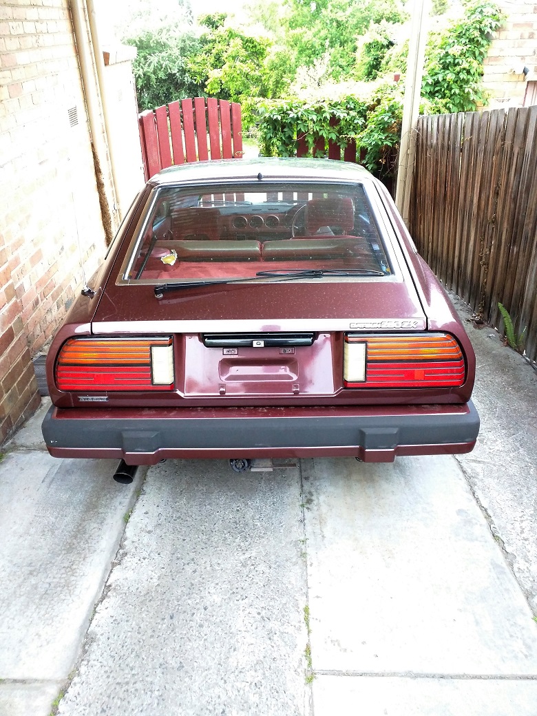

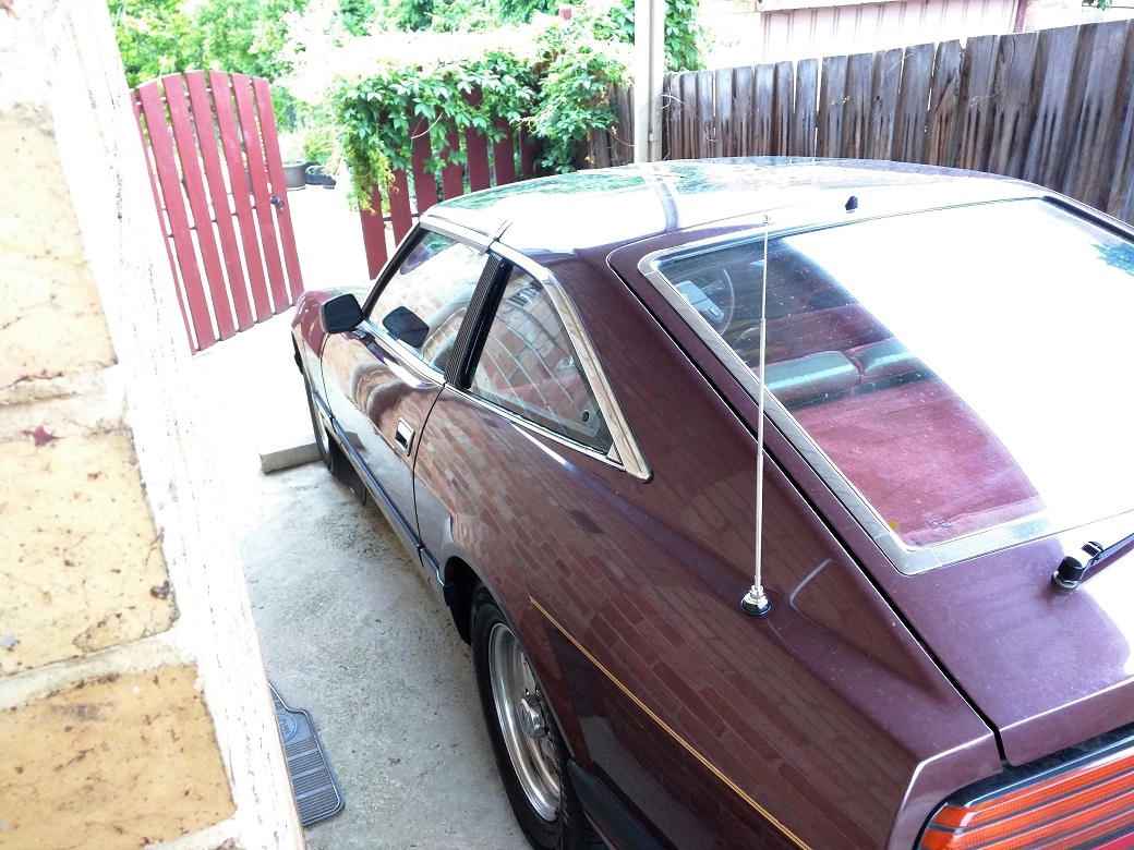

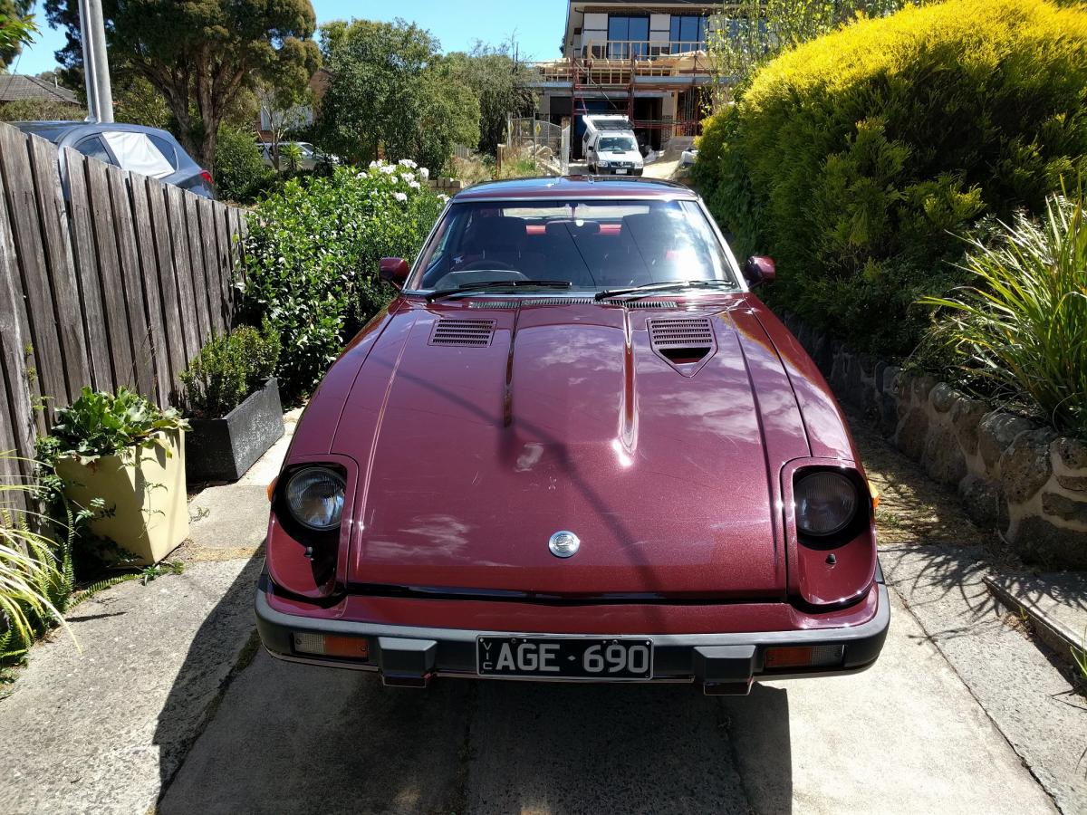

Just thought I'd add, registered the car on Tuesday. managed to get a "day time" pic.
Have a few things coming from the states to try to match the feature level they had. I'd love a set of seats but freight would out way the cost.
Did we ever have the single piece seats in Australia?

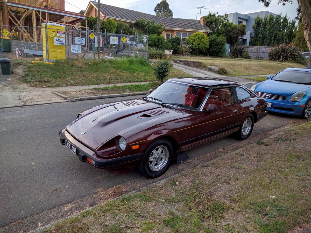

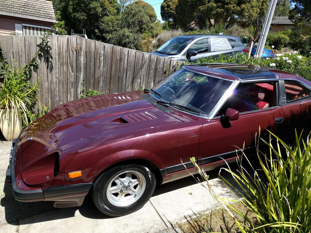

Hi All,
Thought id give everyone a little update. After owning the car for the last 4 months it hasn't missed a beat. Engine definitely feels strong and no major issues have arisen.
Only bump in the road was an accident I had last month where I was hit in the left quarter panel. Big thanks to PB260Z for supplying me a replacement indicator and I finally got the car back yesterday.

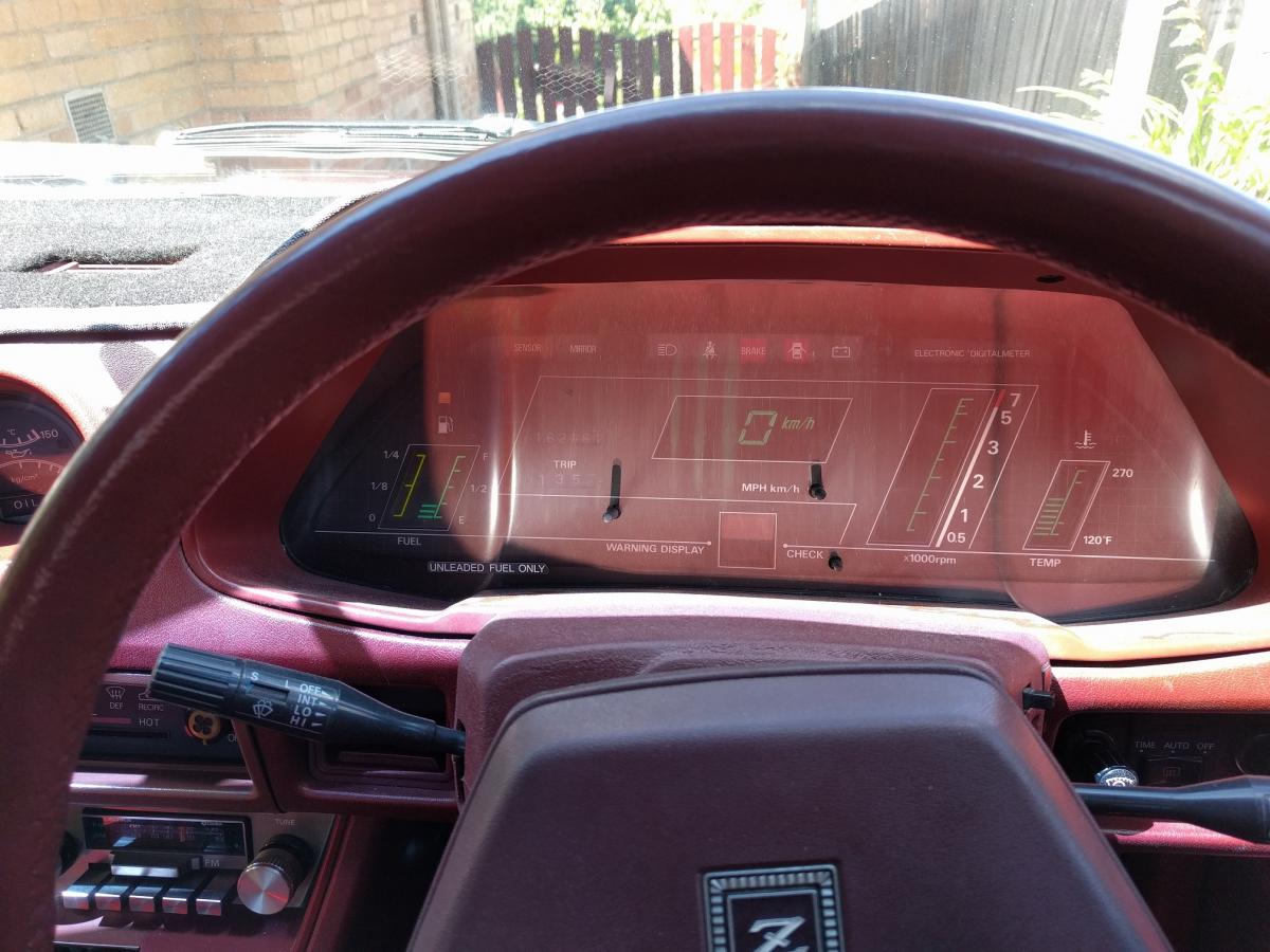

Additions I have been able to do to the car was a digital dash from the US (Don't ask, I'm a corny lover of 80's retro tech) and I replaced the plastic 82 model side pillars with the earlier chrome equivalents (I think they look better) and added an alarm so I can feel somewhat secure. I also obtained a Weber 60mm throttle body which I have yet the time to install.
My main focus now is getting megasquirt setup in motion once all the parts I need have arrived. I was originally going to get a turbo distributor and oil drive to do this, but after ordering these I realized the Megasquirt 2 I owned from my old 525i is wired up for a VR crank wheel (Expect to see these on the for sale section when they arrive :-p ). I have now purchased a Hoke Performance trigger kit and will be looking at modifying a stock dampener so I am able to retain power steering and A/C. I also have purchased a replacement fuel rail to tidy up the factory trombone mess that it is.
I am not really looking to gain power from this endeavour, but my focus will be to improve the overall efficiency of the car and modernise it a little.

Love the 80's digital dash ! Was it hard to hook up or just plug and play ?
PB
#10 manya3084
manya3084
  • 53 posts
  • Location:Melbourne
Posted 21 February 2016 - 10:11 AM
I ended up taking the lazy way out and used a loom from the US. Plug and play, only thing I also needed to get was a new temp gauge sensor (Digital specific). The fuel gauge also only lights up on the right side as you need a digital dash specific unit as well, but I don't really need the 1/4 - 1/8 part.
I haven't had a chance to extend the wires to rehook the center guages and glovebox light.

Also will add that you will constantly have to press the speed unit button every time you start the car to get it into km's. But next time I remove the dash I'm going to close the circuit for the button which should keep it in Kmh.

That digital tacho cracks me up not being linear, 1,2,3,5,7. It's a bit knight rider.
Do you feel like the Hoff? :)

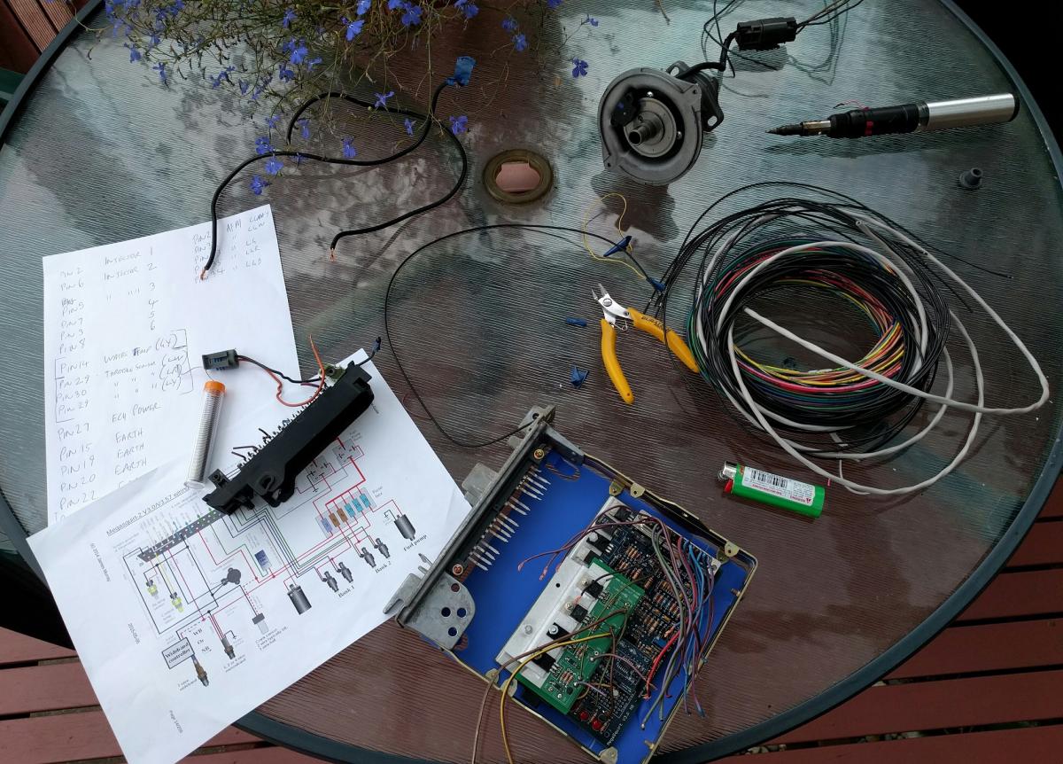

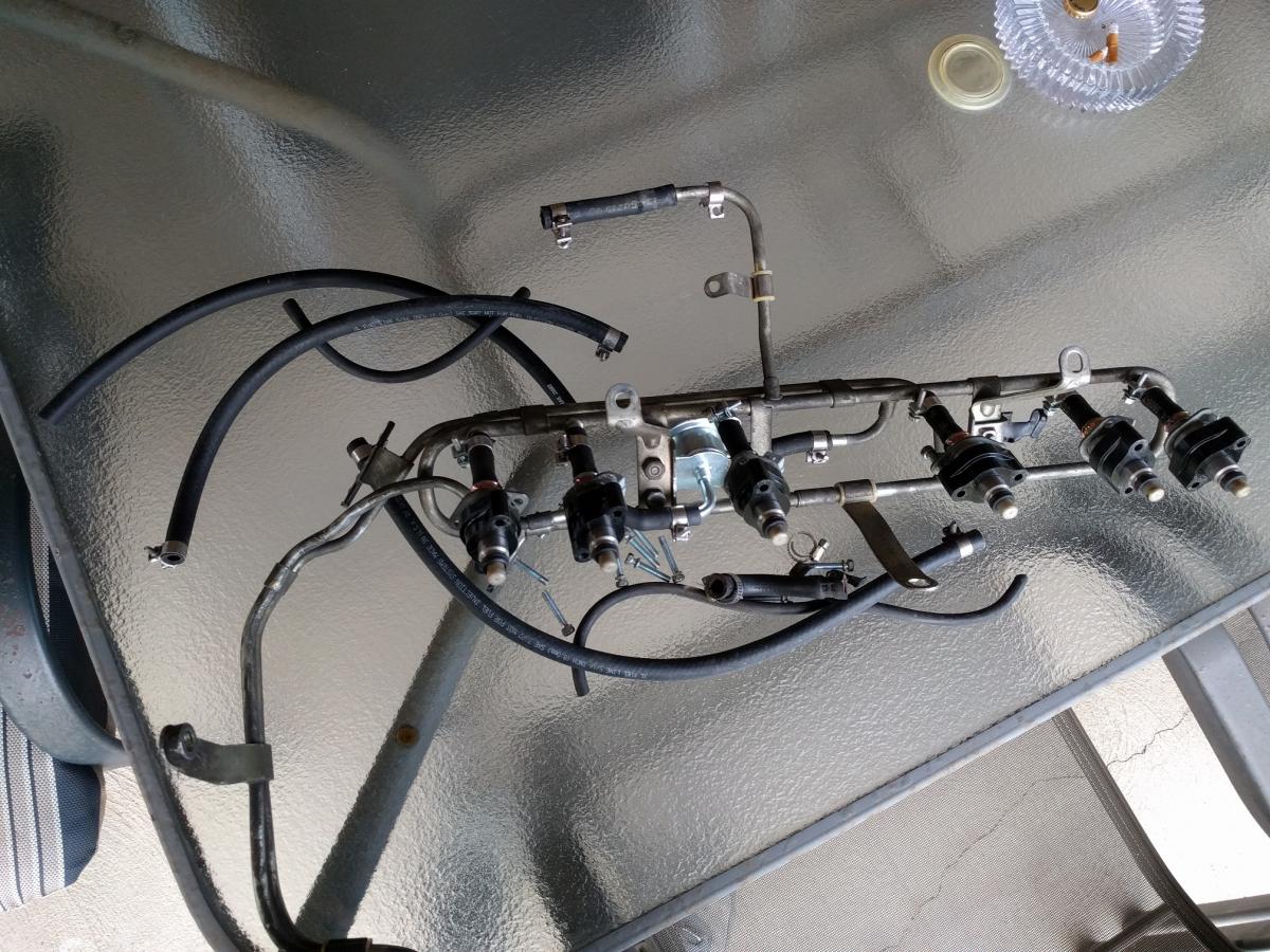

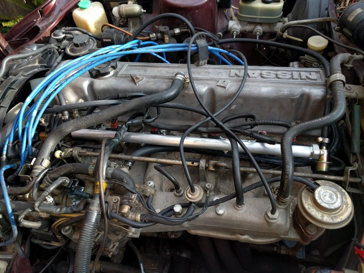

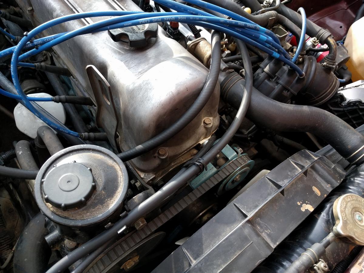

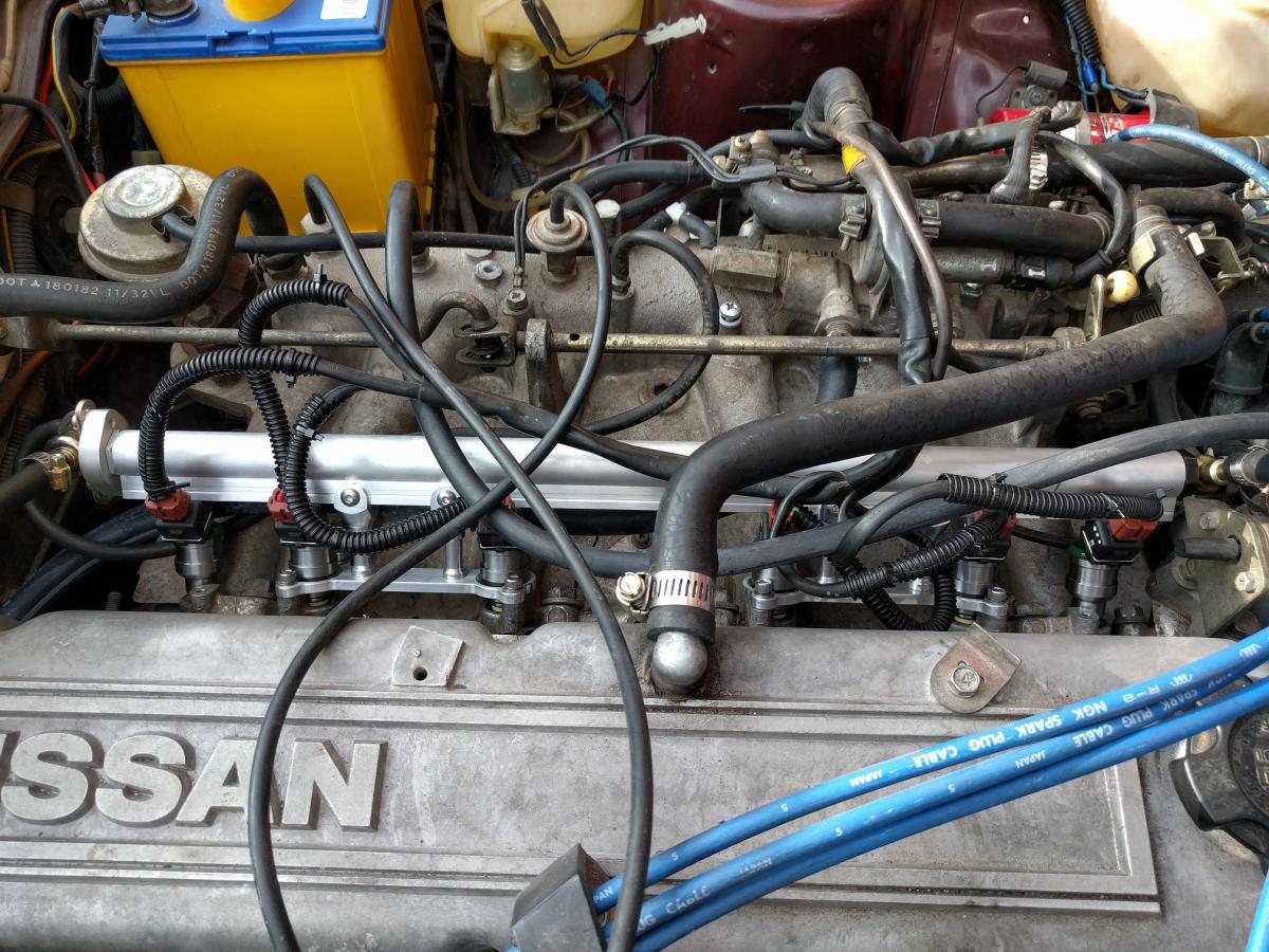

Well, bit of progress, managed to finally gather all the bits I needed to replace the fuel rail with a much cleaner looking one. Also I have replaced the injectors with some EV1 style 210cc low impedance bosch injectors (Some porsche apparently used these, hard to find low impedance low cc injectors). I'm going adjust the AFM a little to lean the mixture as it's running richer when you plant your foot down.
Just need to go to jaycar tomorrow to grab a few more bits so I can begin to wire up the megasquirt.
Here's some unflattering pictures of the work so far. I also removed that silly metal coolant line that goes across the front of the engine cover to the idle control valve. This will be removed once I install the megasquirt as I will be using an ICV out of a volvo. Also the throttle body i will be using does not require coolant to run through it.

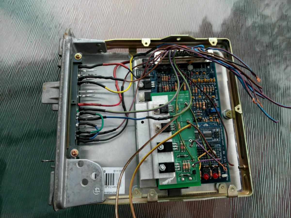

Wiring is getting there. Hoping to install it this weekend, just need to get an oxygen senor bung plug welded to the exhust which im hopping my mate can help me with.
I tested the turbo distributor using a drill while hooked up to the PC and tunner studio seemed to display the RPM just fine. I may use this temporary setup while I figure out a solution on how to mount a vr sensor and the trigger wheel. It will make for a cleaner install if I can successfully go this route and remove the dizzy all together :-)

That new fuel rail looks so much neater than the original one.
Keep the photo's coming.
