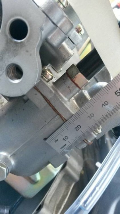

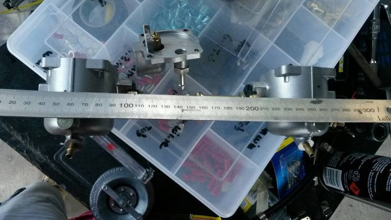

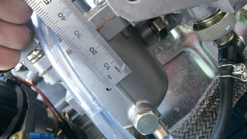

Posted 15 October 2015 - 08:32 PM
front
rear

It looks like u may be having similar issues to me. If the car is dieing when you put the unisyn on the rear carb, then it is too rich (less air flow more fuel, flooding). Looking at your float levels, the rear is quite a bit higher than the front, also indicating flooding (fuel sitting in the jet too high). Try unscrewing the rear richness a bit.
That last clip of the float thingy (very correct term...) could be the issue too though.
