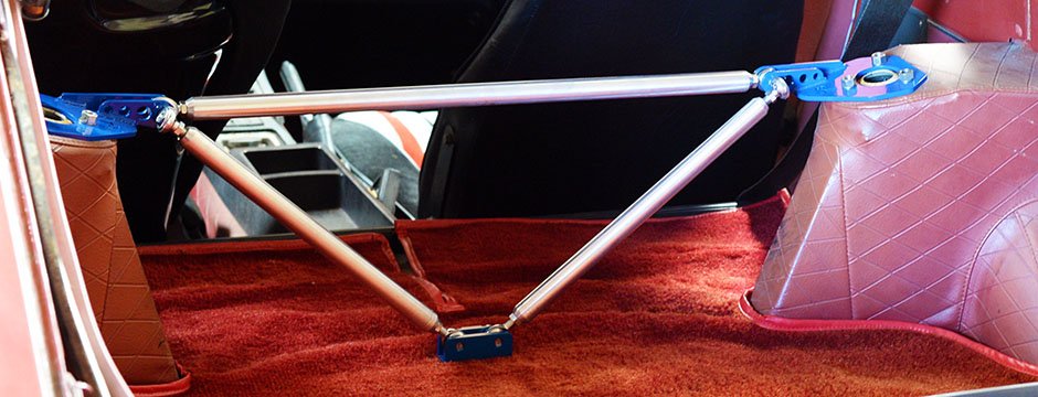

Gents,
I am looking to get a rear tri bar strut brace. Like this one:
Trouble is, I have a 2+2 ‘Racing bus’ 260z (1977).
No one specifically makes race parts for these, which is in itself a travesty since the 2+2 was designed for the true zed racer, one who needs to bring his pit crew with him to meets!
Anyway, can anyone make comments as to:
  • Is the shape of the rear strut top where the brace connects the same in a 2+2 as for a normal late model 260z/280z?
  • Is the distance between them the same?
  • Are they the same height from the boot floor?
It would be great to get some definitive answers to this as I’m sure there are other bus drivers out there wondering!
I have tried searching but it is difficult to narrow results down to include '2+2' as there are '2's on nearly every page!
Thanks fellas – your counsel is always appreciated!

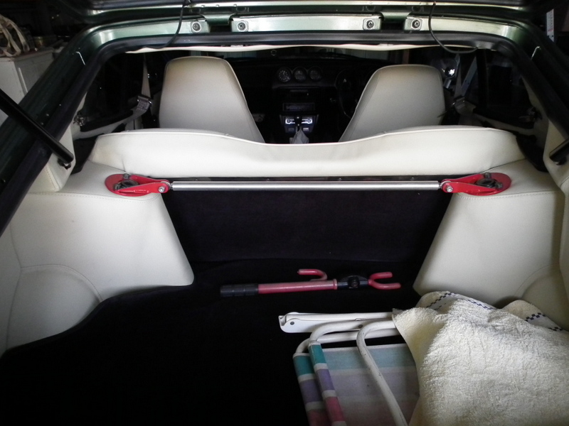

You can use a adjustable brace for a Late model 2 seater 260z (with higher strut towers). Not sure if the tri-bar will work though

I emailed T3 and they said they weren't sure if it would fit, but they emailed me a diagram with measurements for me to fill in. I aim to do this tonight with the help of a measuring stick and some beers.
So what I understand from these replies so far is that:
The bolt pattern is most likely the same
The distance between the struts is likely the same as any late 260z
The struts themselves are taller than a 240 (so I'd need longer 'tri' bars).
This being the case, the top part should fit.
And if the bottom 'tri-bar' parts don't fit, Matty will buy them off me :-)
Good so far?

So the top bar will fit, and it seems the tri bars MAY fit however from what is being said is sounds like I will need longer tri-bars than would suit a 240z, on account of the strut towers being taller.
Peter, do you have the T3 branded strut brace?
If so, would you mind taking a measurement from the center of the mounting hole to the center of the floor (as per the pic at the top) so that I can tell T3 to just make me some bars that size? (sorry Matty!).
Also, does anyone know how the bottom bracket (the blue bit) attaches to the floor? I'd check myself but don't have access to my Z at the moment.
I assume if there are some holes already there on a 240z it would be unlikely I'd have the same ones on my 2+2 and I'll probably have to drill them myself. Anyone know?
Thanks again all for your contributions, can't wait to post some pics of everything installed!

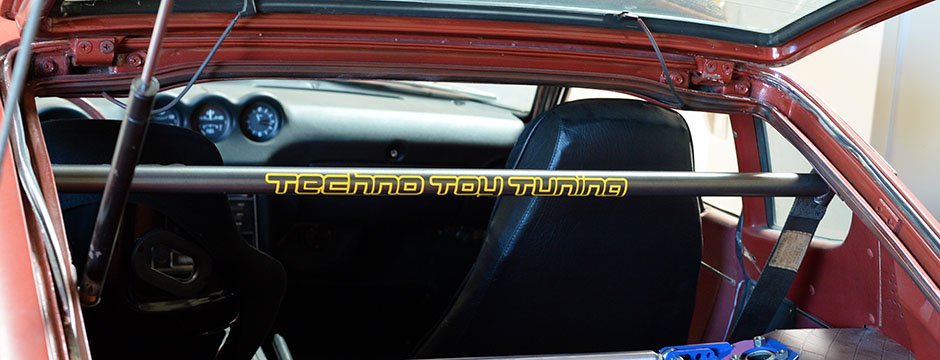

Oh, and has anyone used the T3 C Pillar Support as per this pic and link and any ideas if a 2+2 has the same mounts?
https://technotoytun.../z-c-pillar-bar

I have the C pilar brace too bud, i would have a felling it wouldnt fit given the shape of the roofline and the mounting points for the seat belts (it was a  BIG pain in the A$$ to fit by your self too) but if you need any measurements of the C pillar bar its self i can help out.
as for the tri bar it  gets fixed to the floor. as i know i cant find ant pre-existing mounting holes. i assume they would supply you with a few stainless bolts to mount it to the floor after you have drilled a few holes in the floor now that is

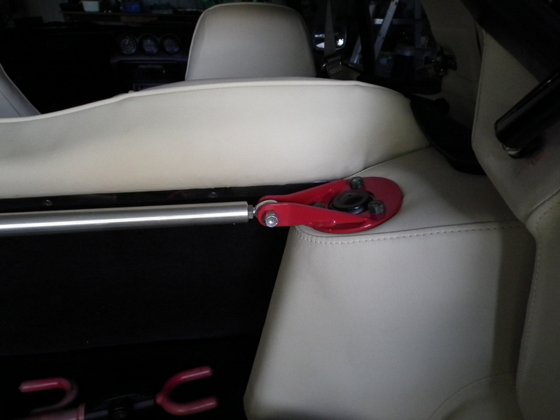

Lee mines a TTT and as you can see the mounts are different to the tri brace so where to measure. As far as the floor goes just drill. Not sure what the pillar brace would do to the overall scheme of things but really cant see any advantage of it.
Peter.

yours appears to be a older version Peter. as the style i have are the blue ones and they look like a longer finger off the plate from the strut top? i could be wrong but i though it might be worth a mention.
