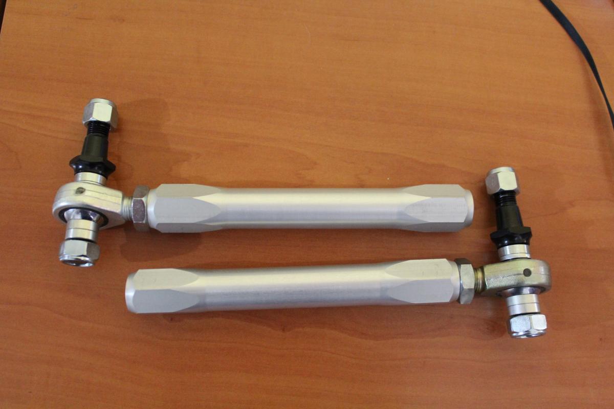

I bought the nagisa auto ones from Japan http://www.nagisa-au...0_s30_130z.html although I still haven't fitted them to my car yet  ::)

I've seen them as well Mossy, but they are over $523 AUD at today's exchange rate, whereas the T3 ones are only $196 AUD at today's rate.
If anyone has a set for around the $200 mark I will buy them cause the car is booked in the shop in 2 weeks, and the T3 ones wont get here in time!
I'll be taking it to the shop in 2 weeks anyway to have all the other adjustable bits - just trying to avoid taking it for a second time when I get the adj outer tie rods.
