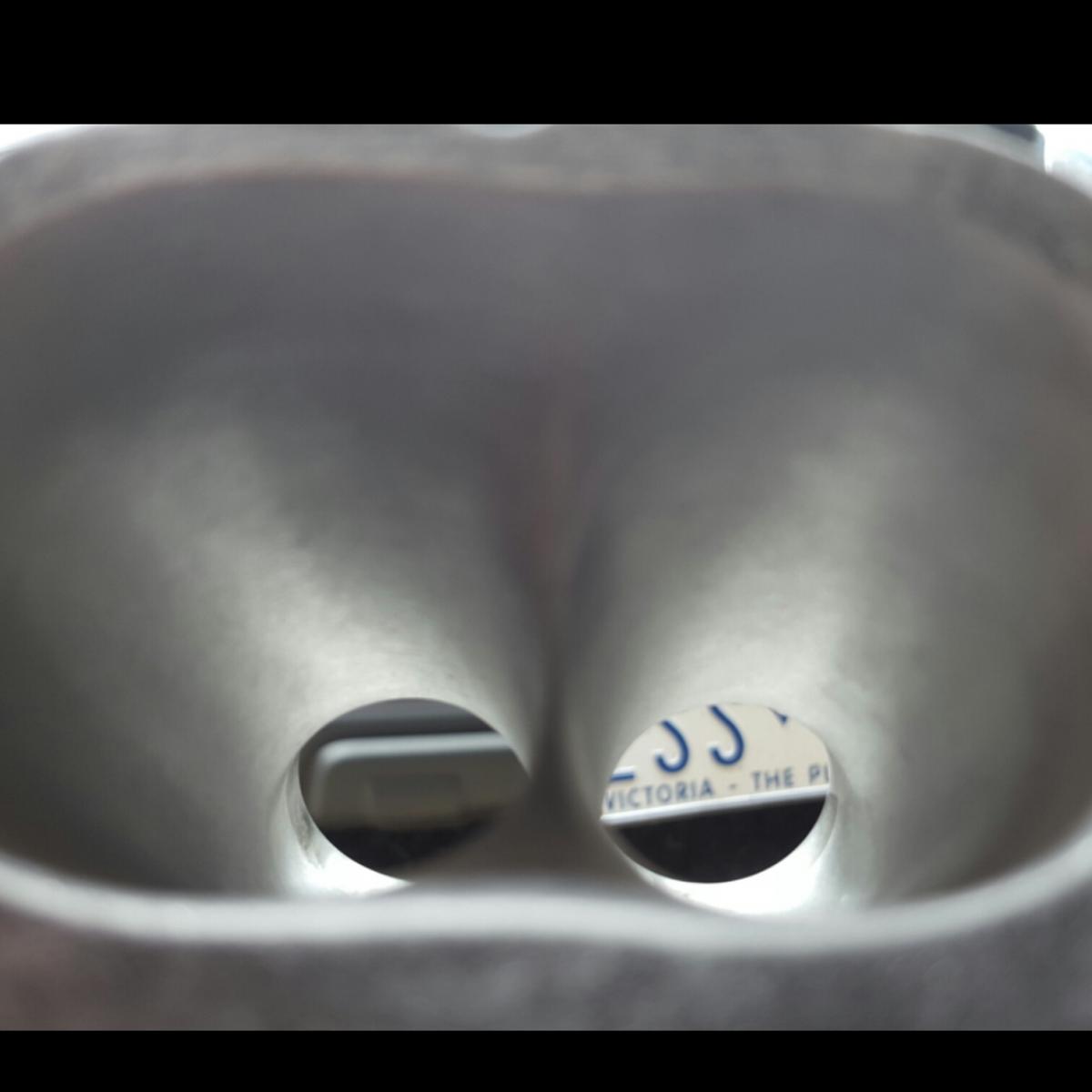

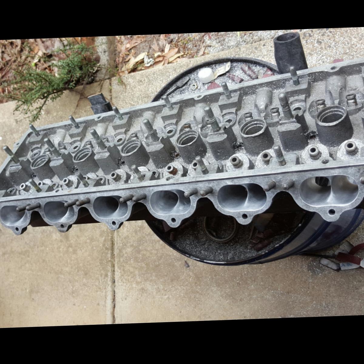

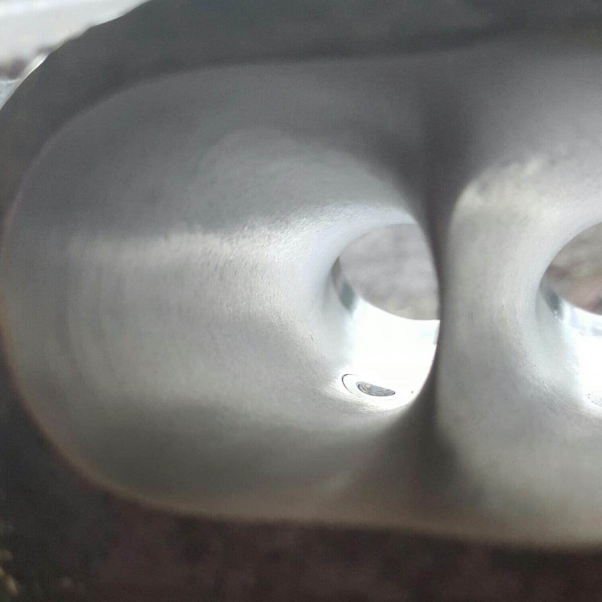

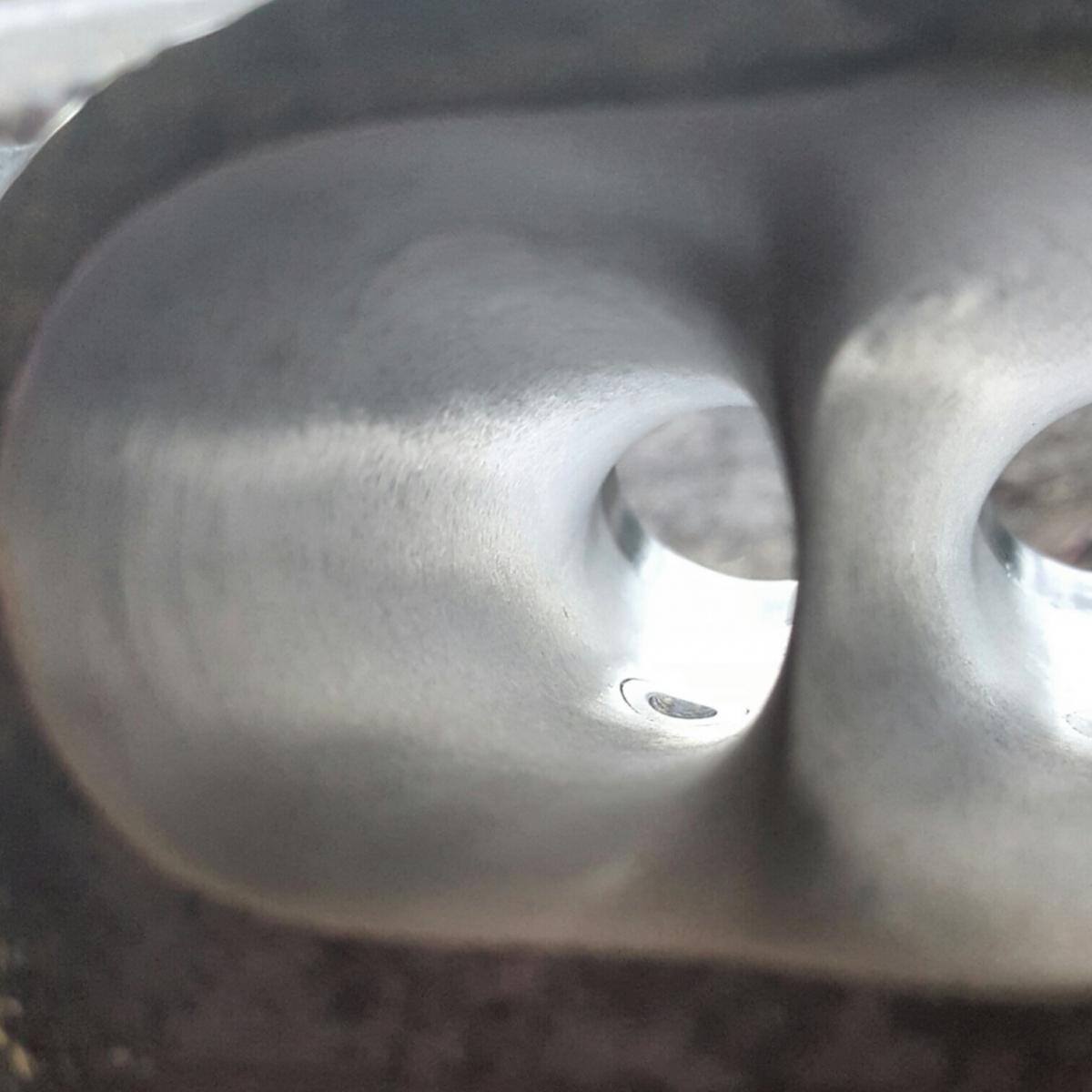

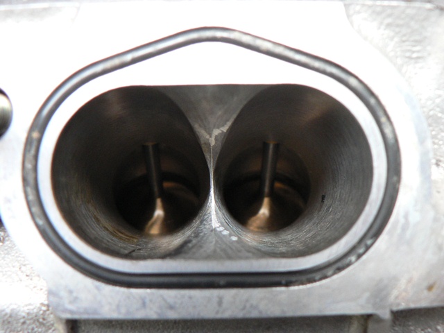

Ports are looking very nice now its taking some time to get something that works on such a big engine. .

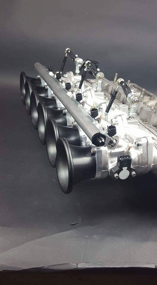

Lots getting done block prep work is well on the way . And ports are looking fantastic. Port flow is at 305 cfm through the intake. Steve at efi hardware is making a custom made set of itb for me .they are great to deal with .and clive cams are building a set of custom made billets for the new now very high flowing head ..its going to be very special

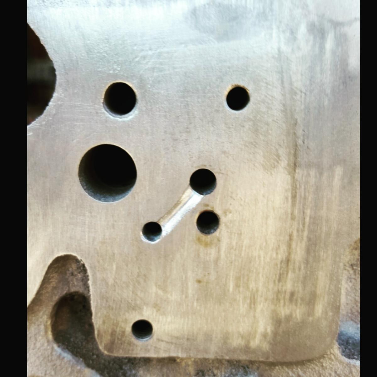

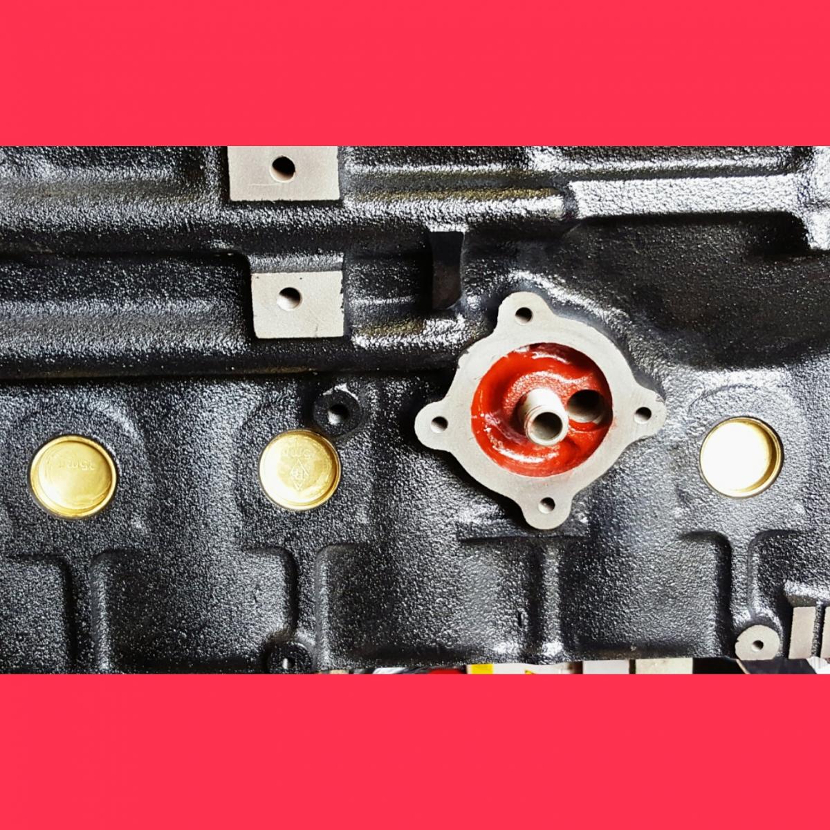

305 cfm and the right x section for 8500 on the 3.35 makes 460hp ..thats crazy hp if i get to 450 its just going to blow my mind ..im loving the build ..lots of mods to the block oil feeds for exhaust cam .and water ways .its a bit of a challenge.

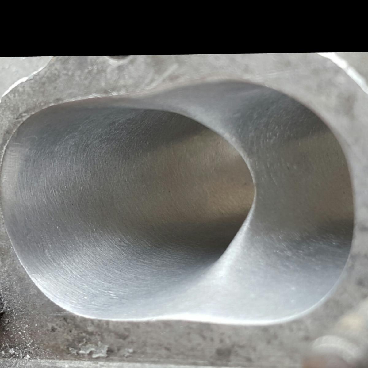

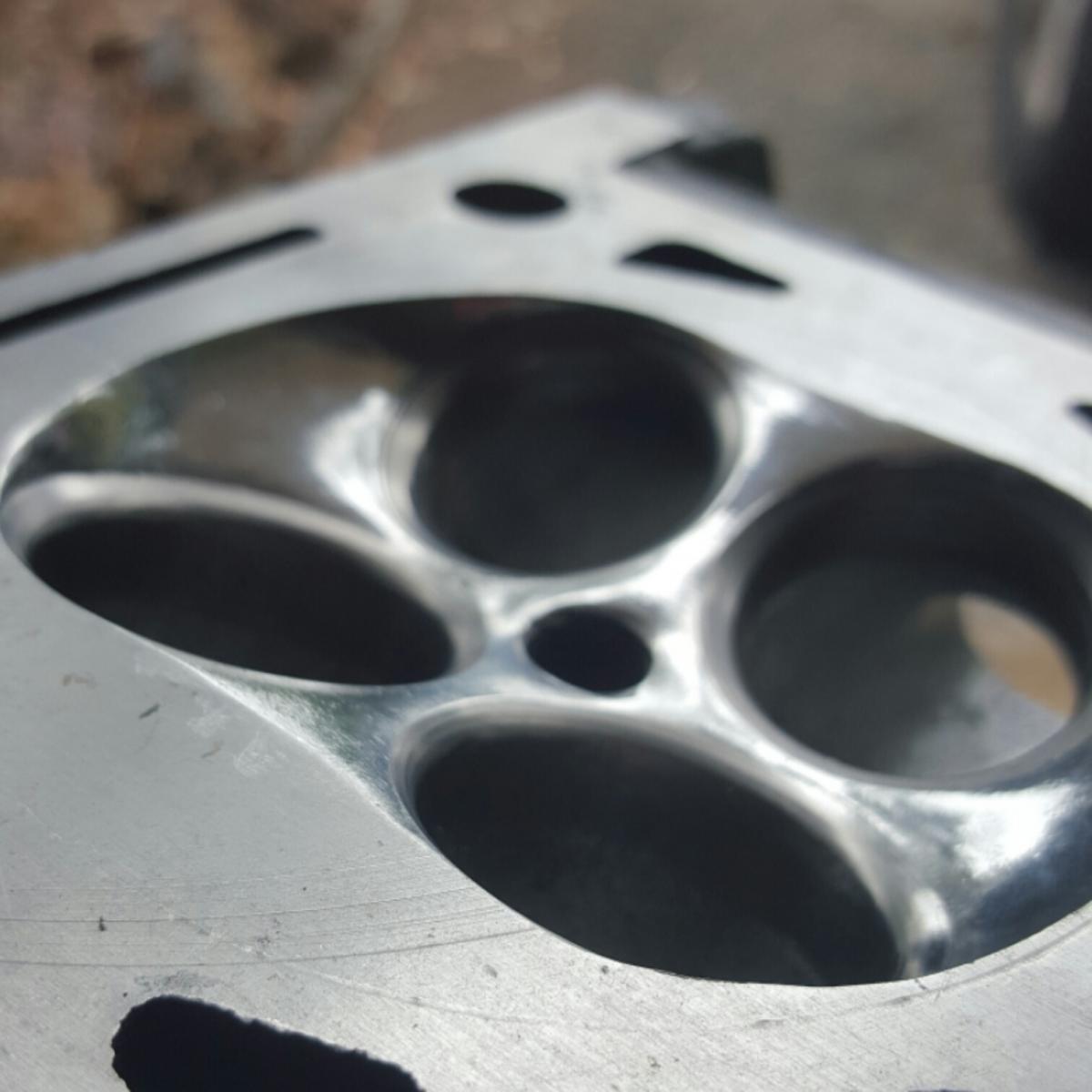

Getting there all ports done and flow tested average hp is 455 .very happy with the results its looking great .just need a bit of chamber work and then it can be waterjet blasted ..

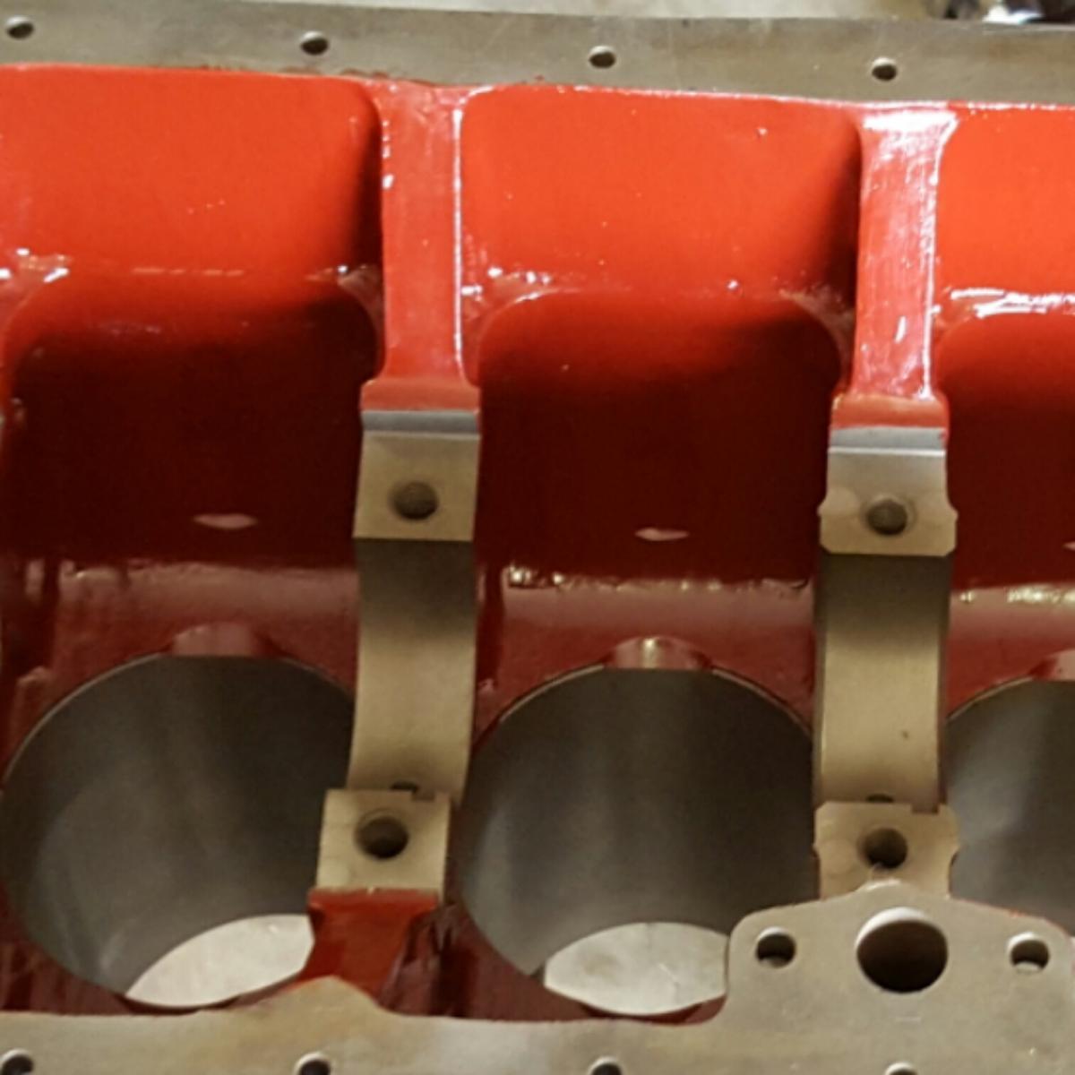

Bit more progress today on the block all painted up .and concrete in. few weeks then of to get some bores done

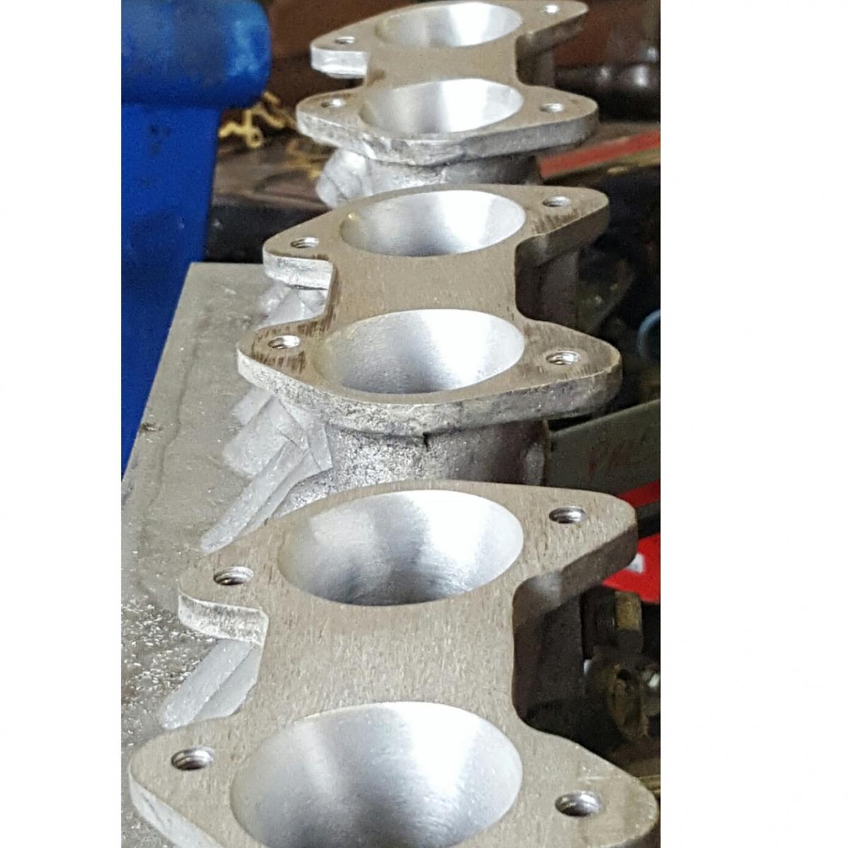

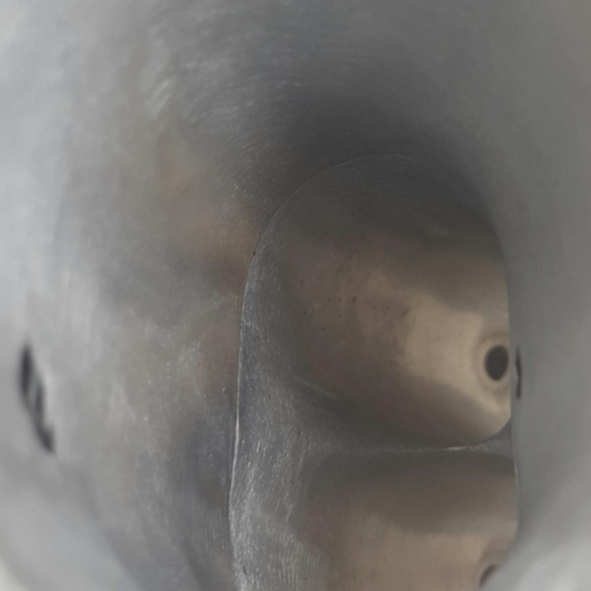

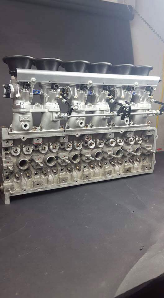

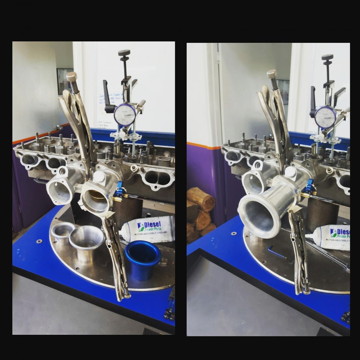

So now all the ports are done i had steve at EFI hardware do a dummy tb to do some tests.steve made up a 55mm itb with a tapper down to 52mm .the aim of my test was to see how well the tb would perform on the os head would it drop much ..what bell and shape would flow best .and how much did the thratal shaft and blade hurt flow ..these tests are hard to work out some times and most times you walk away not knowing what to do .
But in this case i got a few good ideas on what the tb liked in the bell shape and which way the shaft needed to be set up.and how long the manifold wanted to be to flow the same hp as the head ..the last test of the day i removed the shaft and butterfly. To my surprise it only picked up 2 cfm 301cfm from 299cfm.all going well 445 to 450hp is on the cards at 8500

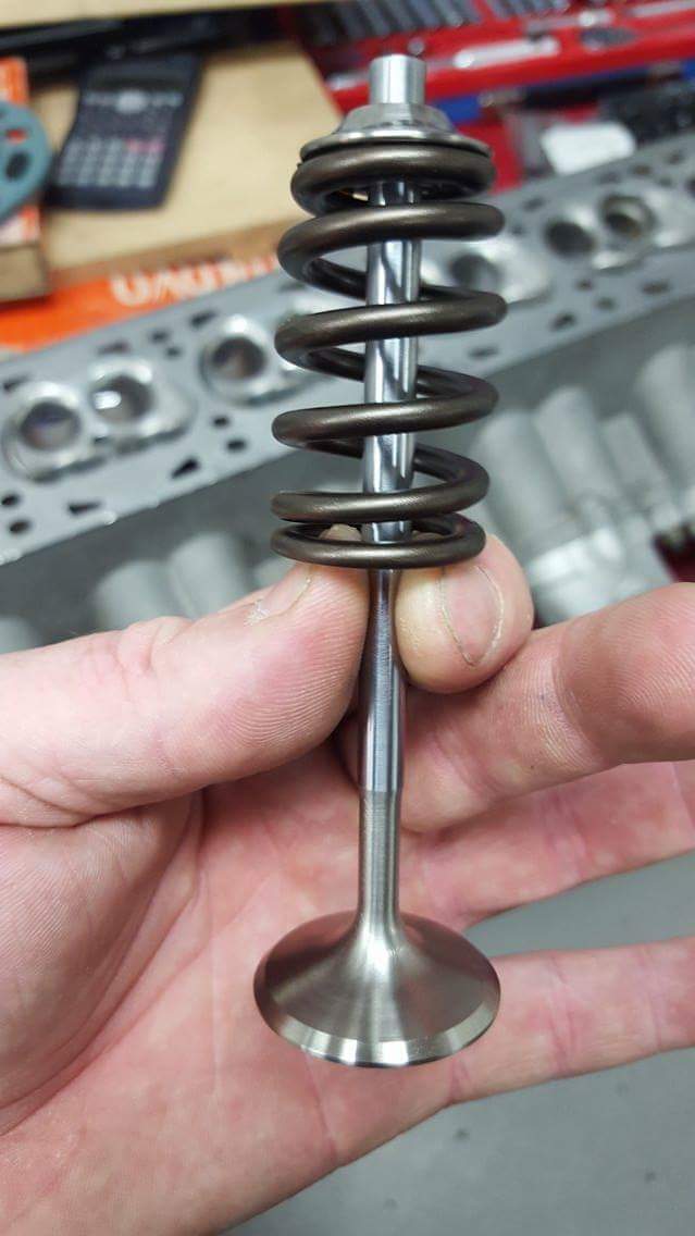

After much math and asking smarter people than myself 1.5mm had to come out from all the ports and 3mm from the inlet manifolds. 6 hours more .312 cfm 12mm lift honda port numbers
